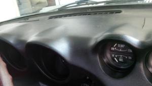

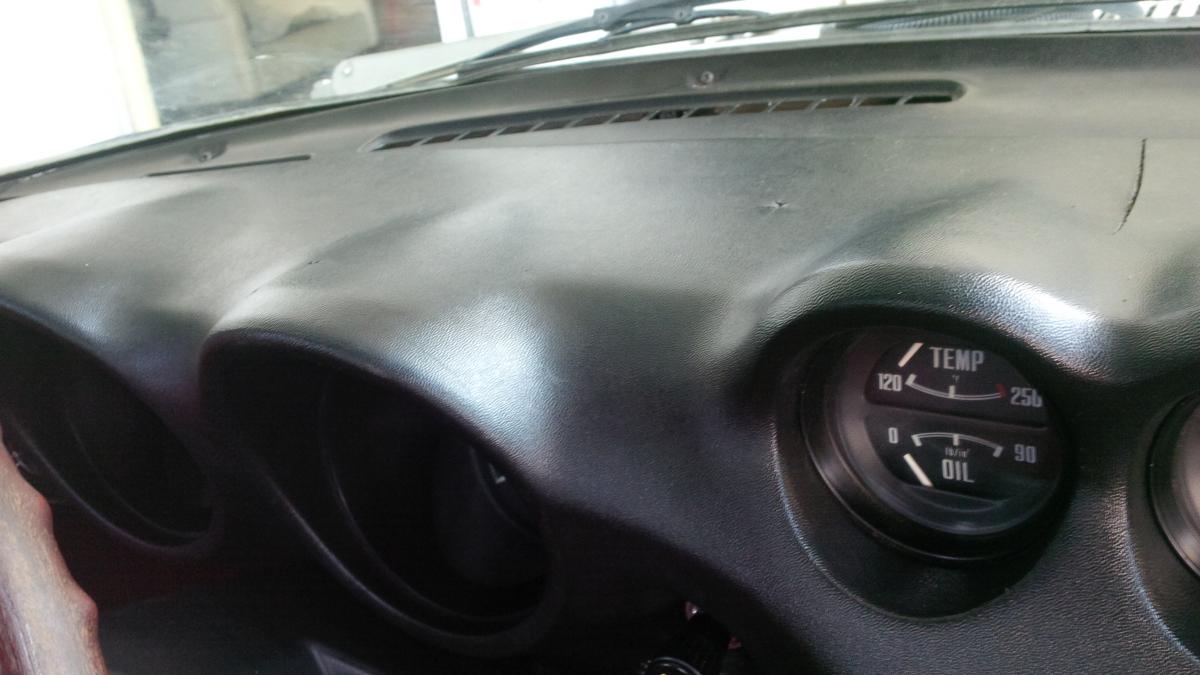

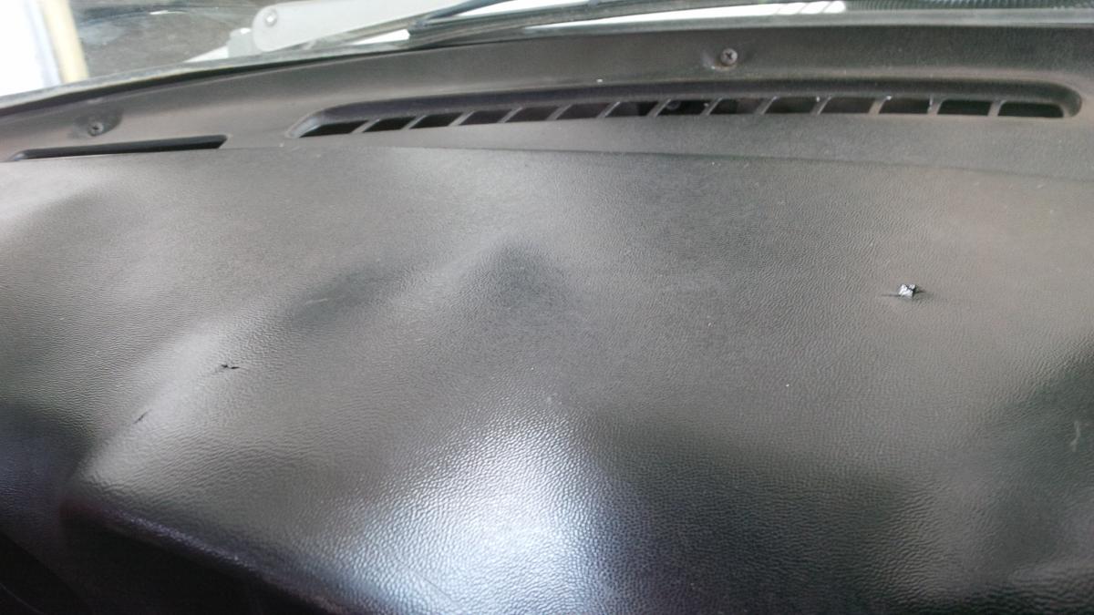

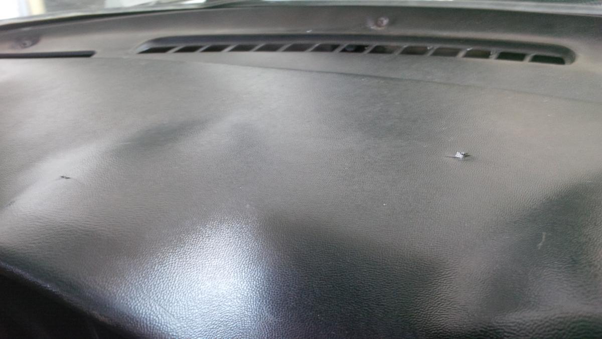

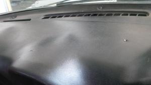

Went to check my AC installation today at the shop and found out the guys dented/ Punctured the upper side of the dashboard. They told me not to worry cause they would put some epoxy and when dried spray it with black. I do not think this is the solution. They should have been really carefull when pulling the dashboard out before installing the Evaporator Kit. Is there any posible way of fixing this dents and cracks or should i just purchase a whole NOS dashboard?

Was the crack to the right of the small puncture there earlier???? If so why are you worried about the tiny screw puncture? As for a NOS dash, good luck with that, they are pushing $2000 and they are 40 years old if you can find one.By the time you ship it to Panama it won't be undamaged any more. Lastly I wouldn't let any mechanics shop that isn't smart enough not to run screws up through the top of my dash, repair it for me!!!

Looking at the puncture mark on your dash -- along with the 3" crack that was already there and apparently wasn't bothering you much before the puncture mark occurred -- I think that the epoxy-and-paint suggestion may not be all that bad a solution.  If there is more than just this one crack in your dash (and I'll bet there are), I'm even more inclined to suggest that a spot repair makes sense.  If you want to try something a little 'better', Eastwood Tools (www.eastwood.com) offers a leather-and-vinyl repair kit that permits taking a small mold of the texture of undamaged surface and then applying it to the repair compound so that the repaired area blends in with the rest of the surface.  That sounds easier said than done, though.  You'd probably want to practice with it on some other textured-vinyl surface first, before you commit to trying it on your Z's dash.

Thanks for your kind advice!! You are right, i am not a do it yourself man and since i dont live in the US where i can get these parts easier, i prefer the www.eastwood.com solution! Its just three spots that have been punctured and the 3 inches long crack that was there before these people were handed the car for AC installation. I am not interested in the full cap!! Want to keep it original!
What will be the eastwood procedure? ANyone has done this repair before?
