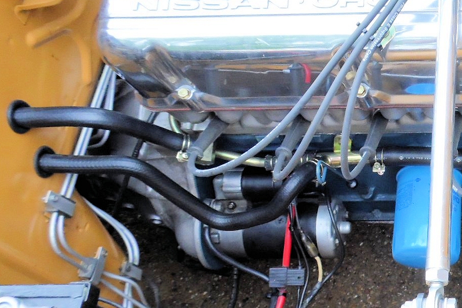

Hi all,  I noticed recently that there are several variations on the heater hose configuration where they exit the firewall.  My 72 ( 06/72 build) is set up differently than others I have seen.  See pic.  As you can see the upper hose exits and runs the full length of the motor. The short lower hose runs to the engine block/head.
Most of the others attach to a 3 way connector at the lower hose entry point.  Both the upper and lower feed into it at that point.
As you can see, there is no exit fitting on the lower hose on my engine.  Can anyone chime in and let me know if this was a factory variation on some engines or a modification made by the PO.  My water temp has always been normal even sitting in traffic with the a/c running.
I did not realize this until recently when I went to replace the hoses with original braided ones and they did not match up.
Should I leave it alone or renconfigure.
Thanks
M240Z
Thanks Site, I have done a little research on this topic and it appears that there are many comments and opinions addressing this issue. A lot have to do with variations of the temperatures at different points on the head.  Hotter in the back vs cooler in the front.  Lots of opinions.  I just recently completed a full engine- transmission out rebuild at 130K miles.
I increased the bore 83.75, installed Silvolite pistons and circle high performance rings, put in a slightly aggressive cam, port-polished the E 88 head, also balanced - ground the crank, had Z therapy redo my SU's and completely redone ( upgraded)  the entire a/c system. I also replaced the entire exhaust system with a NOS Abarth free-flow model I found from a supplier who attended Z con in Memphis.
Just completed the break-in period so have not run the engine hard, just the normal rpm variations.
I am going to dyno the engine to see how much hp was gained ( if any) and will check head temps at various points.  This should answer some questions.

Thanks for the pic Jim. I will use it as a guide should it become necessary to revert.
I am going to do the dyno first and run a laser temp sensor on each cylinder to check out the temp. range.   I will let everyone know the results.
