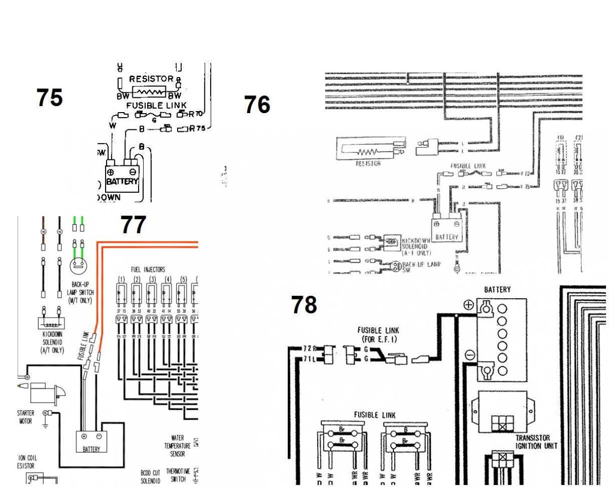

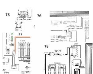

1. Buy a decent inline fuel pressure gauge and install it under the hood. That is how you check fuel pressure. Make sure you get one that will go up to at least 60 PSI.
2. There is a fusible link for the EFI. It is separate from the other fusible links. You need to check that. It wouldn't hurt to check the other links, too. Use an ohmmeter to check. Visible inspection is not adequate.

ALWAYS put the year of your car in your posts or your signature. There are variations in the 280Zs.

Did you replace all 5 fusible links? There are four under the covers and one for the EFI.
