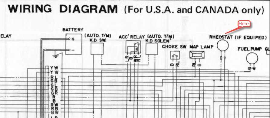

72 240z. is there a dimmer for the instrument lighting or am i missing something? i am not seeing one on the schematics either.
thanks all   sb
https://www.classiczcars.com/forums/topic/52758-dimmer-question/
It's on the wiring diagram at the top, near the right corner. Up by the fuel pump.
And one interesting tidbit... On the USA and Canada diagram, it does ay RHEOSTAT (IF EQUIPPED), so I don't know if it's really the case or not, the implication is that maybe not all cars got one?

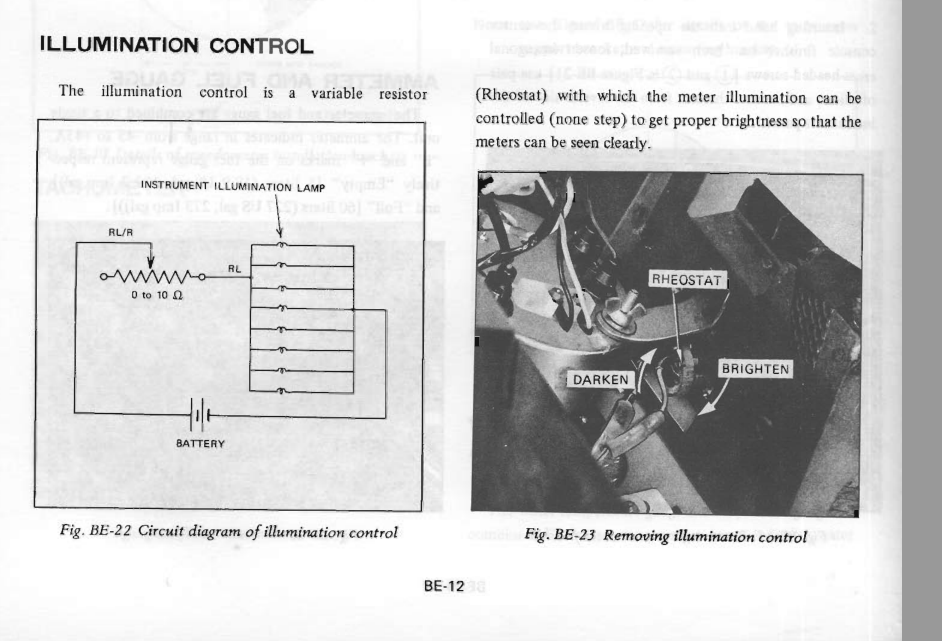

FYI,  If you wish to replace the rheostat with something better  (a modern electronic control)  there is a recent topic discussing that.  It uses a PWM to control the light and you can use it with either incandescent or LED bulbs.
thank you all. i dont quite know if some p.o. took the reostat out, or there ever was one. i found the spot on the bottom of the dash but there isnt anything there.
How long have you owned the car? It wouldn't have been difficult for a previous owner to connect the two wires together and bypass the rheostat if it went bad.
i just bought it. i imagine a rheostat isnt too hard to find. i plan on replacing the entire wiring harness anyhow. way too many wires and connectors!
