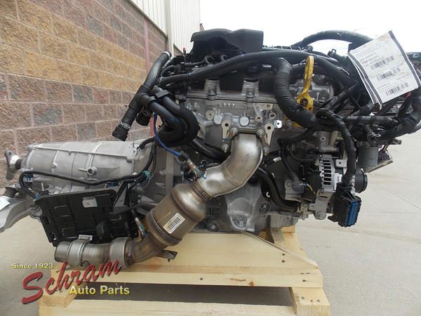

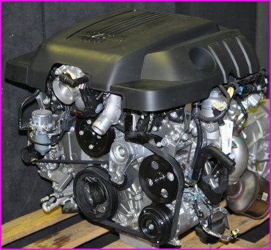

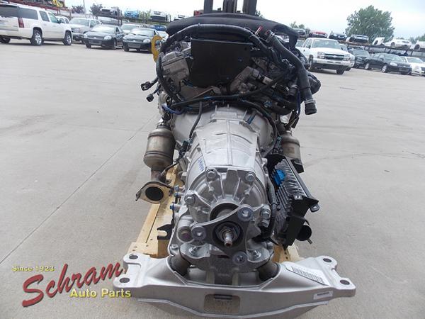

November 8, 20159 yr Author comment_480755 Thanks for the info. I believe our attorney is setting up at least one more visit to retrieve evidence before we release the vehicle. Assuming I can get there and can take measurements, what should I be looking for? Also what photos? BTW the LFX engine in the 2012 Camaro is a normally aspirated, variable valve timing, direct injected engine producing 323 HP. It only weighs 345lbs. Has an integral exhaust manifold in the heads and an integral cast oil pan. Transmission is an MYB-6L50 and weighs in at 187-198lbs. It might be interesting to double the horsepower for about the same weight and doubling the number of transmission gears. Edited November 8, 20159 yr by djwarner Link to comment https://www.classiczcars.com/forums/topic/52778-what-about-a-36l-chevy-v6-transplant/?&page=2#findComment-480755 Share on other sites More sharing options...
November 14, 20159 yr Author comment_481010 OK, I've found some interesting photos. So, if I'm keeping my numbers matching Series I intact, which year/model Z would be a could transplant recipient on a rust/cost basis? Link to comment https://www.classiczcars.com/forums/topic/52778-what-about-a-36l-chevy-v6-transplant/?&page=2#findComment-481010 Share on other sites More sharing options...
