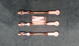

I just got new individual adjusters to get a much better carb sync. Have to wait till Spring though now.
