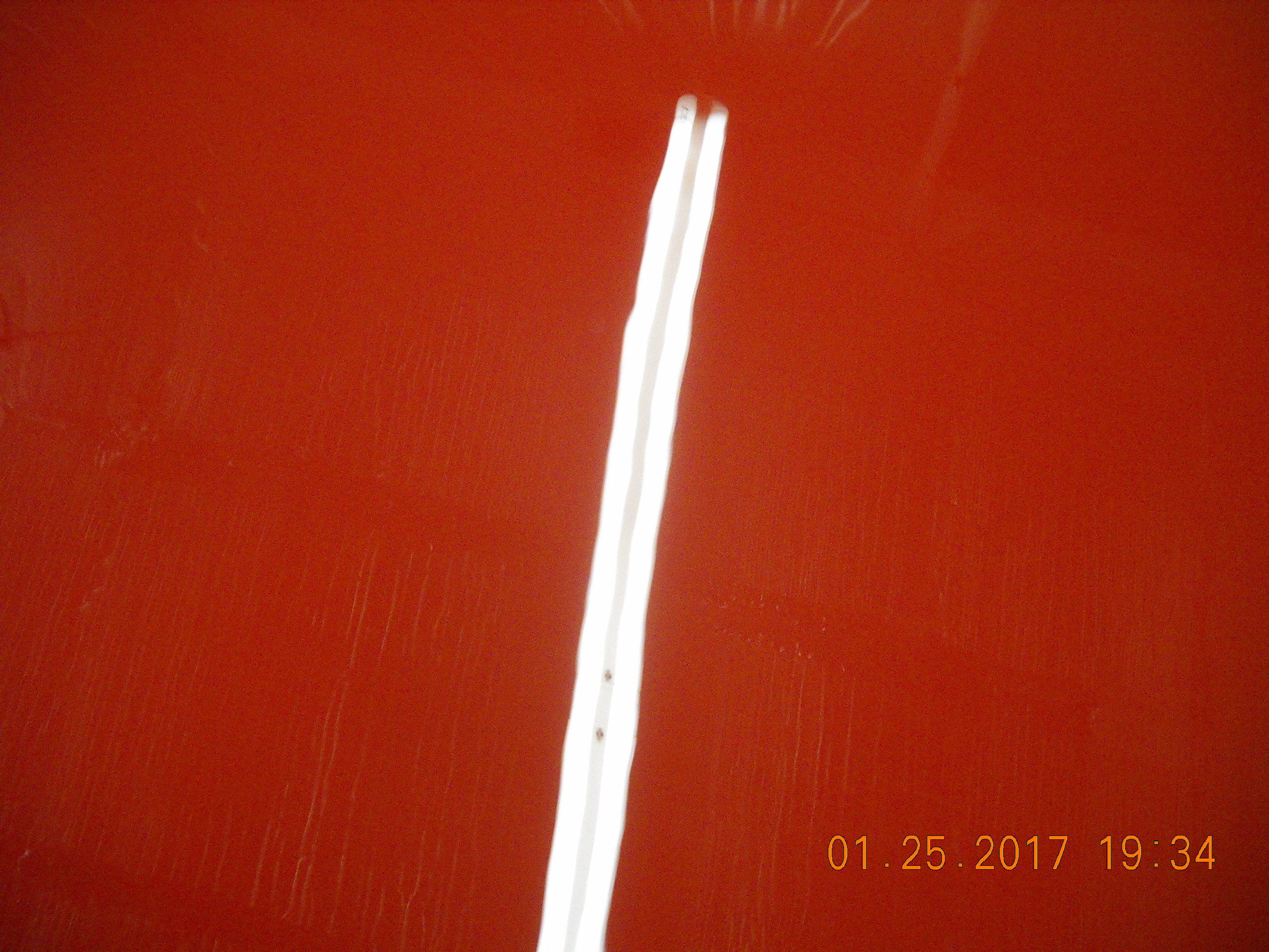

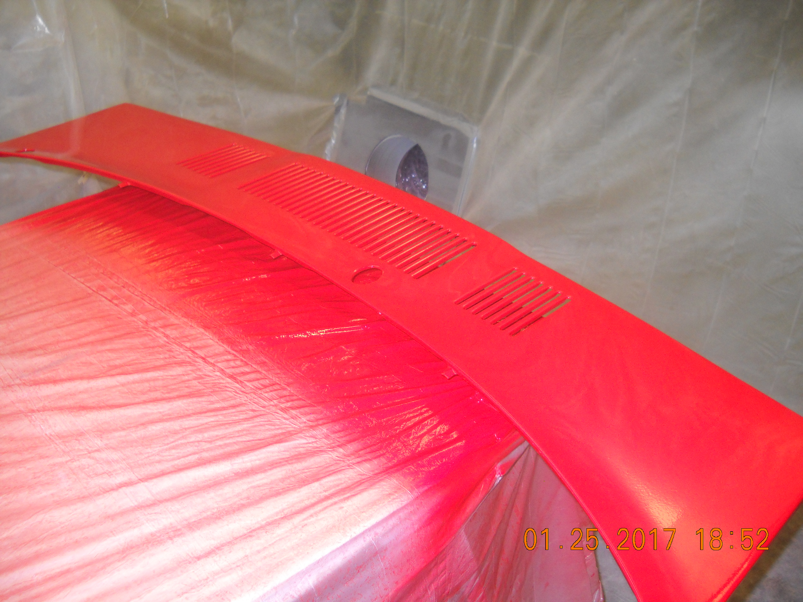

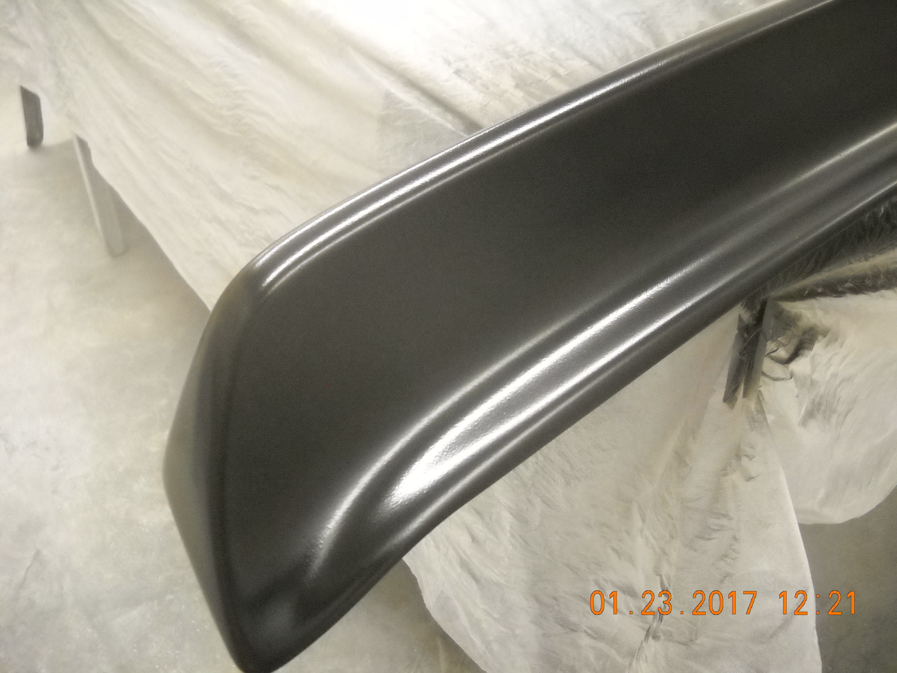

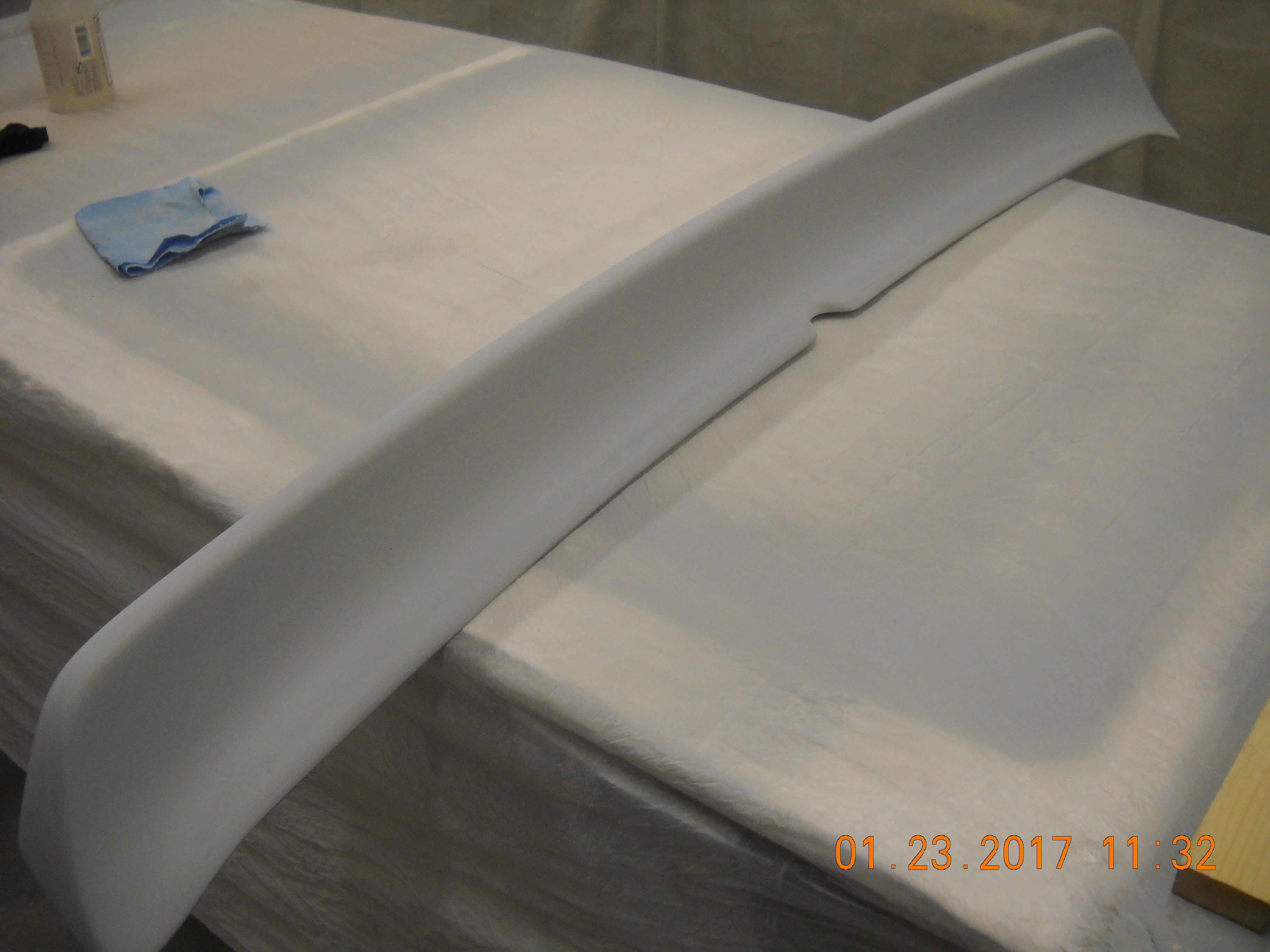

January 23, 20178 yr Author comment_510961 well, another small step forward today. the rear spoiler is painted. i debated for a couple of weeks between body color and black.......... prepped, primered, smoothed out, ready for color and the winner is............... this stuff actually works very well for a rattle can. it is a 2 stage paint with a very nice nozzle that sprays a pattern almost like a spray gun. once you activate the catalyst, the paint is only good for about 24 hours. i paid about $23 for the can, but a pint of regular paint would have cost that much. no clean-up of spray gun. i was able to put 4 coats on the spoiler including the bottom. came out very nice Link to comment https://www.classiczcars.com/forums/topic/52787-sweatys-rebuild/?&page=18#findComment-510961 Share on other sites More sharing options...

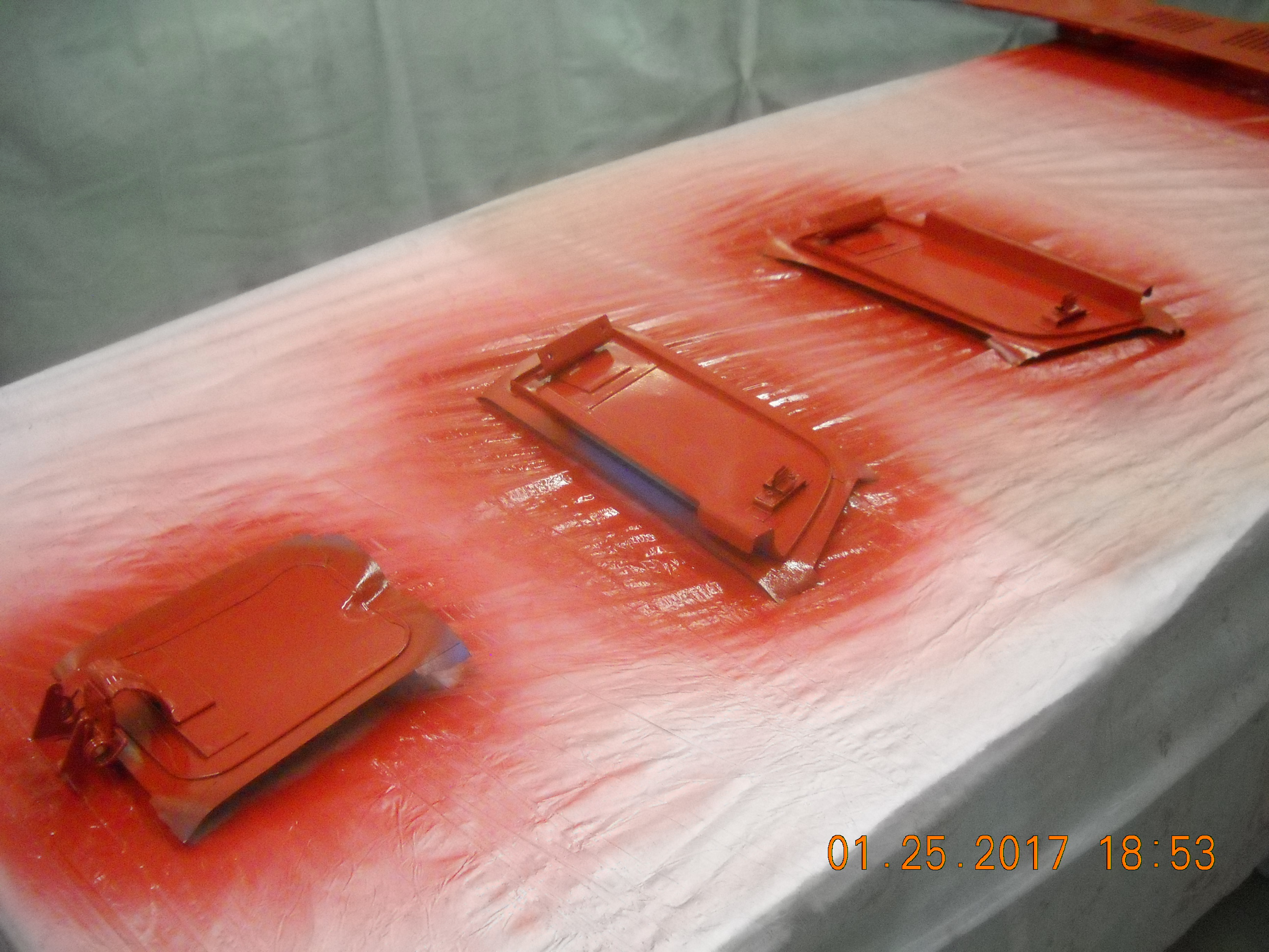

January 26, 20178 yr Author comment_511121 got a little color on tonight bottom sides of the gas filler lid and inspection covers after the clear coat Link to comment https://www.classiczcars.com/forums/topic/52787-sweatys-rebuild/?&page=18#findComment-511121 Share on other sites More sharing options...

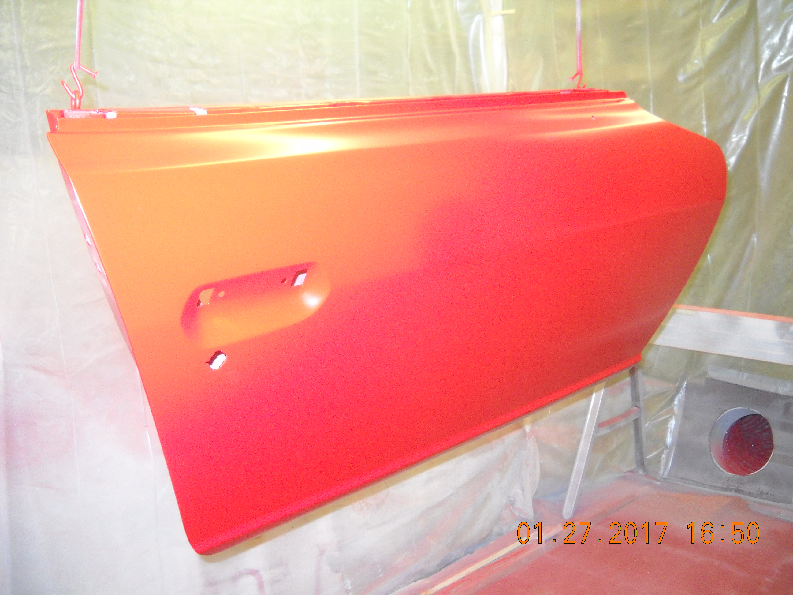

January 27, 20178 yr comment_511217 Is that 110 Persimmons? It has the same color change in photos as mine did, one picture looked red the next orange. Looks great whatever color it is, spoiler too! Link to comment https://www.classiczcars.com/forums/topic/52787-sweatys-rebuild/?&page=18#findComment-511217 Share on other sites More sharing options...
January 28, 20178 yr Author comment_511274 23 hours ago, siteunseen said: Is that 110 Persimmons? It has the same color change in photos as mine did, one picture looked red the next orange. Looks great whatever color it is, spoiler too! Site, it is called tor-red. one of chryslers colors from the newer cars. im really liking the red-black Link to comment https://www.classiczcars.com/forums/topic/52787-sweatys-rebuild/?&page=18#findComment-511274 Share on other sites More sharing options...

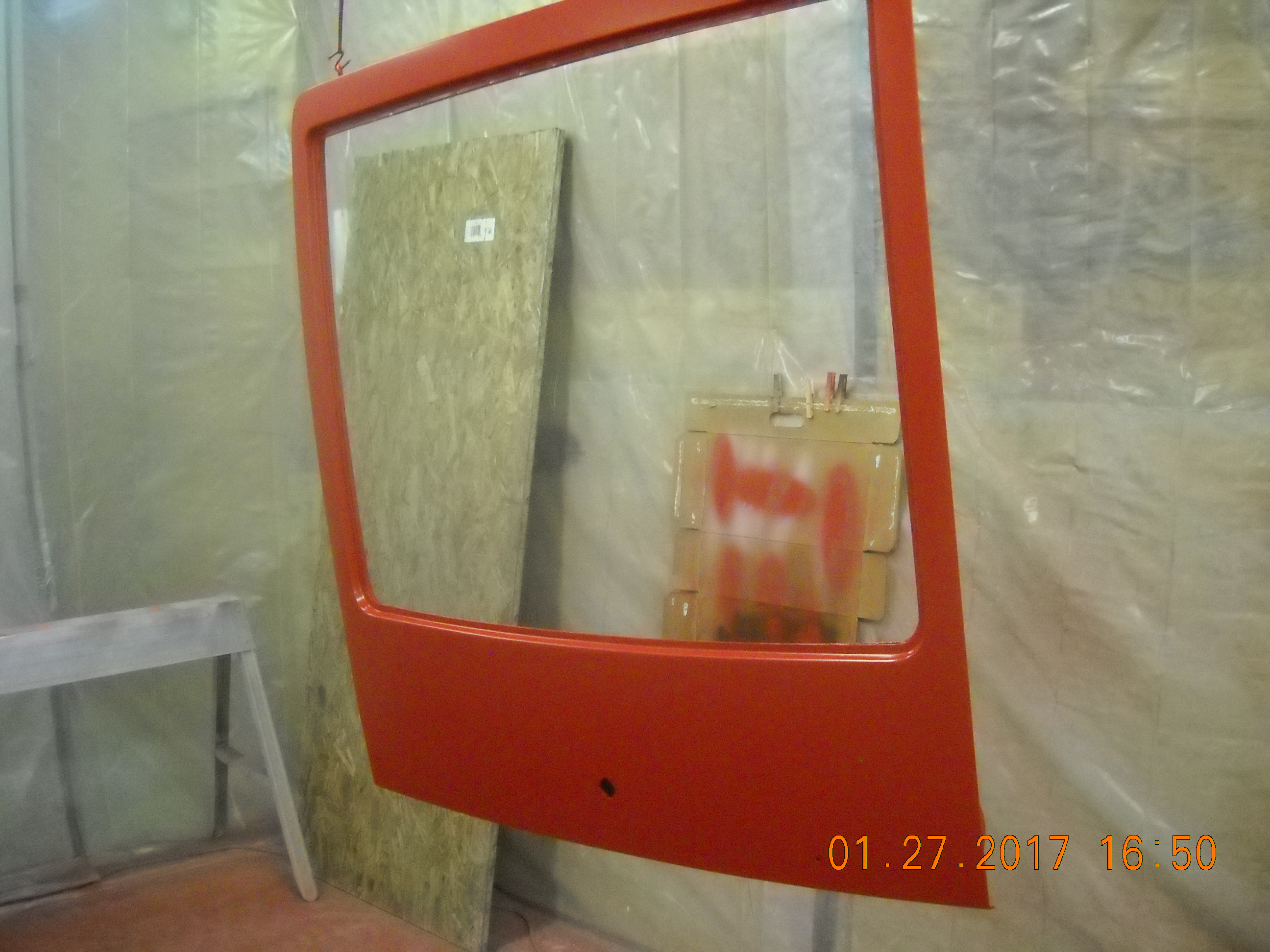

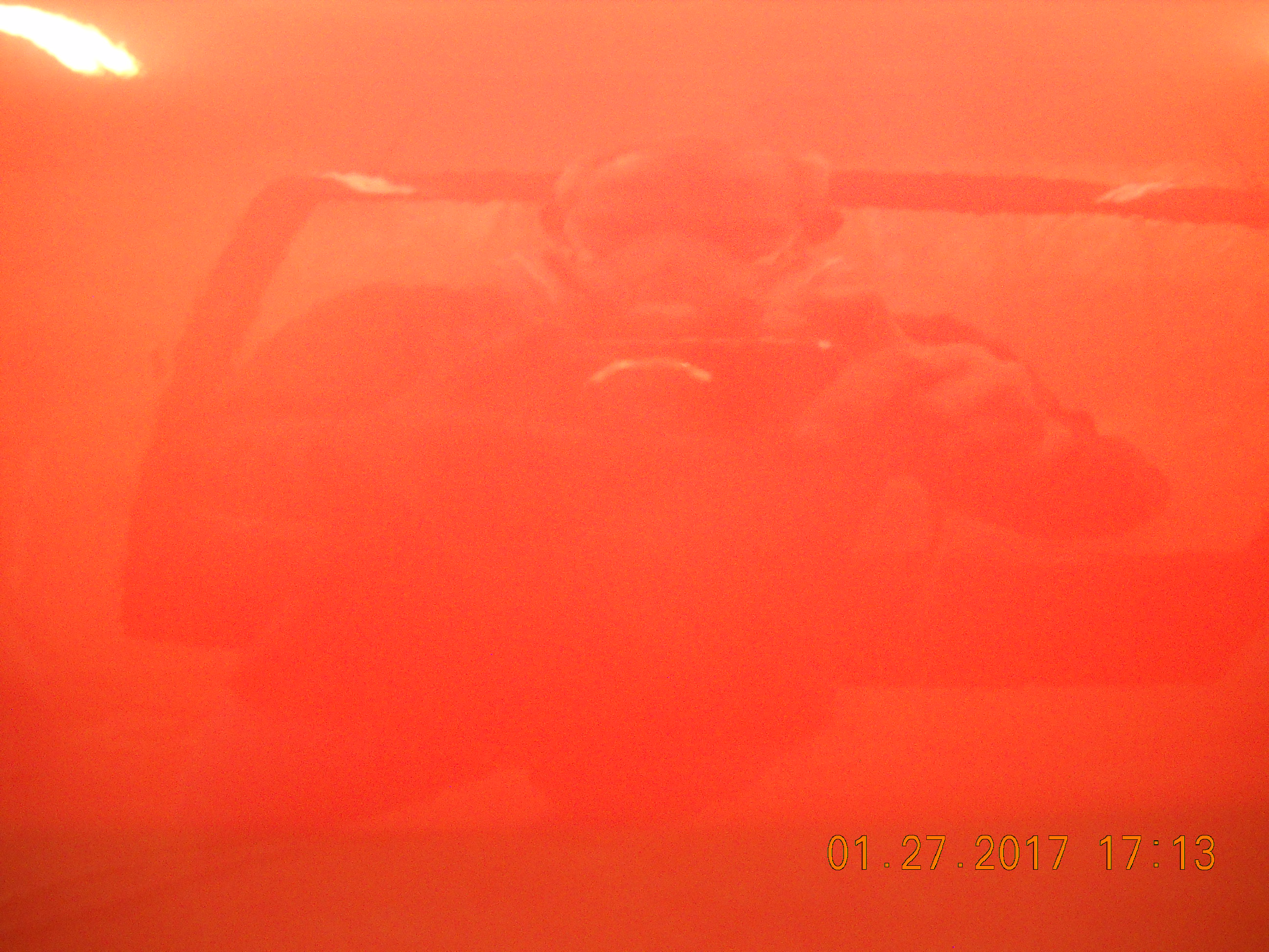

January 28, 20178 yr Author comment_511275 little more color last nite. going to try and get the hood done today Link to comment https://www.classiczcars.com/forums/topic/52787-sweatys-rebuild/?&page=18#findComment-511275 Share on other sites More sharing options...

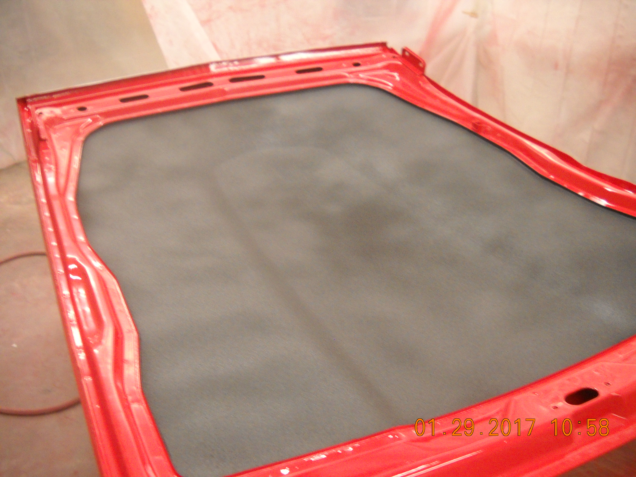

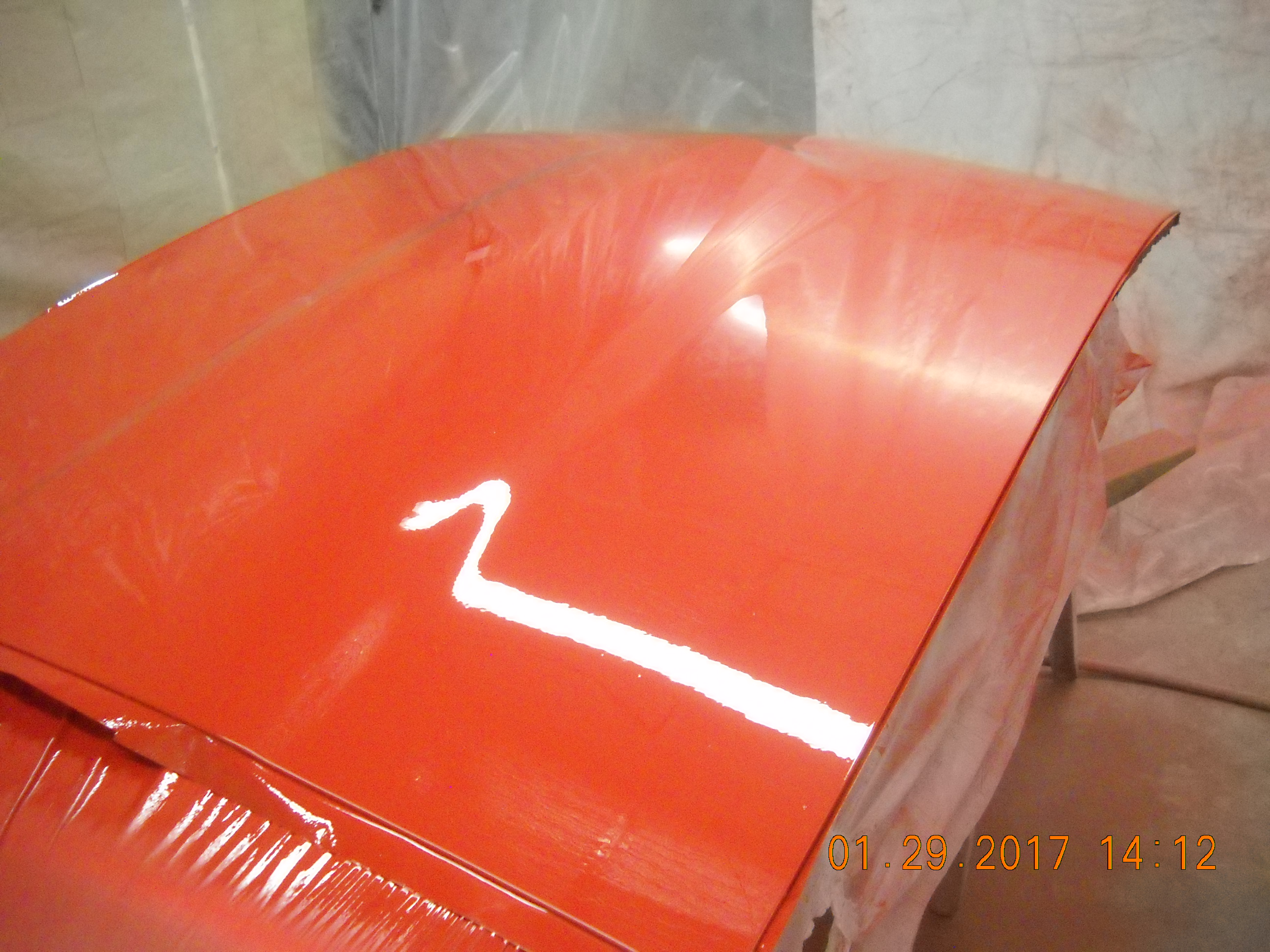

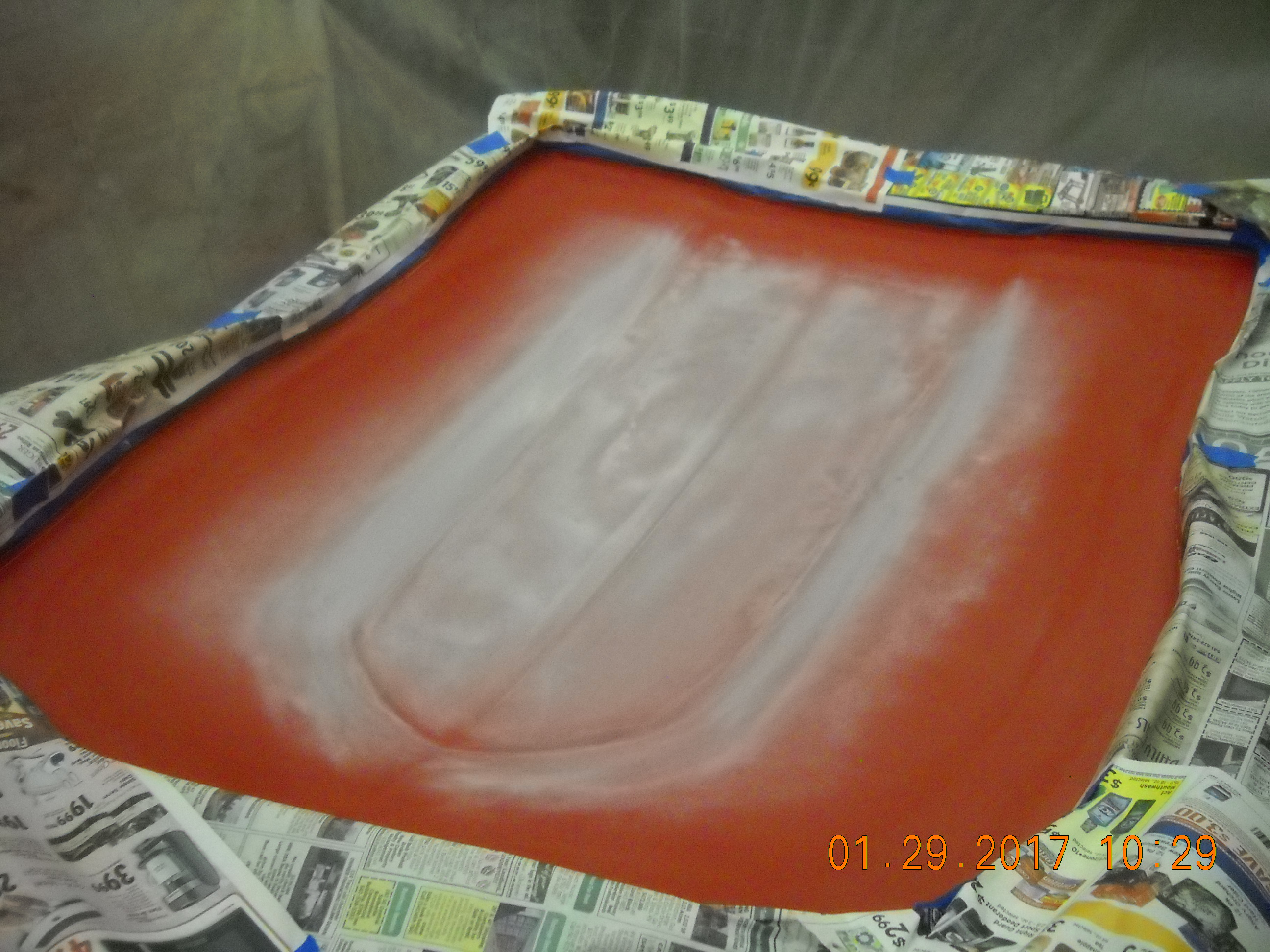

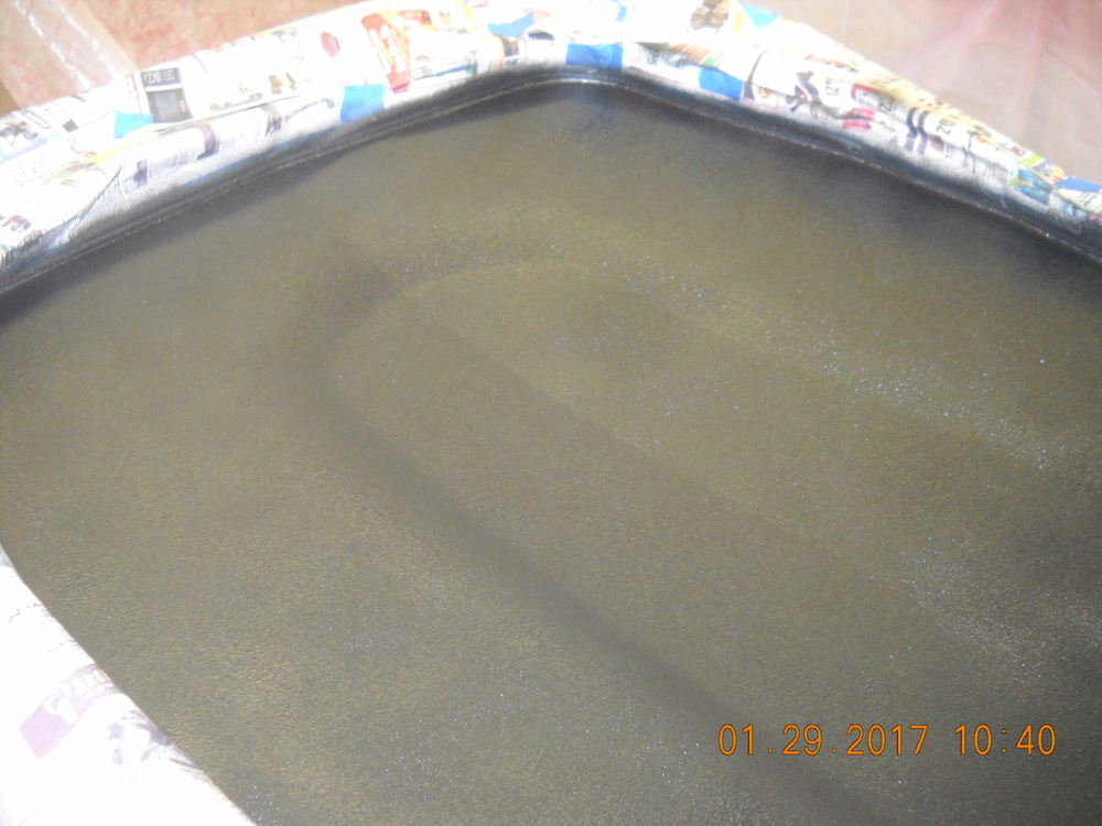

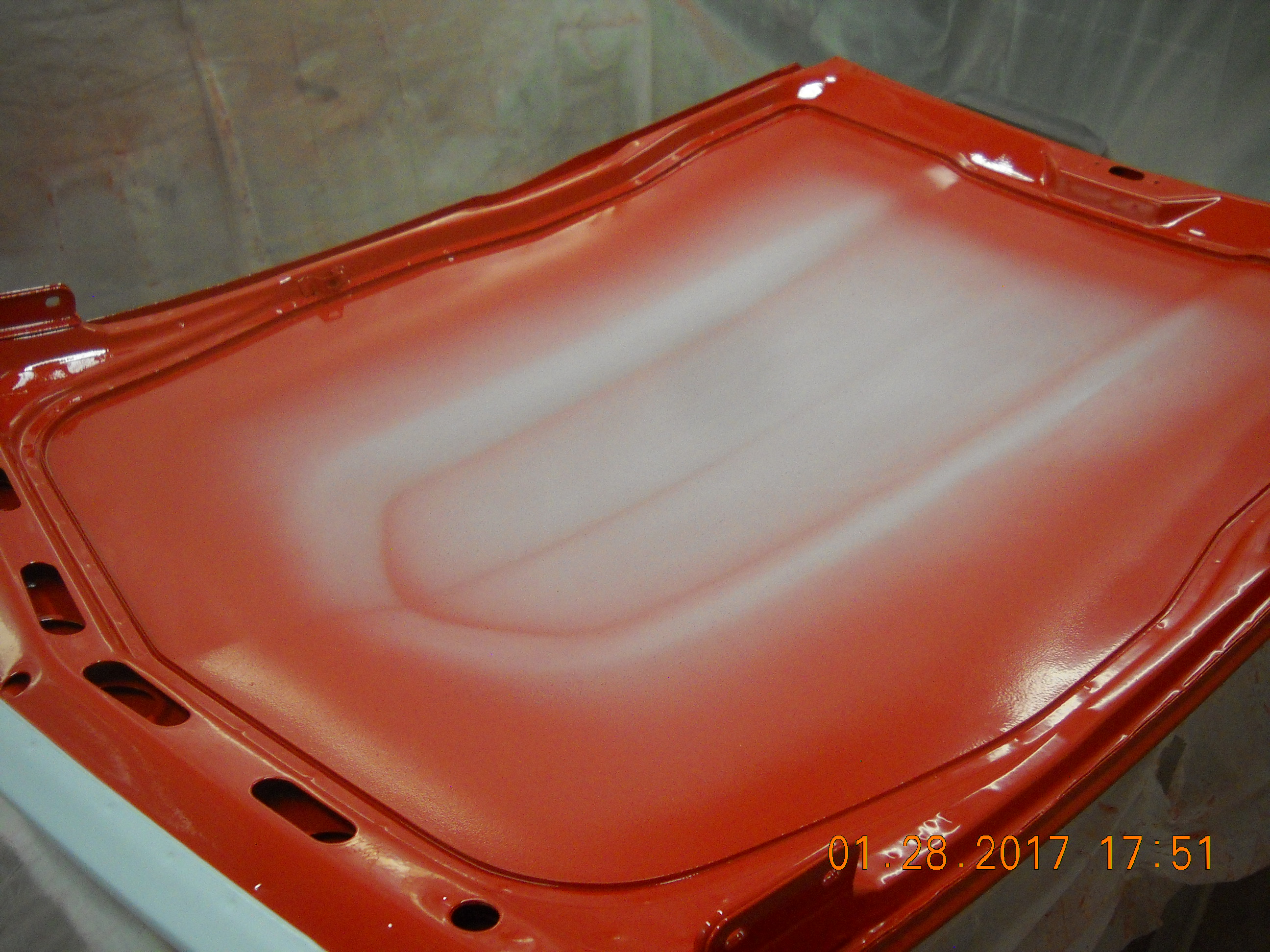

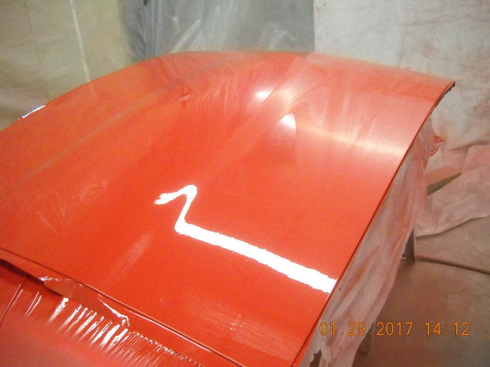

January 30, 20178 yr Author comment_511362 hood got some color today. a few spots of dust, but otherwise it came out good inside edges inside center masked and ready for bed liner. this hood had been danced on, so every little dent and ding would have shown if i had painted it body color. you can see some of the wave-i-ness (sp?) in the center. the black bed liner has a texture and hides all the imperfections. it should also help to deaden noise and the top-side Edited January 30, 20178 yr by sweatybetty Link to comment https://www.classiczcars.com/forums/topic/52787-sweatys-rebuild/?&page=18#findComment-511362 Share on other sites More sharing options...
