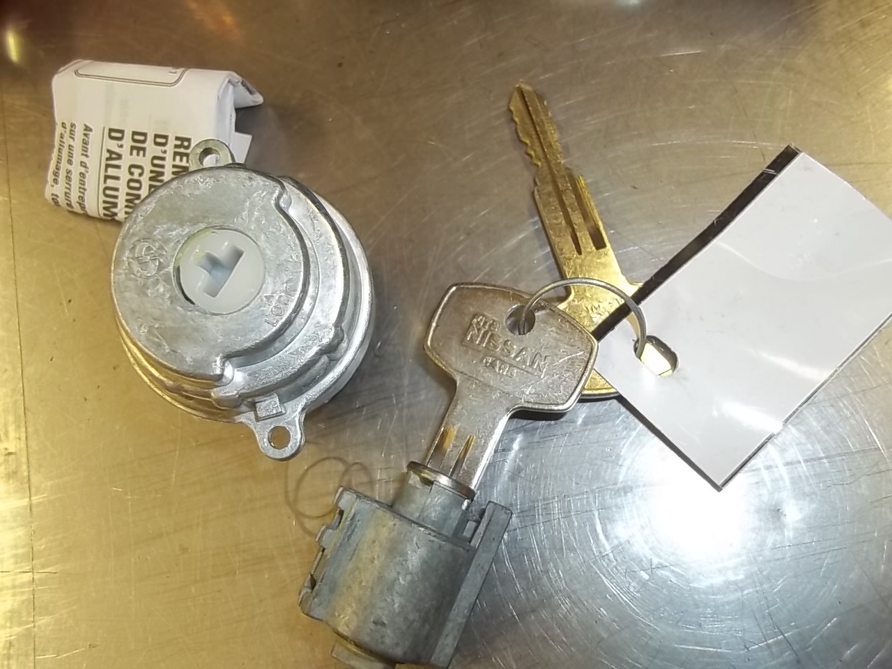

ok, here goes. first, i was able to get a new ignition switch and lock cylinder from my local carquest. the key is like the originals, whereas the the others i have seen were not

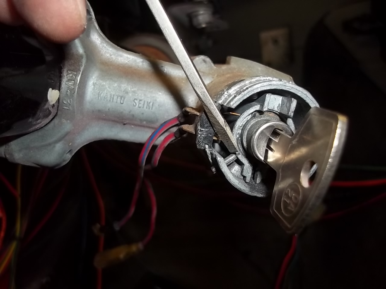

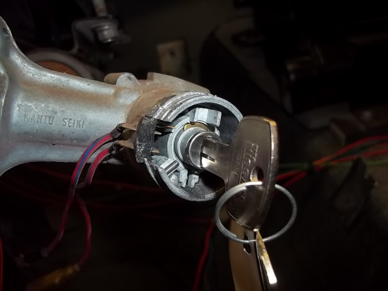

replacing the lock is fairly simple. remove the outer trim ring by tapping it from the back with a screwdriver and small hammer. the inner ring takes some prying with a screwdriver and was a little harder, but it needs to come off, it covers the pin that holds
the cylinder in place. pry the pin out, and the cylinder pulls right out. put the new cylinder in, push the pin back in and re-install the trim rings. i havent done that yet because im going to powder coat them.

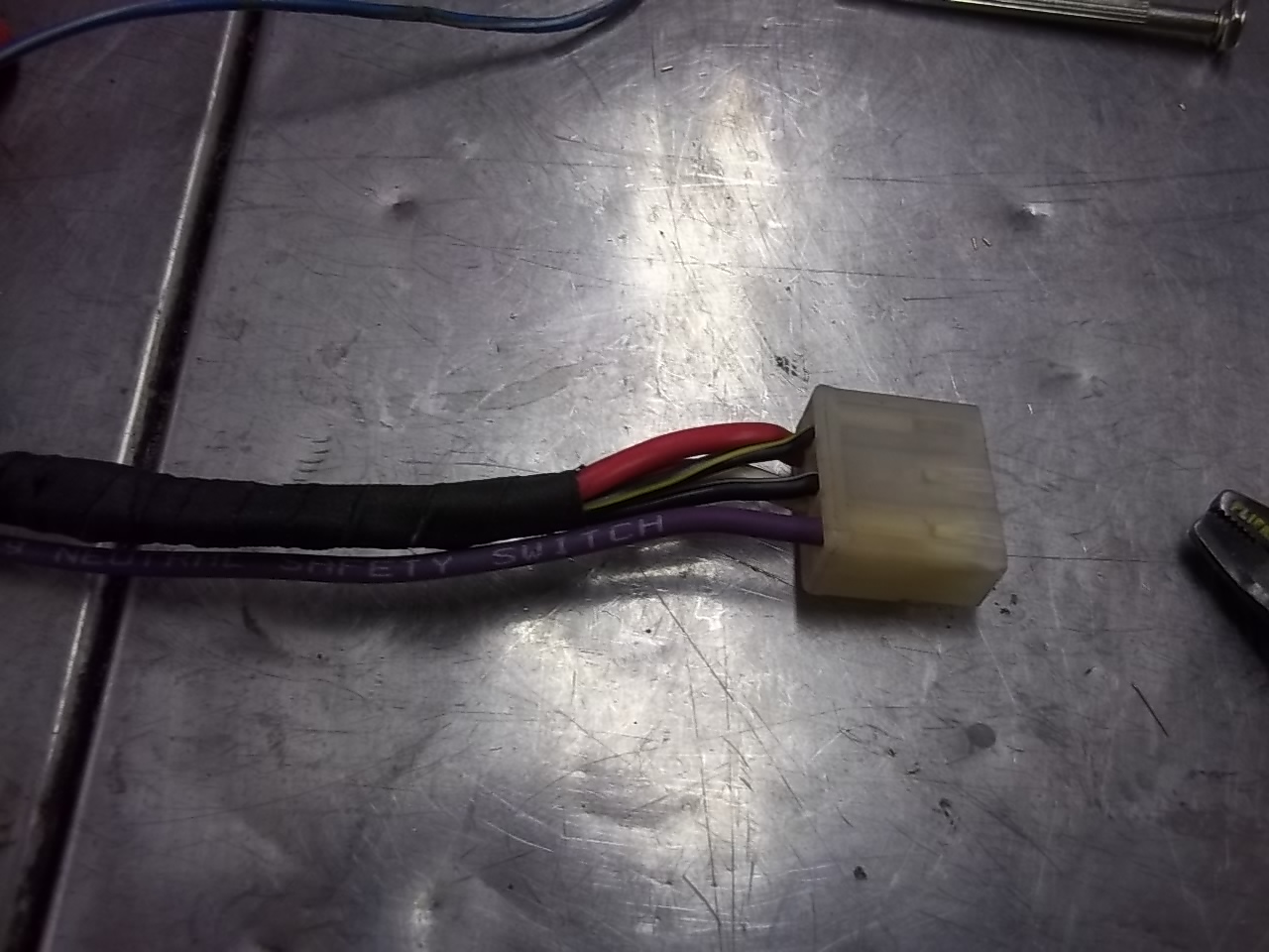

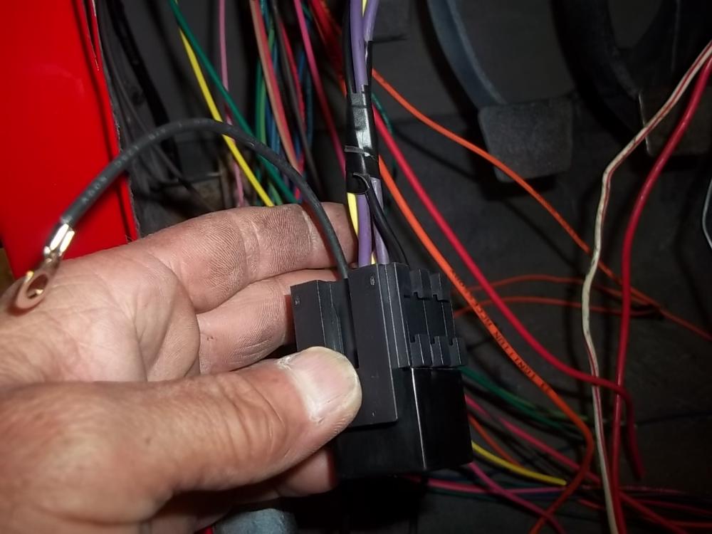

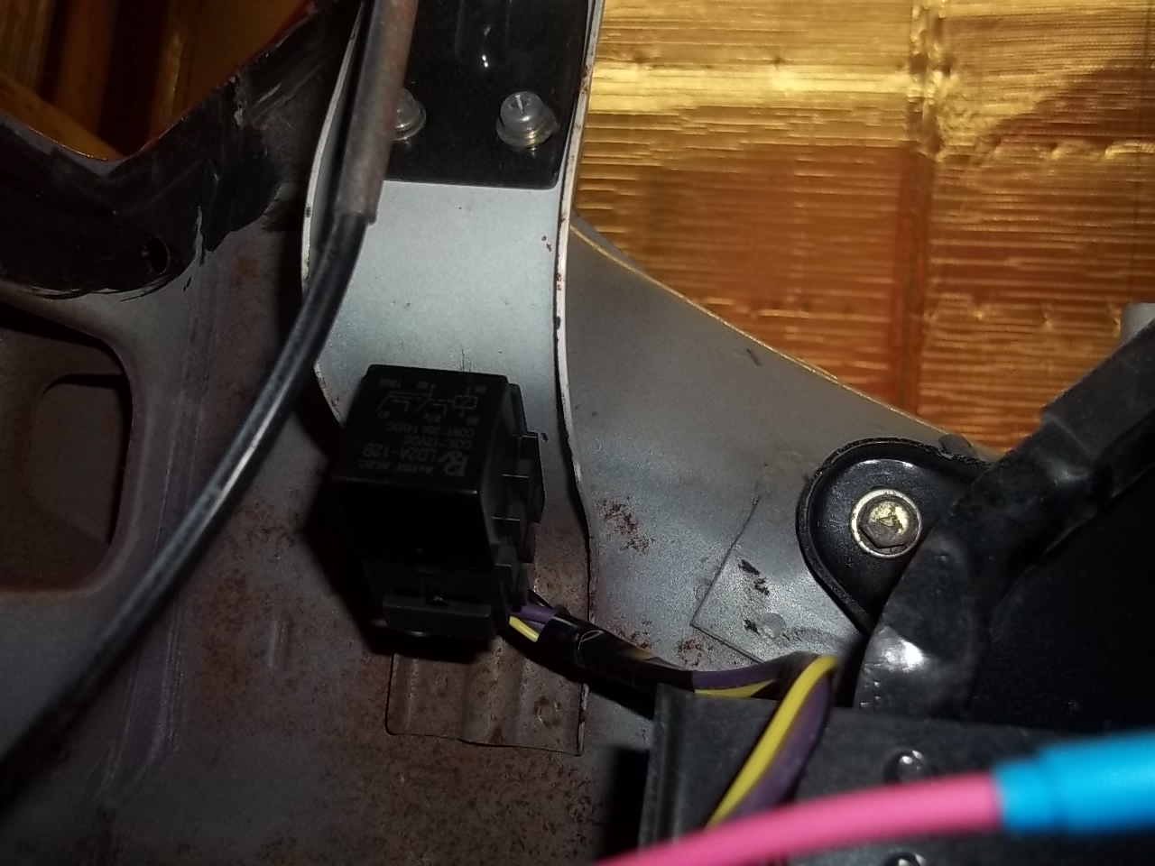

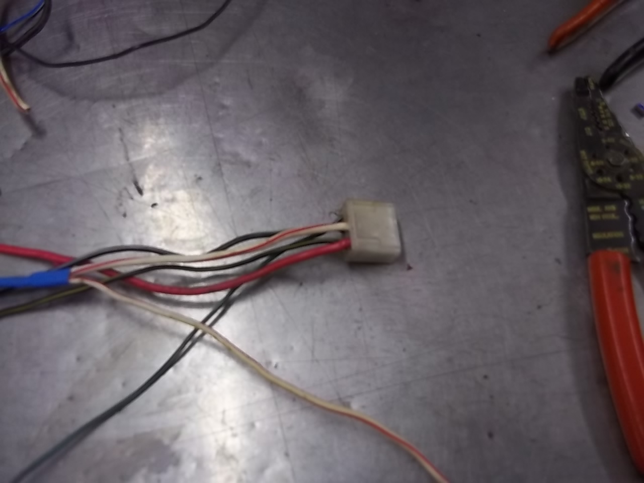

here is the wiring plug that attaches to the ignition switch. i moved  some of the wires to different terminals to try to match the new wire colors. you will notice the purple is to the starter solenoid, i have since removed it to avoid drawing too many amps through the switch, and added a relay.

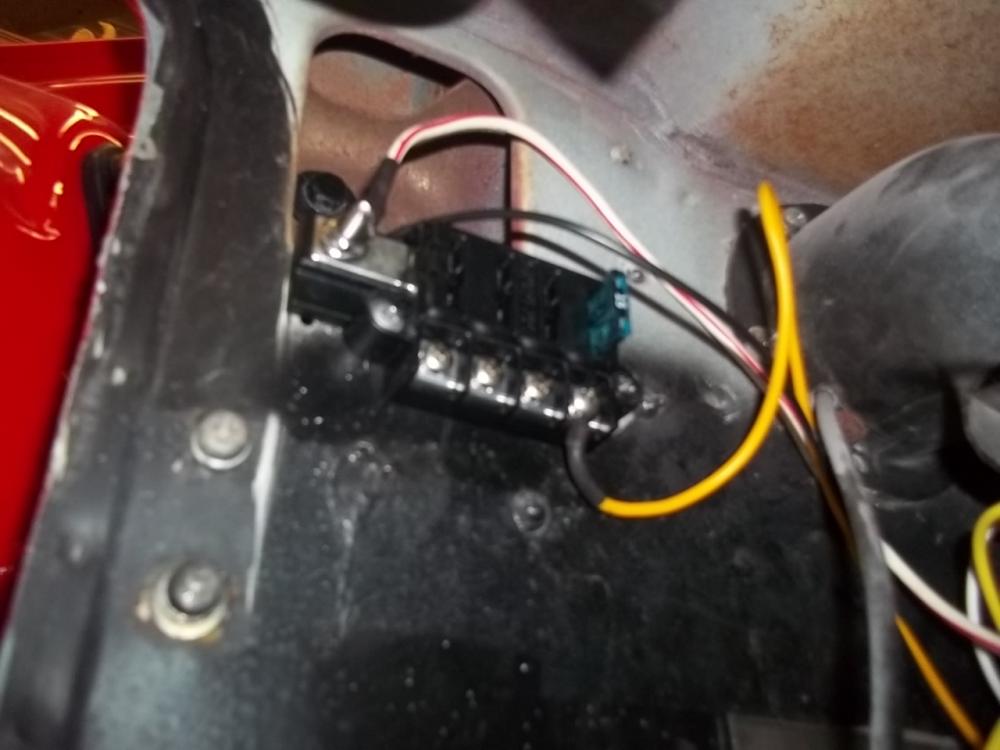

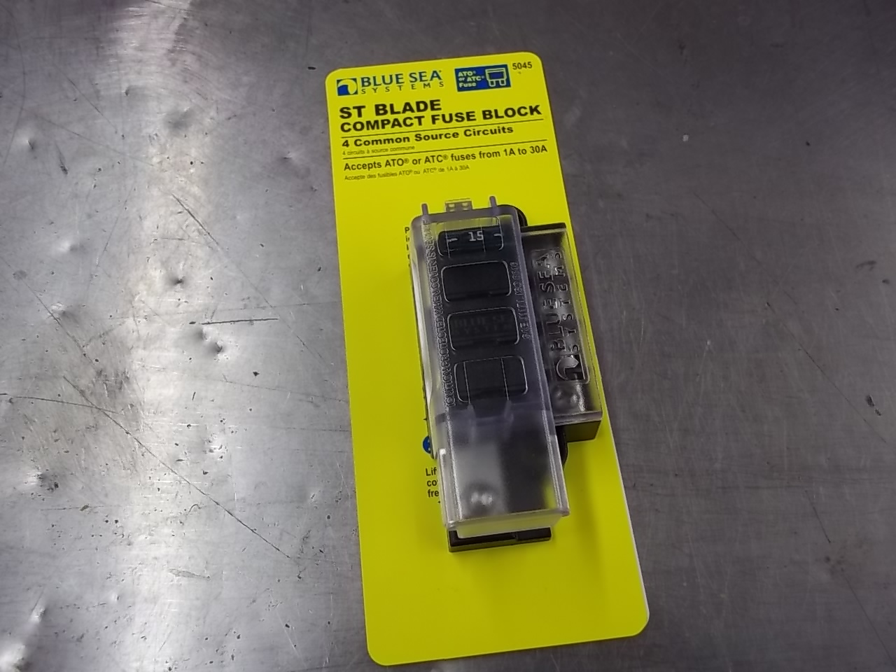

here is a new fuse block that is going to be used for some accessories such as the power antenna. i could have bought a harness with more circuits, but that was an extra $75. i think this block was $15+/-. this gets fed from the ignition switch "accessory" wire.

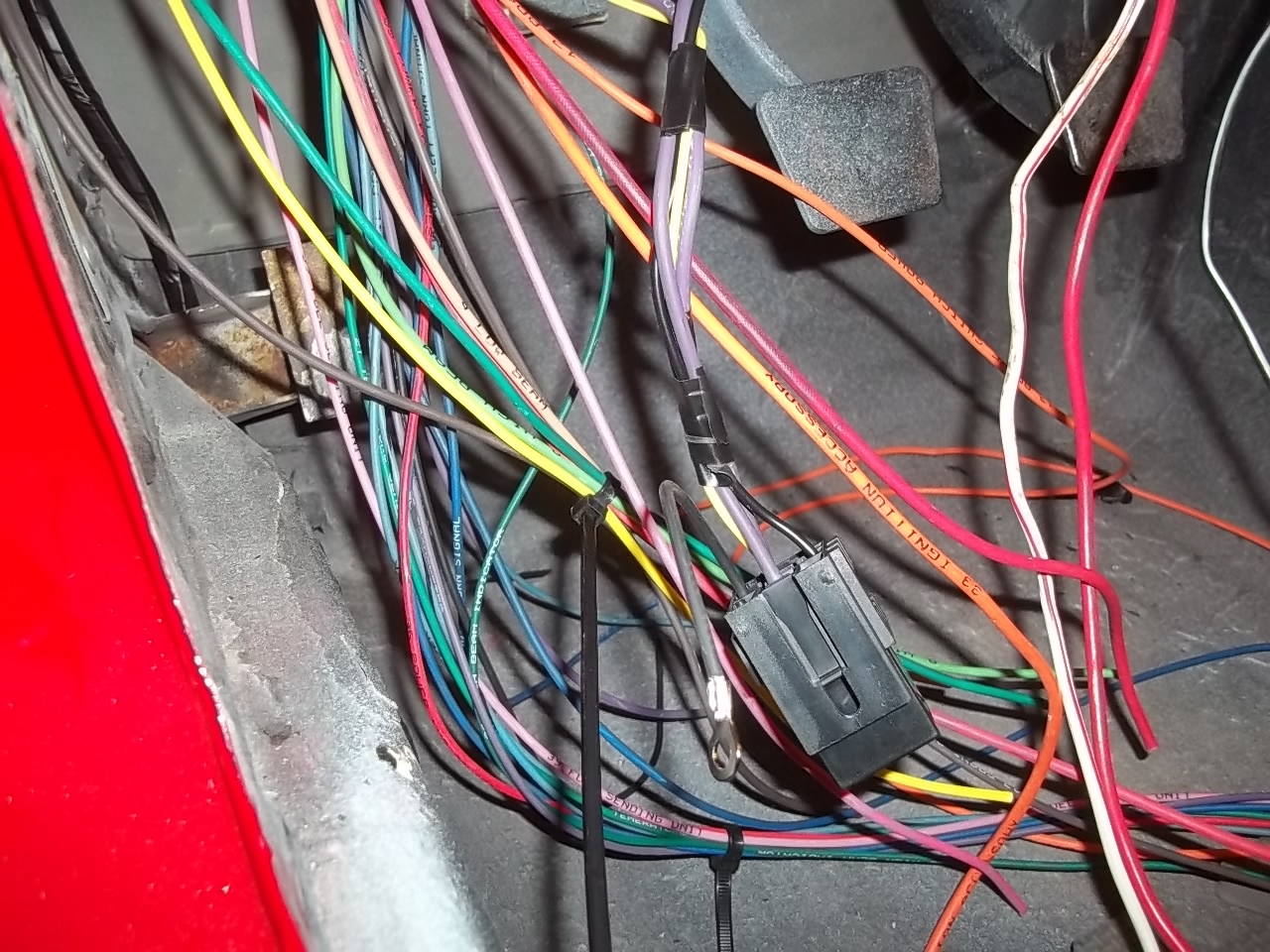

sorting out the different ignition wires and brake light power. i changed from the original so now the brake lights are not connected with the turn signals. all connections are crimped and have 2 layers of heat shrink tubing over them.

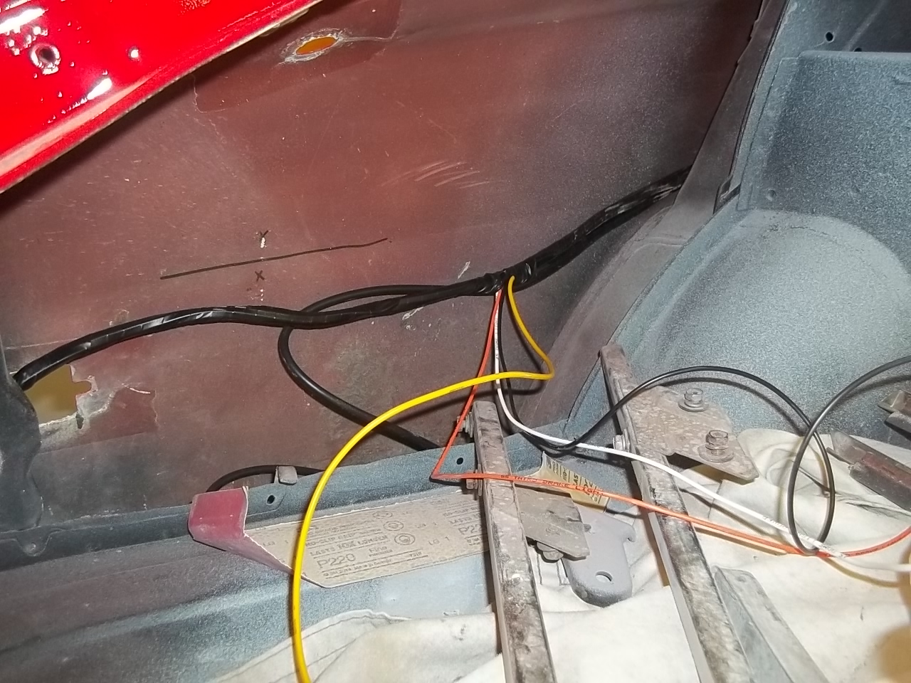

here are the new antennae wire, power antennae feed and the control wire from the radio. the black and white wires go to the dome light. what a pita fishing those wires up there was!!100_1723.JPG

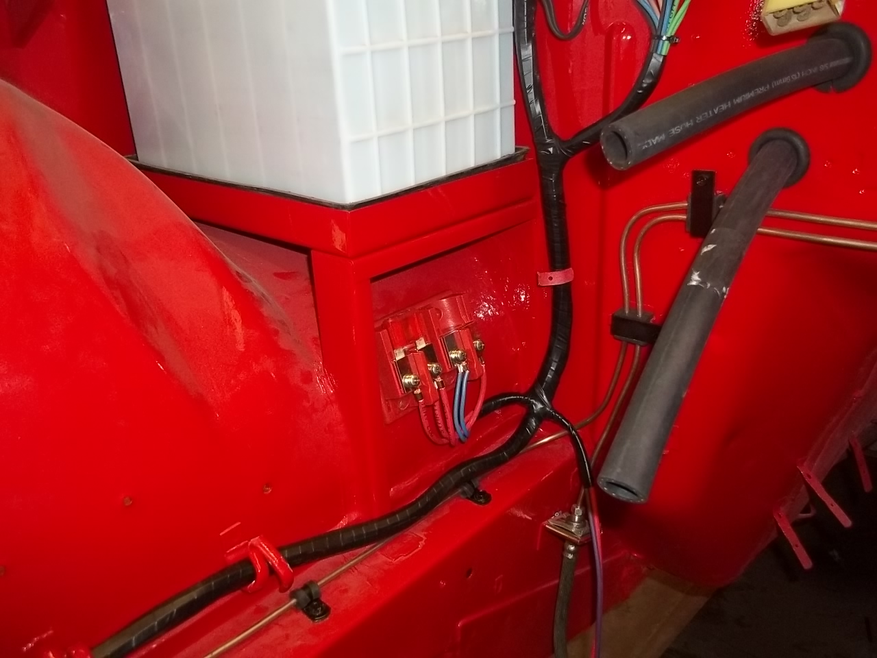

heater, radio,back up lights, e-flasher and neutral switch wiring close
the back up and neutral switch wiring go through this rubber plug in the trans tunnel. the ground wires are for the wipers. i am going to install a ground stud there so i have
room for those radio ground wires also
