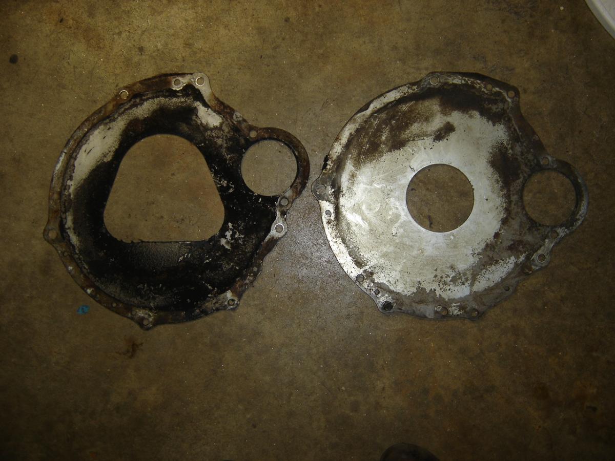

Automatic plate is on the left, I believe?!?

The photo on the left is the plate found  between the .manual transmission and the engine block.
No experience with the one on the right soooo---I dunno about it.

Did your photos  get reversed or are you have difficulty with the morning coffee/ wake-up routine?? :unsure:
Okay I'm aware of my mistakes now. Left is off my 72 I'm rebuilding now
Right is off a ZX motor I tore apart.
I hope that round thing with the starter gear around it is in my storage building. I'm working this a.m and hadn't looked yet. Also thinking back the auto has a half of a separating plate, no?
Site-
The AT separating plate is split with a separate plate on the lower portion. This plate gives access to the four bolts coupling the flex plate to the torque converter.
