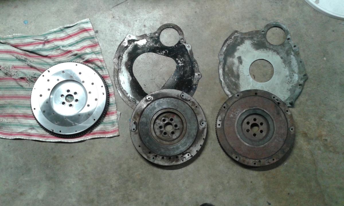

November 15, 20159 yr comment_481062 Bad news Palmetto bug. It must have gotten thrown out during a spring clean up. I think I remember telling the guy at the recycle place it was off a 40 something year old car. Sorry, I kept it for a few years and got crazy one day and threw a bunch of stuff in my truck and hauled it off. Here's all I have, 240mm 225mm and aluminum 225mm. Link to comment https://www.classiczcars.com/forums/topic/52821-need-flexplate-source/?&page=2#findComment-481062 Share on other sites More sharing options...

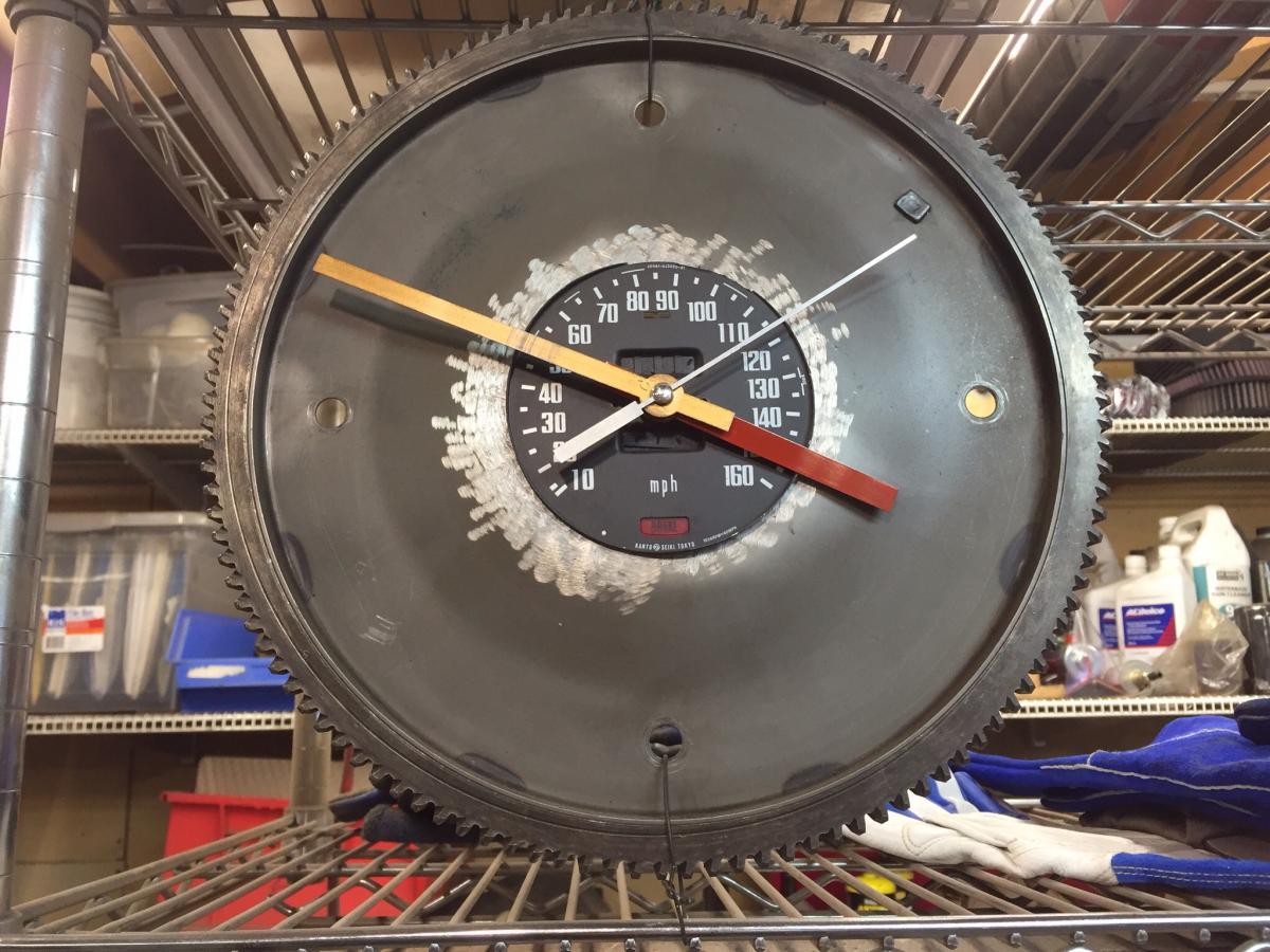

November 15, 20159 yr comment_481077 That's going to be tough to find. I have one, but its busy... And I had to cut out the back to make the clock fit.... Sorry.... Link to comment https://www.classiczcars.com/forums/topic/52821-need-flexplate-source/?&page=2#findComment-481077 Share on other sites More sharing options...

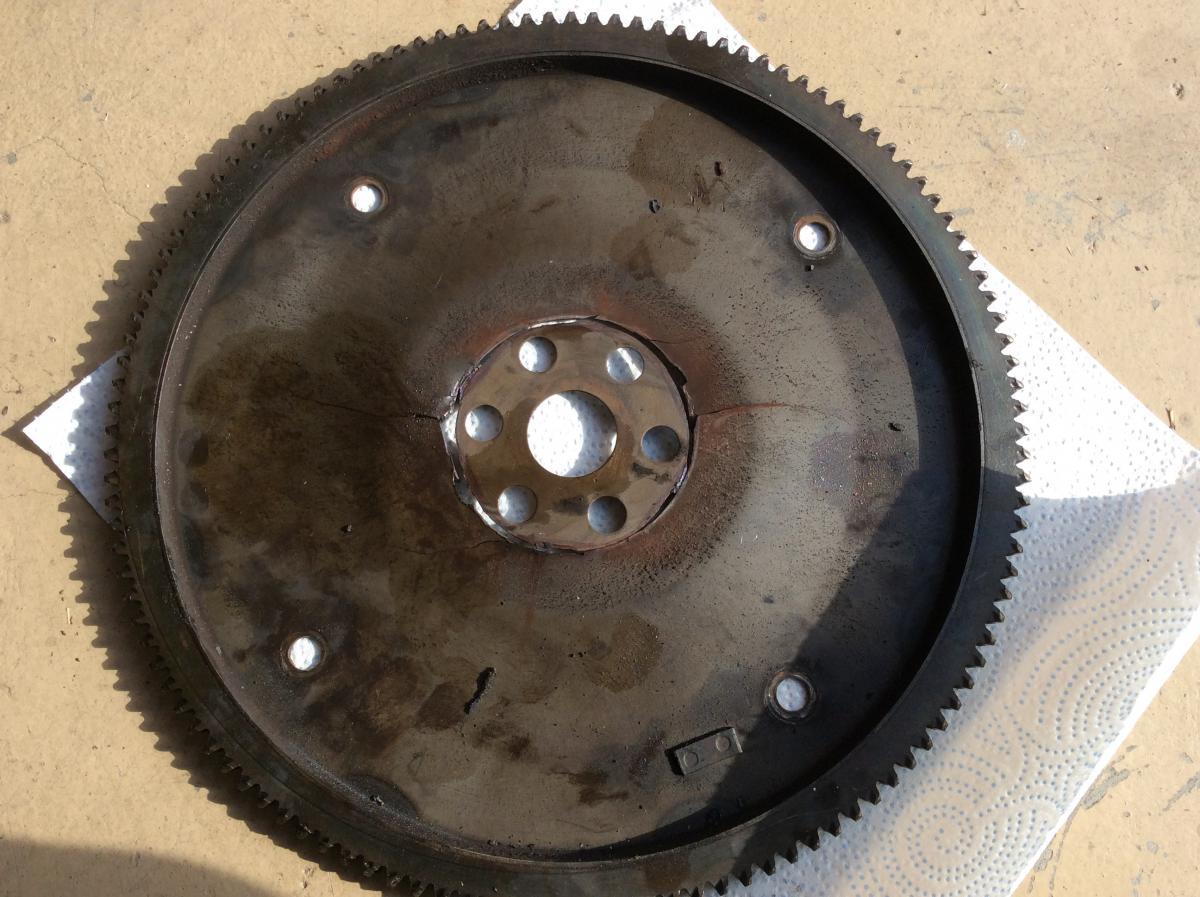

November 16, 20159 yr comment_481085 It looks like the flex plate with the OEM number 12331-U9511 should work. The 3N71AorB AT was the one use for all the S30 models. If the only problem you have is with starter engagement, I would verify you have the correct starter before tearing into the engine. The gear ring on the flex plate is not in the same axial position as on the flywheel. I got a surprise when I replaced my AT, changing from a 3N71B from a 3N71A. The bell housing castings are slightly different and you cannot use the engine separator plates interchangeably. Also when we took the flex plate off, we got the surprise. The plate had failed at some point and spun on the drive shaft. At some point it jammed on the center piece with such force it friction welded itself together at two points. I had no idea it had failed til we removed it. Link to comment https://www.classiczcars.com/forums/topic/52821-need-flexplate-source/?&page=2#findComment-481085 Share on other sites More sharing options...
