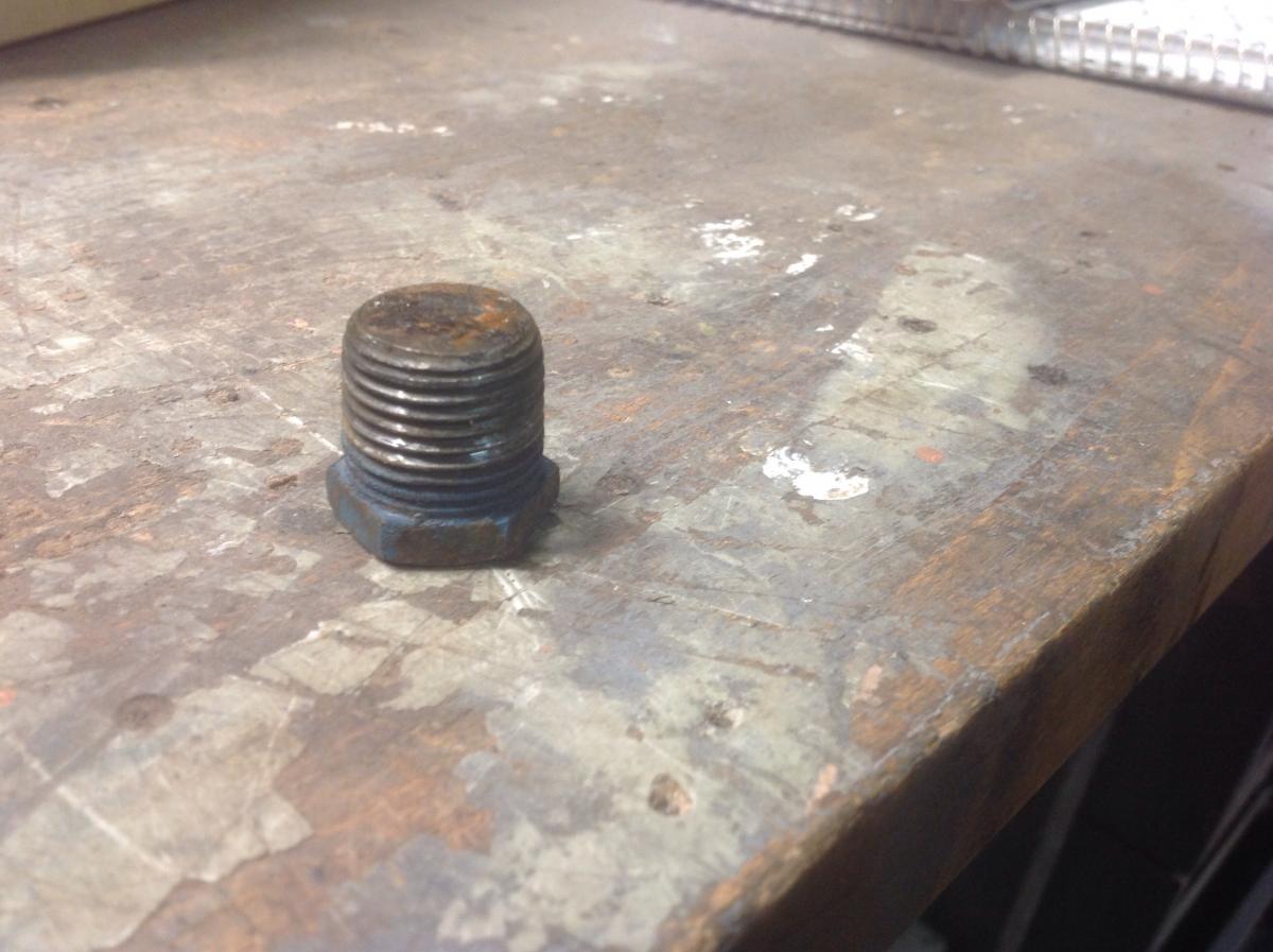

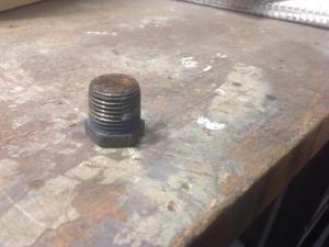

Posted November 16, 20159 yr comment_481114 Hi guys, does anyone know the size of the drain plug on a f54 block. Thanks Rex Link to comment https://www.classiczcars.com/forums/topic/52832-collient-plug-f54-block/ Share on other sites More sharing options...
November 17, 20159 yr comment_481181 The head is 22mm. but I'm guessing you mean the thread size. Let me get one and check. My guess is 1/2 inch BSPT. Link to comment https://www.classiczcars.com/forums/topic/52832-collient-plug-f54-block/#findComment-481181 Share on other sites More sharing options...
November 17, 20159 yr comment_481182 I know it's the same size as the elbow in the back of the head that feeds the heater core. Â I've swapped them. Â Link to comment https://www.classiczcars.com/forums/topic/52832-collient-plug-f54-block/#findComment-481182 Share on other sites More sharing options...
November 17, 20159 yr comment_481184 Yup, 1/2 BSPT. 14 TPI. Tapered pipe thread. Now, since 1/2 NPT is also 14 TPI, I'll say the likely un-popular thing and suggest you could use the NPT equivalent in its place with little consequence. Happy threading and plugging. BTW, this was checked on an N42 block. I don't think this varied across the various L6 blocks. Remind me to put that thing back in.... Edited November 17, 20159 yr by zKars Link to comment https://www.classiczcars.com/forums/topic/52832-collient-plug-f54-block/#findComment-481184 Share on other sites More sharing options...
