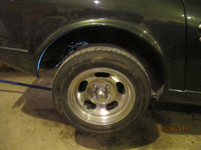

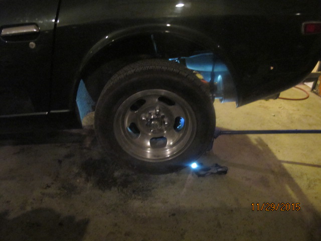

December 2, 20159 yr comment_482149 25-1/4" to the floor. Both sides the same when the strut towers are leveled up. I was planning to stay out of this, but what the heck... This post (that I quoted) established that the frame (chassis) is ok. That is unless it is rusted out and is sagging when loaded. That would be fairly obvious, though because the door gaps would be affected and in the extreme case the doors might not even open. So check the chassis off the list. There are two posts that in my mind narrow down the search considerably. First, look at these pictures: It's pretty obvious to me both sprung and unsprung the passenger wheel is higher that the driver's side. The only way that is going to happen is if the struts are different lengths. I suppose that the bushings could also cause this if you tightened them wrong but you said this problem was there before you changed the bushings and springs. My suggestion is to take both strut assemblies out. Shine a light into the strut tower and make sure there isn't anything jammed in there and then measure the height from the center of the axle to the top of the strut mount insulator. Obviously they should both be the same. If they are you should check the damper and make sure they are the same on each side. Then the springs (but I don't think it's the springs because the unsprung height difference). One thing that you might not know is that the MSA strut mount insulators are 3/4" lower than the stock ones. So, if you have two different insulators... Link to comment https://www.classiczcars.com/forums/topic/52895-problems-leveling-my-240z/?&page=6#findComment-482149 Share on other sites More sharing options...

December 3, 20159 yr Author comment_482198 Ok I lifted it off the ground and placed a block under the passenger cab corner and lowered it until level across the strut towers. I measured from bottom of tires to top of the tires on both sides - 23" I measured the distance from top of the tire to the fender passenger side measured 4.75" Driver side 5.75". I measured from the top of inner strut housing to the spindle bolt Passenger side - 27-5/8" Driver side 27-3/4". Nothing makes sense. When lowered to the ground the distance from top of the tire to the fender - Passenger 3/4" Driver 2-3/4" Link to comment https://www.classiczcars.com/forums/topic/52895-problems-leveling-my-240z/?&page=6#findComment-482198 Share on other sites More sharing options...
