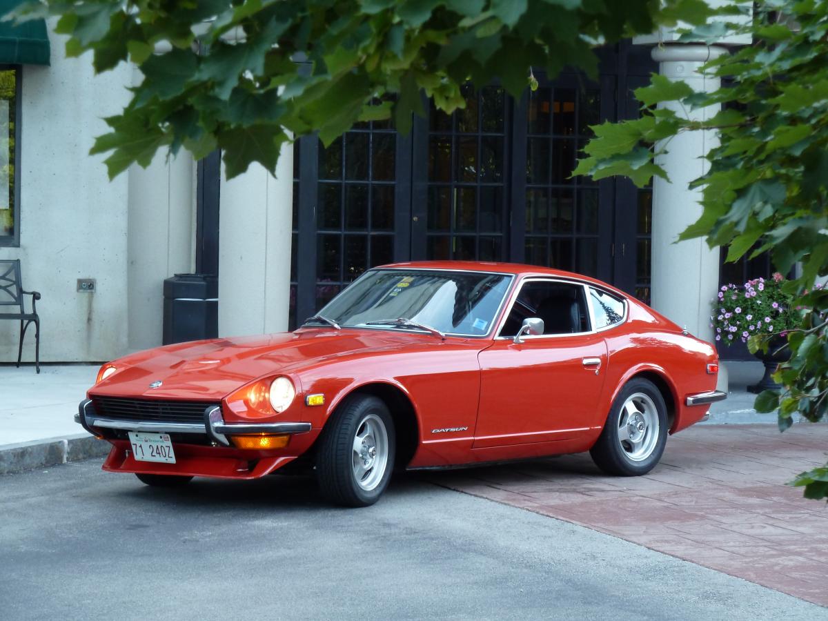

December 2, 20159 yr comment_482142 Smaller ITM pistons for a 240z were used in this beauty: Â Â They work great. Link to comment https://www.classiczcars.com/forums/topic/52912-itm-flattop-pistons/#findComment-482142 Share on other sites More sharing options...
