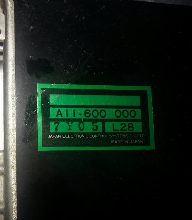

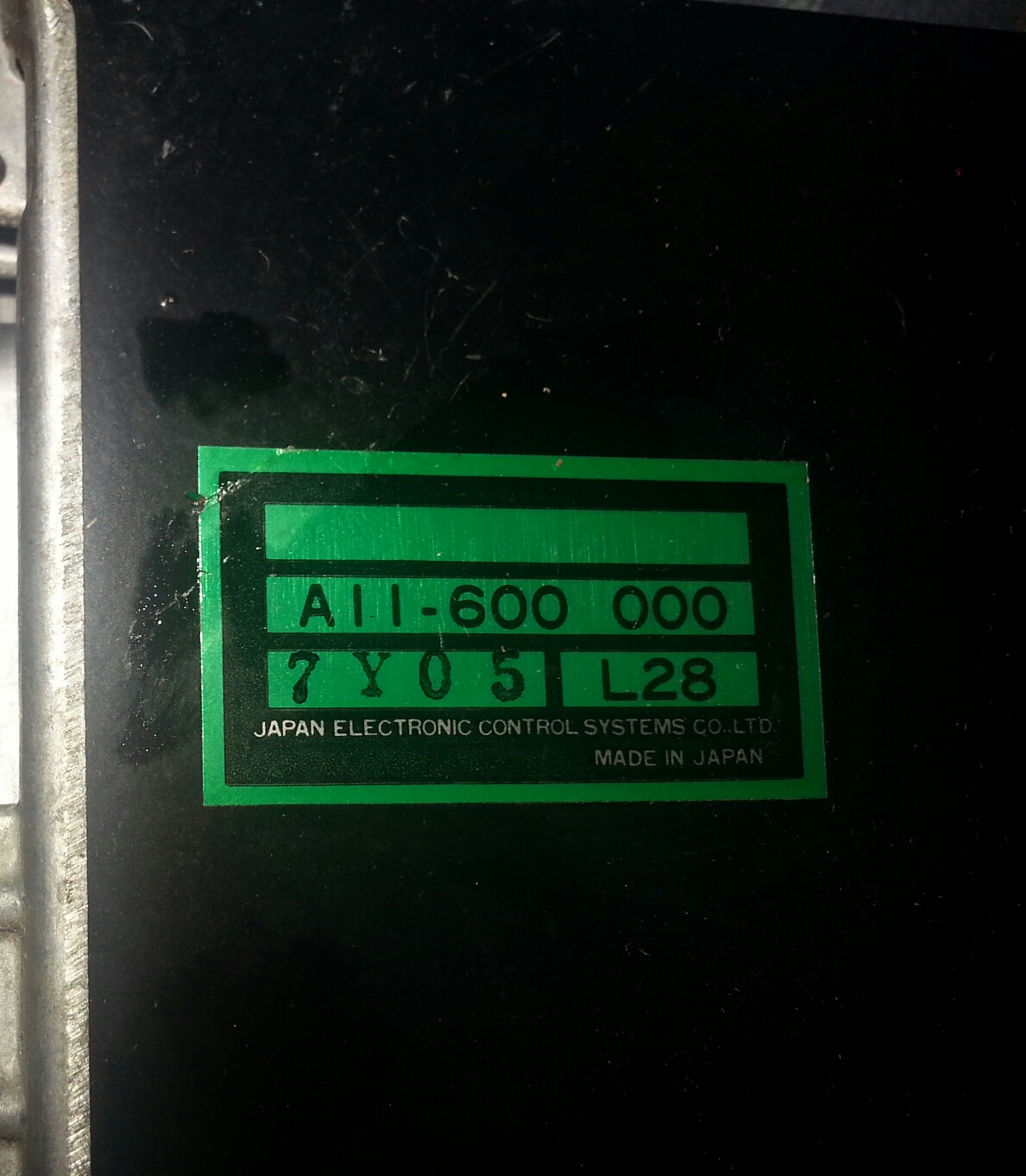

February 15, 20169 yr Author comment_486495 The ECU from rcb280Z arrived, and was put in RedBird yesterday. It is an A11-601-000. What came out was an A11-801-000. Think that difference in the number could be part of the reason why she has had stalling problems? I didn't drive much today. I'll have to do a gas run soon and that will give some miles testing. Who knows how long I'll have to drive to find out, anyone have any idea? Looking forward to finding out if this helps RB. Jai Link to comment https://www.classiczcars.com/forums/topic/52923-what-a-difference-a-day-makes-with-redbird/?&page=8#findComment-486495 Share on other sites More sharing options...
February 15, 20169 yr comment_486501 I can't find any reference to such a thing as an A11-801-000. Can you take a picture? Could be a scratched 6. Link to comment https://www.classiczcars.com/forums/topic/52923-what-a-difference-a-day-makes-with-redbird/?&page=8#findComment-486501 Share on other sites More sharing options...
February 15, 20169 yr comment_486508 On 2/7/2016 at 5:15 PM, Lumens said: On 2/6/2016 at 3:08 PM, rcb280z said: 2 hours ago, Zed Head said: I can't find any reference to such a thing as an A11-801-000. Can you take a picture? Could be a scratched 6. Ok Im not sure whats going on but I only selected Zed Heads post to quote, not the other 2 above. Anyway, I too can't find any reference to said part number. I think she has the correct ECU and like you said the 6 was probably scraped making it look like an 8. So hopefully the ECU I sent Jai is the answer to her issues. I know the one I sent her is a good unit. I ran it in my 77 for a couple months and all was good. Edited February 15, 20169 yr by rcb280z Link to comment https://www.classiczcars.com/forums/topic/52923-what-a-difference-a-day-makes-with-redbird/?&page=8#findComment-486508 Share on other sites More sharing options...
February 15, 20169 yr Author comment_486519 10 hours ago, Zed Head said: I can't find any reference to such a thing as an A11-801-000. Can you take a picture? Could be a scratched 6. You are so right ZedHead! But not a scratch, blame my "mature" eyes. Hahaha... I took a photo of the ECU taken out of RedBird. That statement was made to insure all "who's on first". Thanks guys... Jai Link to comment https://www.classiczcars.com/forums/topic/52923-what-a-difference-a-day-makes-with-redbird/?&page=8#findComment-486519 Share on other sites More sharing options...
February 15, 20169 yr comment_486525 And not to add to the confusion but....according to the chart Zed Head posted the 600 series ECU is the one for M/T and the 601 is for the A/T. My M/T has always had the 601. So go figure. Not sure that it really means anything, or if it matters. Edited February 15, 20169 yr by rcb280z Link to comment https://www.classiczcars.com/forums/topic/52923-what-a-difference-a-day-makes-with-redbird/?&page=8#findComment-486525 Share on other sites More sharing options...
