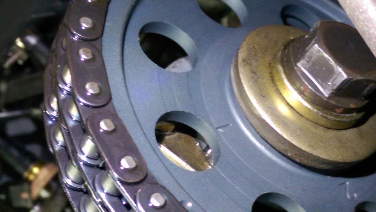

December 18, 20159 yr Author comment_483113 Cam lobes were positioned to spec. Not knowing better, I adjusted cam so #1 lobe was pointing straight up, which did not help....probably hurt. Now I have to go back to reset. Edited December 18, 20159 yr by rosaluma Link to comment https://www.classiczcars.com/forums/topic/52932-77-280-cold-start-vs-main-injectors/?&page=4#findComment-483113 Share on other sites More sharing options...
December 18, 20159 yr comment_483117 Check this. With the ignition timing mark on zero, and the straight (driver's) side of the chain tight. Link to comment https://www.classiczcars.com/forums/topic/52932-77-280-cold-start-vs-main-injectors/?&page=4#findComment-483117 Share on other sites More sharing options...
December 18, 20159 yr Author comment_483118 Yep, it was in the position located in the before image, before I tweeked. Now, its off the charts. Will put back, later tonight. Edited December 18, 20159 yr by rosaluma Link to comment https://www.classiczcars.com/forums/topic/52932-77-280-cold-start-vs-main-injectors/?&page=4#findComment-483118 Share on other sites More sharing options...
December 20, 20159 yr Author comment_483220 Found the problem, oil pump shaft is 180 degrees off. So, distributor would settle in 180 degrees off. Bad news is I dropped my 19mm socket down the engine cover. I tried magnets coat hangers, etc. I have to take the cover off....good times. Edited December 20, 20159 yr by rosaluma Link to comment https://www.classiczcars.com/forums/topic/52932-77-280-cold-start-vs-main-injectors/?&page=4#findComment-483220 Share on other sites More sharing options...
