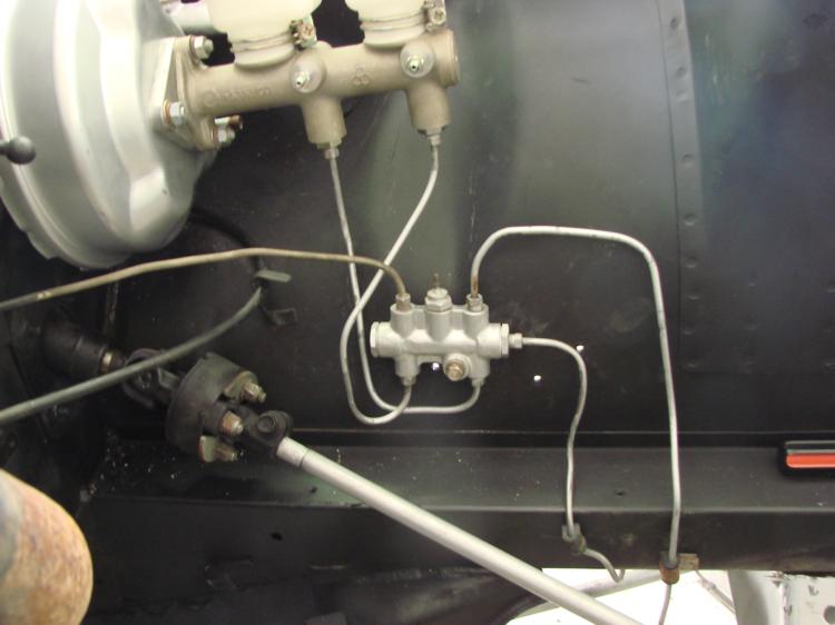

December 13, 20159 yr comment_482829 One thing with using an aftermarket Proportioning valve that needs to be mentioned. You have to remove the factory metering/proportioning valve. You should not run both together. Doing so can result in a long, soft pedal and inadequate pressure to the rear brakes. So remove the factory valve completely, then connect the front brake lines together with a Brass tee. Plumb the WilWood Prop valve on the rear brake line in a convenient location. Edited December 13, 20159 yr by Chickenman Link to comment https://www.classiczcars.com/forums/topic/52935-wilwood-superlites-pulling-right-and-sometimes-left/?&page=2#findComment-482829 Share on other sites More sharing options...
December 15, 20159 yr Author comment_482967 Thanks, Chickenman, I was thinking about this, too. I didn't put these brakes in, so I assumed the previous owner took the stock valve out when he did the brake swap and removed the emergency brake, etc....but I better check to make sure. It's in the rear on a 1971 yes? Would it be under the car? Also, do you know what it looks like? I'm assuming it's bigger than just a "T"? Also, spoke to Don again at Design Pro and we have some new seals, etc. picked out. Looks like Santa's going to bring some refreshed brakes this year! Link to comment https://www.classiczcars.com/forums/topic/52935-wilwood-superlites-pulling-right-and-sometimes-left/?&page=2#findComment-482967 Share on other sites More sharing options...
December 16, 20159 yr comment_483023 Edit: Yes, the proportioning valve is in the rear on a 1971. Edit: ( Original info incorrect ) The stock " Metering " valve is located under the Master Cylinder. It's often called a " Combo " valve as it is both a brake pressure metering and a brake failure warning valve. Here is a picture of the stock valve in the stock position. Note: Depending on year of car, front and rear reservoirs on Master Cylinder may be reversed. On this model, the reservoir closest to the Brake Booster is the front brakes and the reservoir farthest from the Brake Booster is for the rear brakes. Edited December 18, 20159 yr by Chickenman Link to comment https://www.classiczcars.com/forums/topic/52935-wilwood-superlites-pulling-right-and-sometimes-left/?&page=2#findComment-483023 Share on other sites More sharing options...
