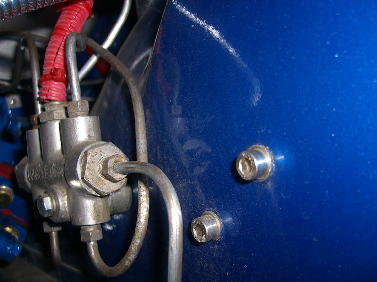

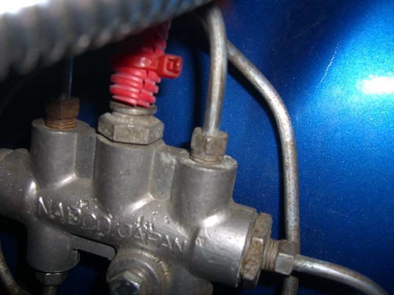

Chickenman, thanks for the photo...I thought it would be under the car in the back somewhere somewhere. And, now I'm a bit worried as I think this stock "control" valve might still be under the hood. I certainly don't need it AND the Wilwood proportioning valve in the cabin I don't think. I'll have to run home and check...interesting. I'm hoping if it is there, there's an easy way to eliminate it without causing all kinds of leaks, etc. Has anyone done that and have a photo? I'll see what's under the hood tonight!
Edited by z boy mn

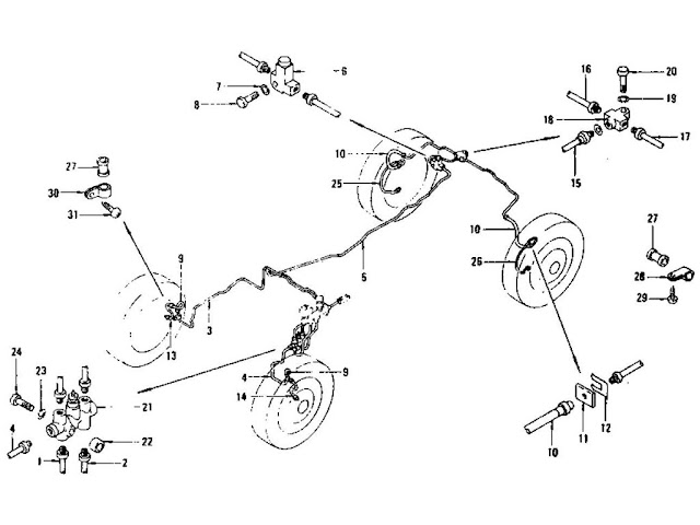

It's real easy to eliminate. Use a brass union ( Metric thread of course ) to couple the two rear lines together and a Brass Tee to join the three front lines together. The hardest part is finding a brass tee fitting with the proper Metric threads. But they are available. ,

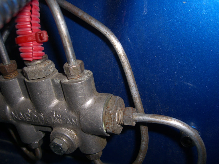

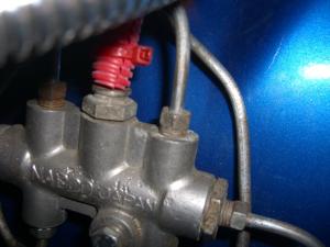

1971 has the proportioning valve in the back.  Later cars have it up front.  The thing in Chickenman's Post 24 is  the warning light switch.  John Coffey says that they get stuck sometimes.  But it doesn't meter pressure or flow, it just shows when there's a an imbalance.  All described in the manuals.
It's been proposed that the warning light switch might have some sort of protective block-off function, and I used to have that in mind for a while but you can see that if that was so you'd never be able to bleed the brakes once the switch moved over.  It does stop moving mechanically to allow the "good" side to build pressure.  The "fix" for the switch when the light goes on is to bleed the brakes to get the pressure balance back.
You are indeed correct. My bad. ( I've edited post #24 ).
The Brake warning valve can probably be left in place.

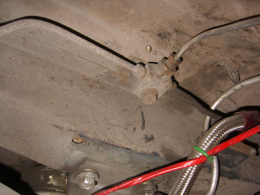

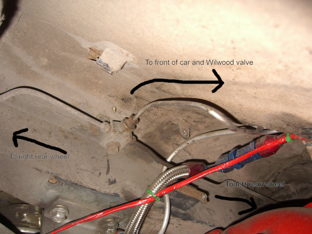

Up to June 1972 has the proportioning valve in the rear. This has to be removed and replaced with a straight union. Item #6 in picture:
Edited by Chickenman

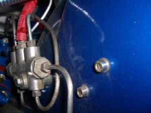

Thanks for the update, everyone, though I'm more confused than ever in some ways. No doubt it's a 1971 model, made in 12/70, but it's had a lot of work done including the Wilwood brake upgrade. So, my plan is to take photos of both places and post them here this weekend to make sure I know what I'm looking at and what needs to get replaced if anything. For example, do I need a brake warning light switch? All the gauges have been replaced, so I'm not sure what it would go to or what would light up if the switch triggered something. Seems like extra hardware. I'll take photos of what I find inside the hood and in the rear and see what you all think. Glad to hear that things are simpller to eliminate than I first thought, though, if that's what needs to be done in the end.
OK...so, I took some photos last night and here's what I have. I think it looks like I have the warning light switch and no proportioning valve, but I'd like to confirm.
For the record, there is no valve assembly on the firewall and the line headed to the rear stops in the cabin at the Wilwood proportioning valve and then continues back to the "splitter" in front of the spare tire well.
I think I can see where maybe there was another valve there...so maybe that was where the proportioning valve used to be. This looks like just a splitter to me, but let me know what you think!
