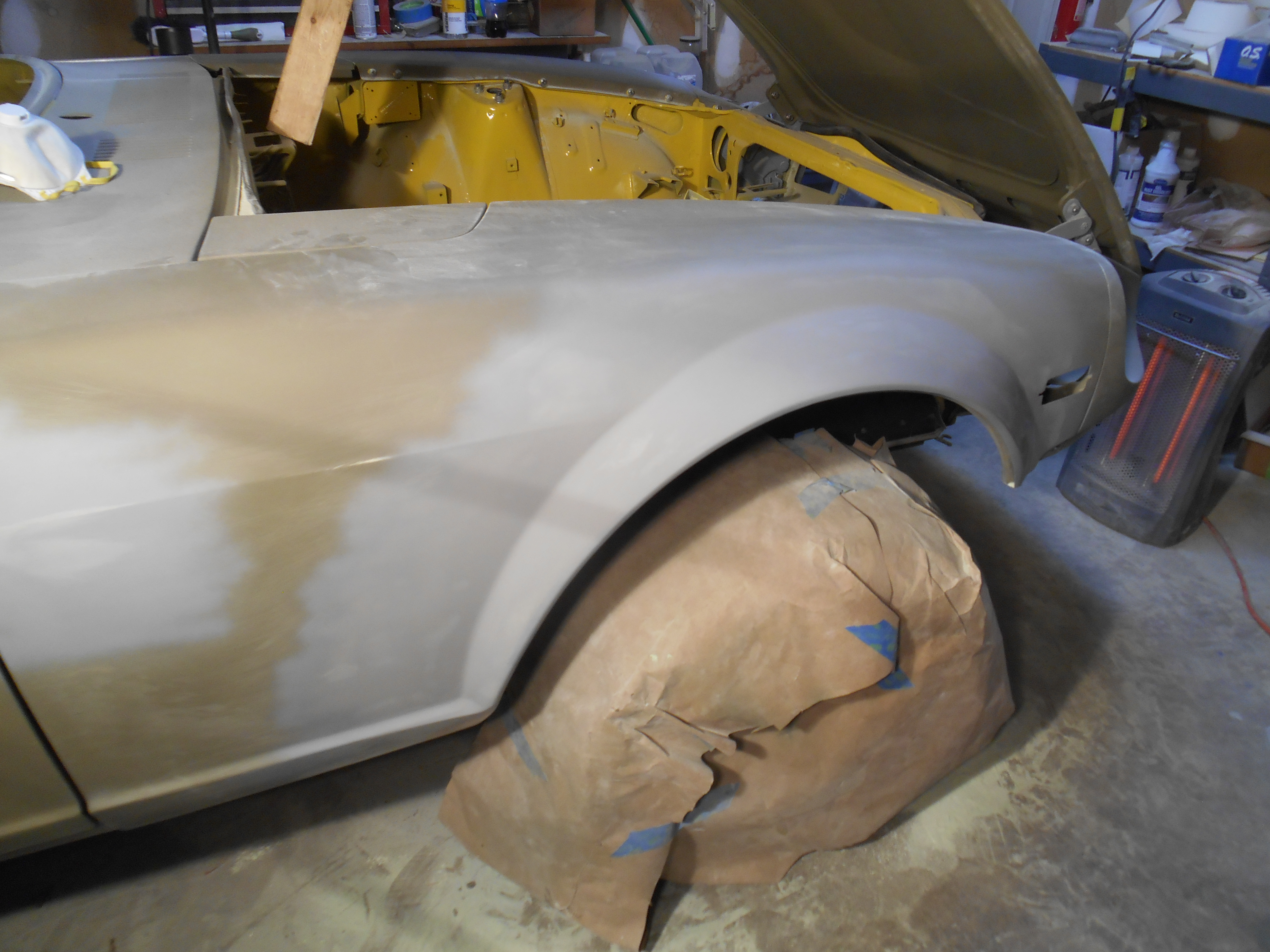

Good progress. Are you gonna shoot another coat of primer before finish paint?
Yes, several.  The body work is far from finished.  I've done the "gross" filling.  I still have a lot of detail work to do.  Too many imperfections to list.  The goal in this phase was to get everything about right and under an etching primer.  I have a grey high build primer that will go on before the color coat.  I'm sure there are still some low spots and a lot of scratches and other minor blemishes to fix.  I'm not completely satisfied with the panel alignment either.  I can live without a perfect 5mm gap, but some panels are still higher or lower than their neighbors.  That I want to fix.

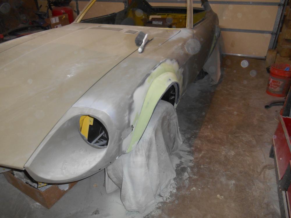

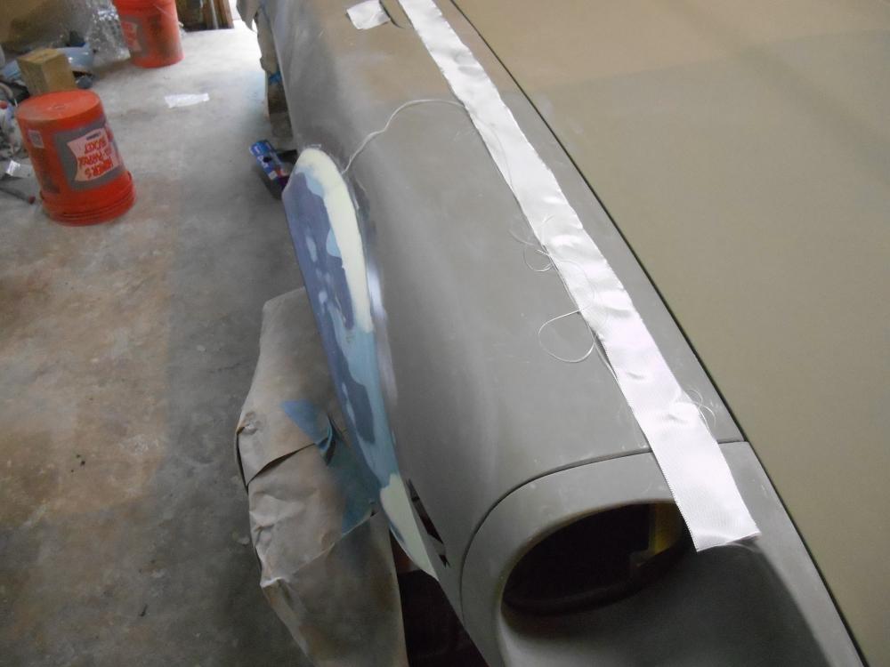

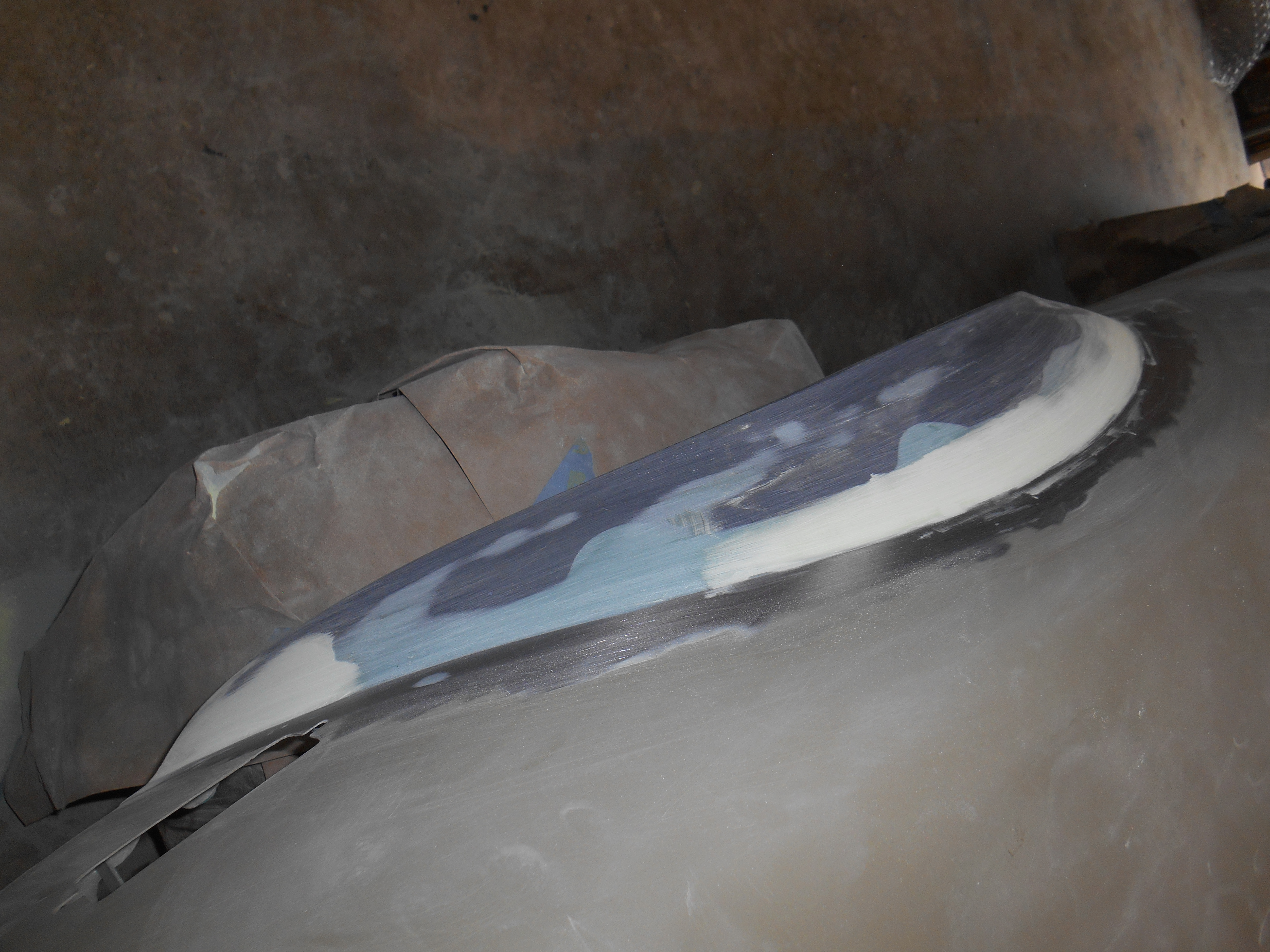

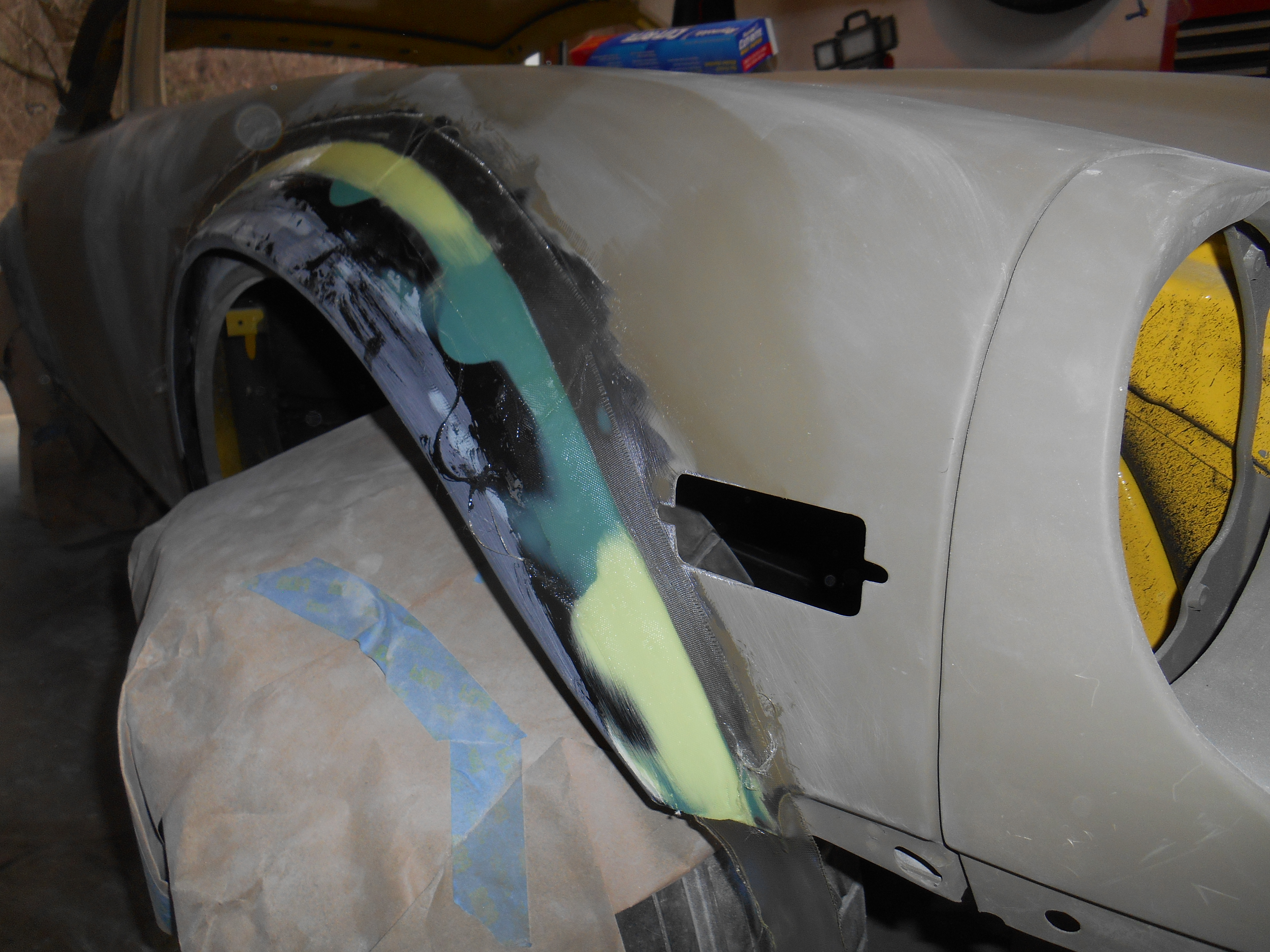

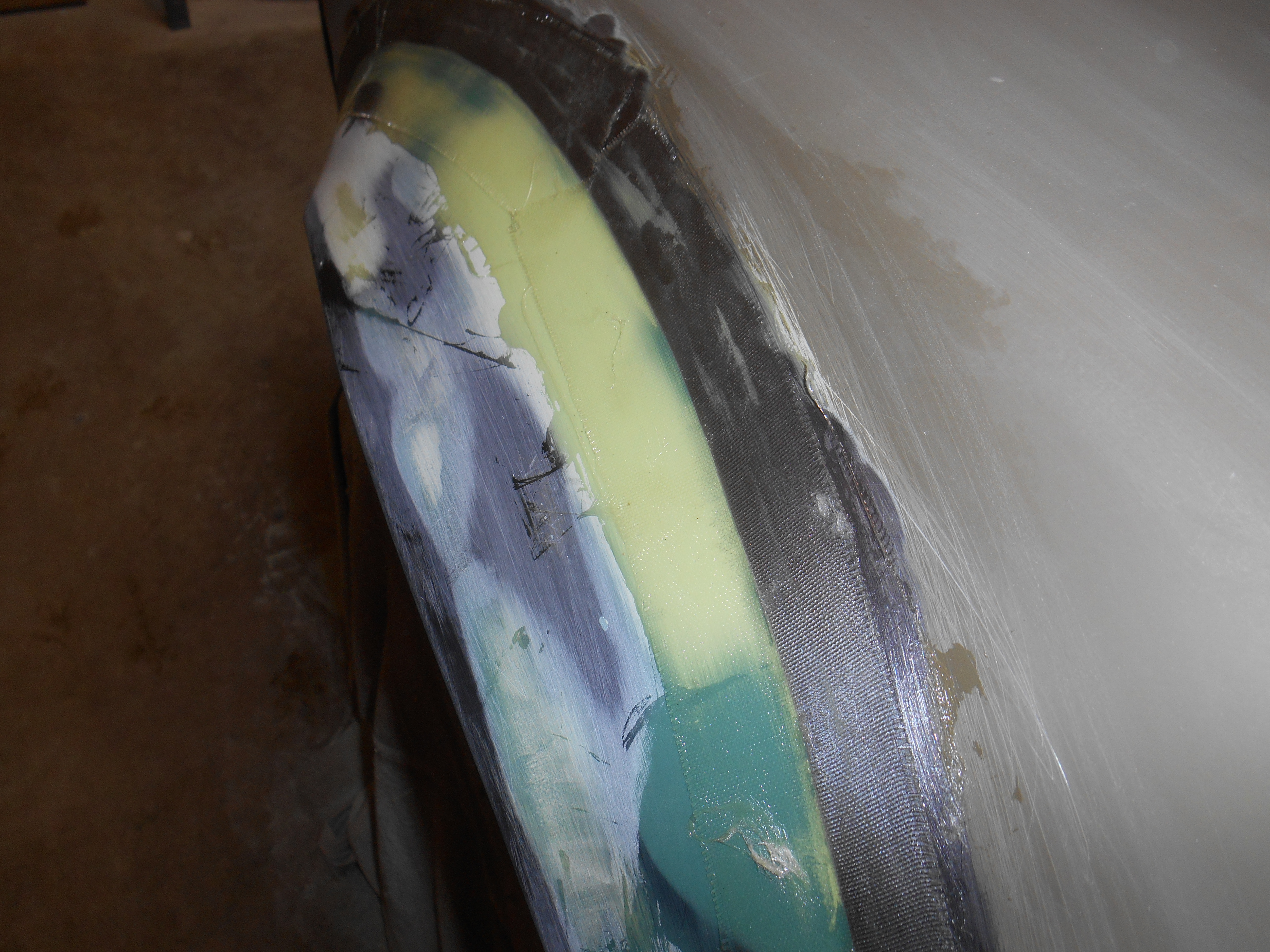

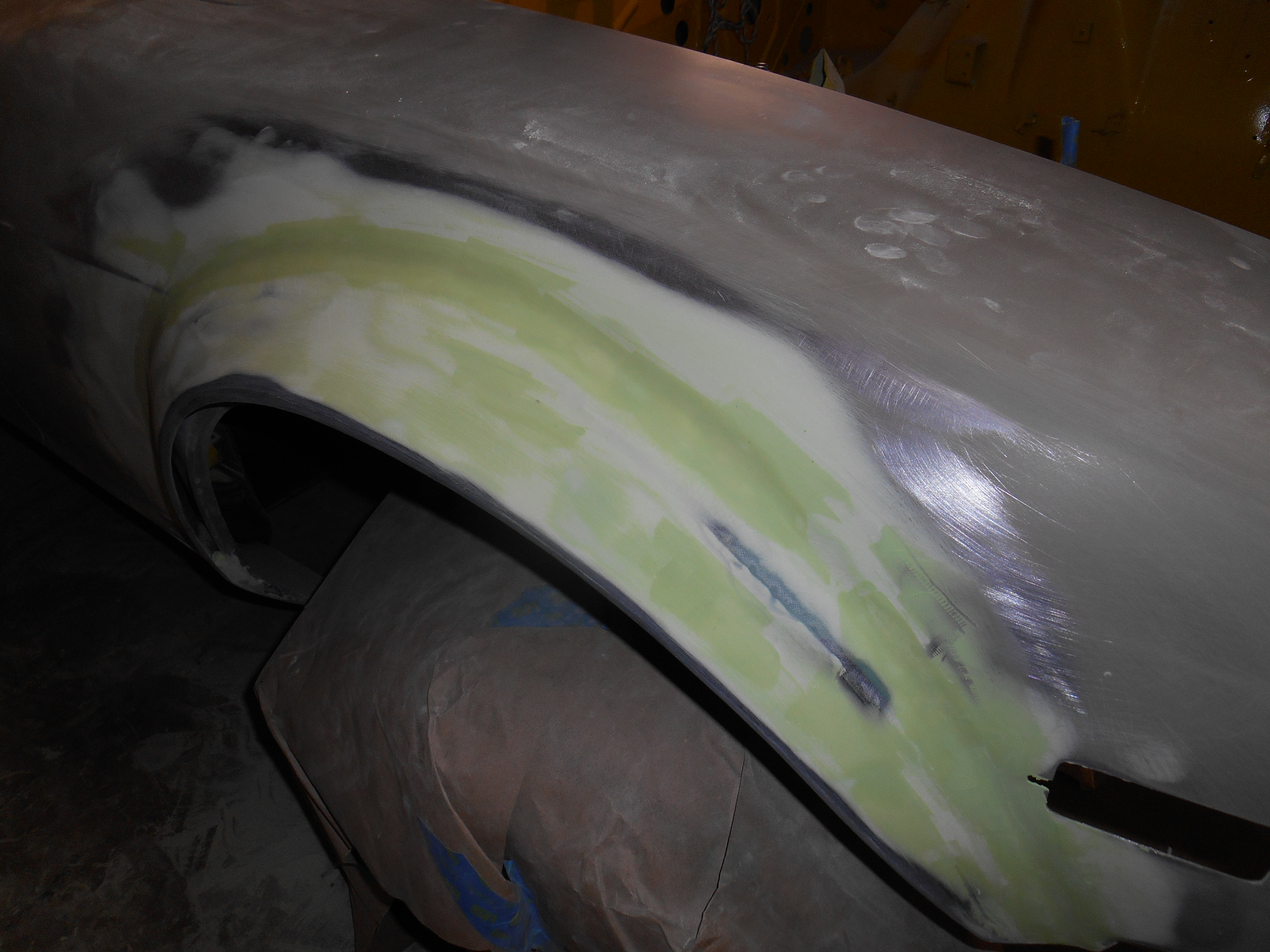

I'm still woking on the fender flares.  I have to admit the holidays and a bit of car apathy slowed me down some.  I have fiberglassed the front flares and am doing the final bit of blending.  I'm struggling a little getting a good line where the flare meets the body.  If anyone can suggest some good techniques I'd be grateful.  I want a good consistent radius both where the flare meets the body and around the wheel that is free of high and low spots, but I haven't found a good blocking method yet.  I don't like my round durablock very much and because it rigid it can't create a consistent radius on a round flare.
DSCN0847.thumb.JPG.b697e39543edfbe712e24DSCN0848.thumb.JPG.e965e388626b0e9c02e53DSCN0849.thumb.JPG.ad9dd8ec1b7d113fb253aDSCN0850.thumb.JPG.7ca4dee35524b9cf4a14fDSCN0851.thumb.JPG.01e885b1843dca216d9cbDSCN0852.thumb.JPG.260e923cb3e4e483a42ccDSCN0853.thumb.JPG.a3689c54cba220d98eb99DSCN0854.thumb.JPG.325a28a0aba5b9029c721

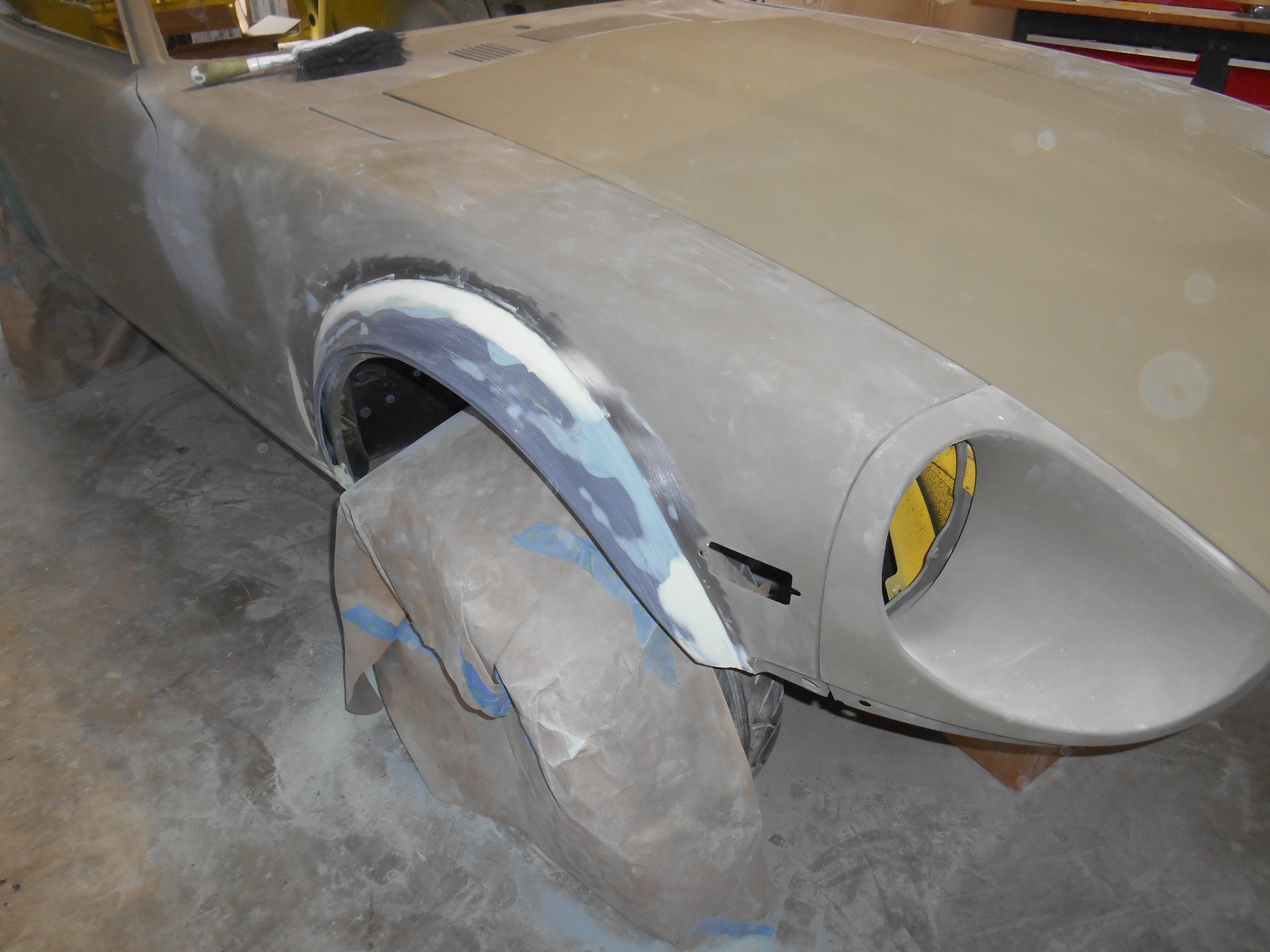

I'm making progress on the fender flares.  A lot of filling sanding, filling, sanding, etc.  I think I finally have the shape about how I want it.  There's still some detail work but this was more or less what I was after...
DSCN0860.thumb.JPG.009eb774bcff63c9fe0beDSCN0861.thumb.JPG.df9b6462faf8574ac39e1
