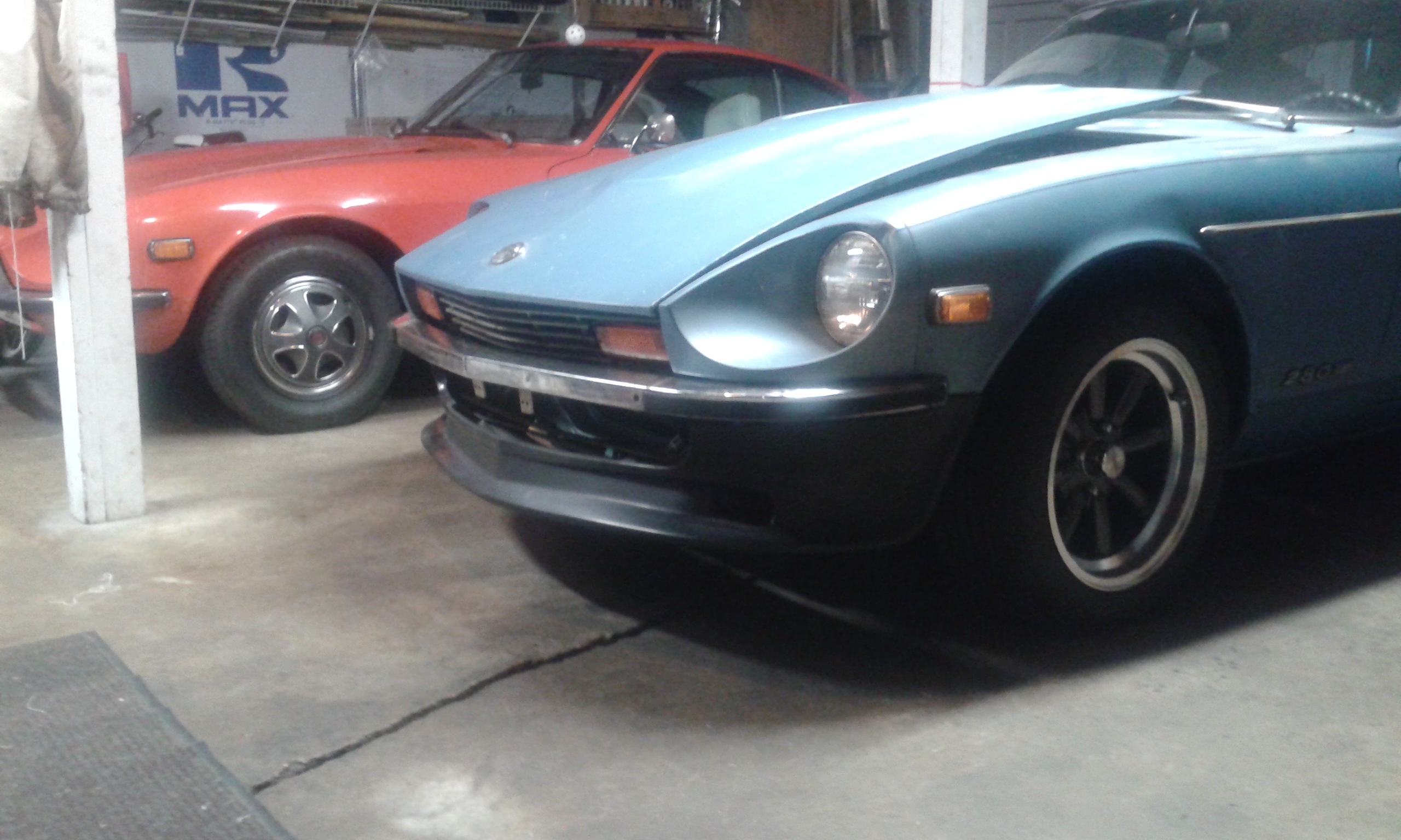

February 17, 20178 yr comment_513183 I know yall have 280s but just to be taliking, I like the 15's better myself. The 16's are a bit too big on my color cars. They look awesome on some better colors, dark green and yellow cars are my favorites with the full wheel well the 16"s provide. Here's some random pictures I have uploaded. 240 with 16" Rewinds Blue 280 with 16"s, previous 240 with stock 14" set up. 280 and 240 with 14" wheels and tires. Link to comment https://www.classiczcars.com/forums/topic/53025-best-currently-available-dry-tire-for-15x7/?&page=3#findComment-513183 Share on other sites More sharing options...

February 18, 20178 yr comment_513210 On 12/27/2015 at 4:29 AM, siteunseen said: I've got 15" Koning Rewinds from Direct Tire with Hankook Ventus 205/50s and love them. $560 after all the rebates, great deal to me. 15s on the orange one, 16s on the red. I prefer the 15s on a 240. The 16s are on my 280 now. site, what spring kit are you running on both of yours? I like how they sit. I am planning going new Eibach's on mine. Or maybe Vogtland springs. The ones I have now are just way too harsh for the street. My tooth fillings are comeing loose. Link to comment https://www.classiczcars.com/forums/topic/53025-best-currently-available-dry-tire-for-15x7/?&page=3#findComment-513210 Share on other sites More sharing options...
