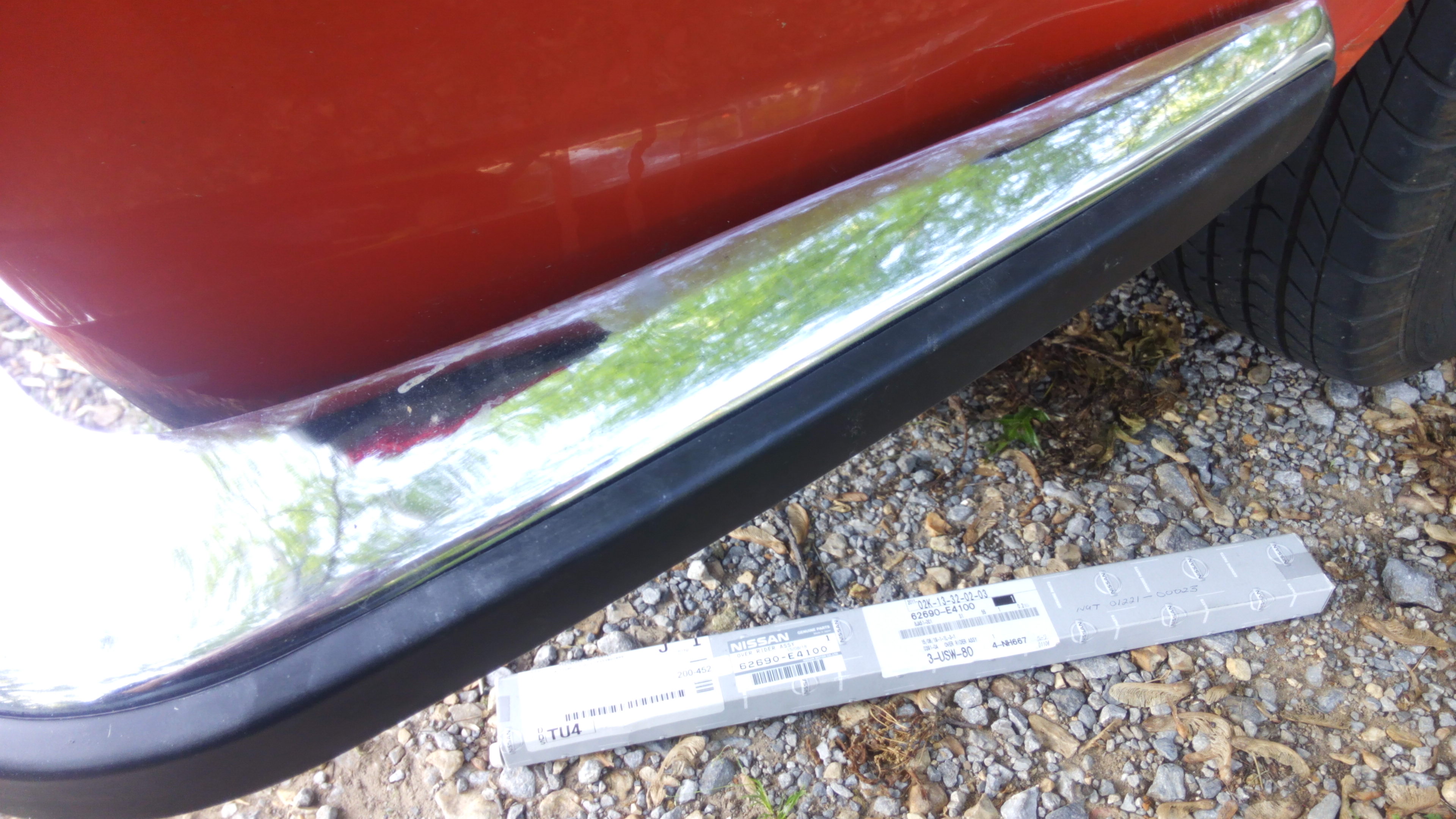

  On 5/7/2016 at 12:31 AM, S30Driver said:
Replaced all my weathered front & rear bumper rubber with new OEM nissan,  :)
Expand
I bought a set for my 72. The fronts are too short and the rears were too long. I don't know what's going on.
I did put the rear on by drilling new holes further down past the old rubber holes.
Front is still in limbo.

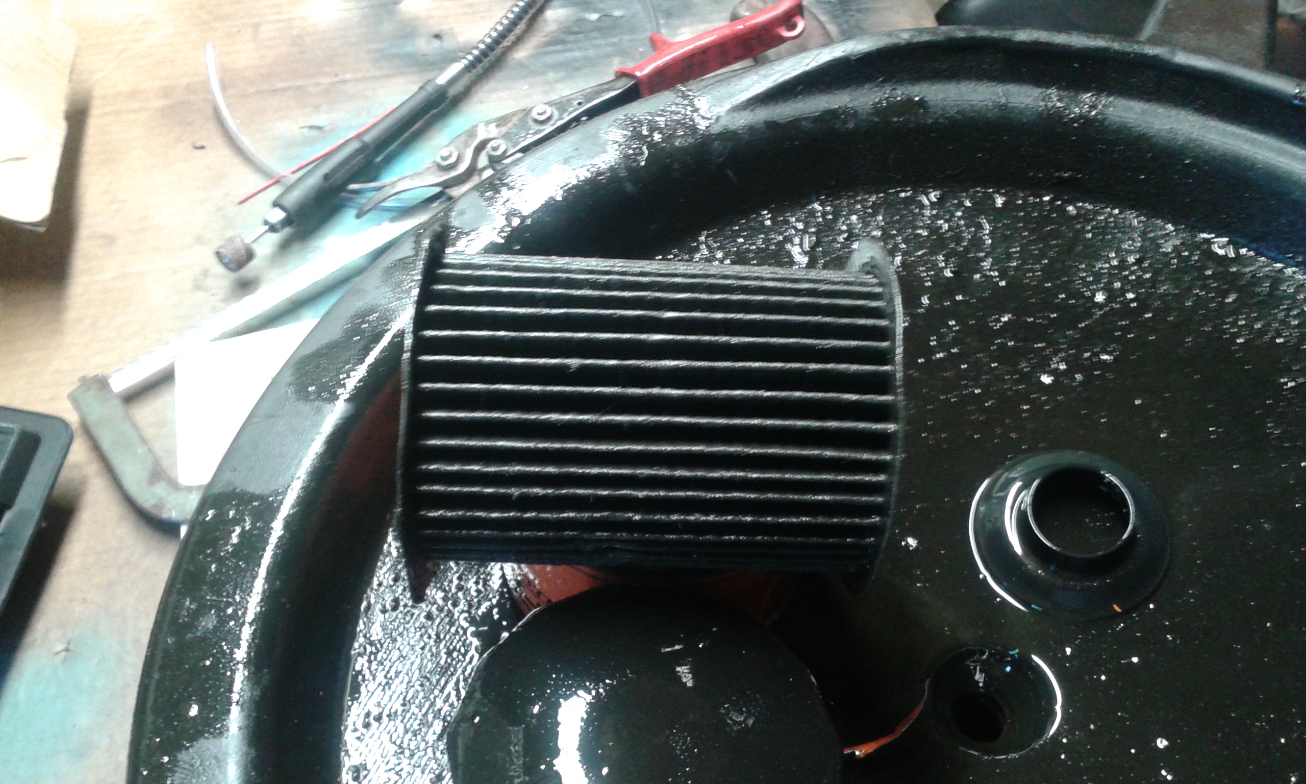

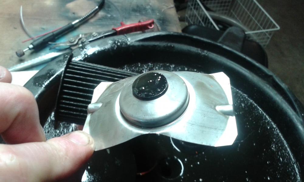

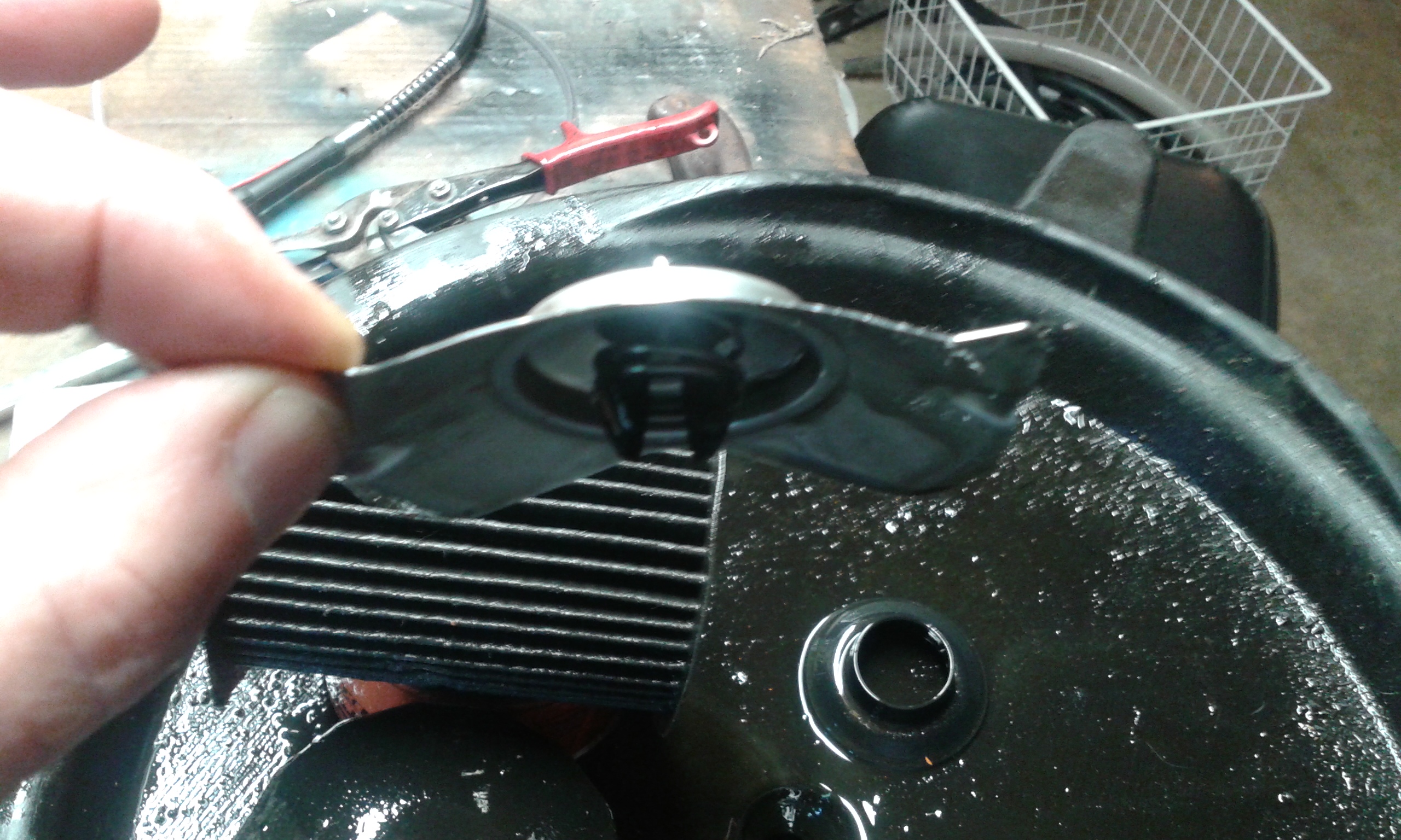

Changed out the break in oil, looked good. Cut the filter and it looks good. I was expecting timing guide pieces that thing is so tight. 8^)  I went with Quaker State Defy 10-30. It claims 1200 zdpp? same as vr1 but 5 quart jug at walmart was only $15.
I'm guessing the anti flowback vales have changed from the rubber flap and now are on the $4 frams?  I guess that is what this is, I've not seen that before.
