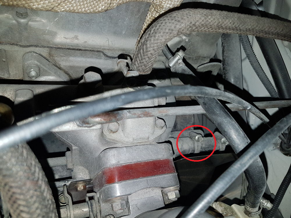

December 27, 20168 yr comment_509044 So bottomline. Will my car performance be affected if i remove the Manifold Heat Control Thermostat considering that the temperature in Panama is 33°C as i already removed it and plugged the lines as shown. Problem is that now the car takes longer to warm up and need to leave the choke longer. I was having fuel percolation issues and needed to be able to use the car in traffic jams without stalling issues. Link to comment https://www.classiczcars.com/forums/topic/53091-intake-manifold-thermostat-how-do-i-check-it-and-service-it/?&page=3#findComment-509044 Share on other sites More sharing options...

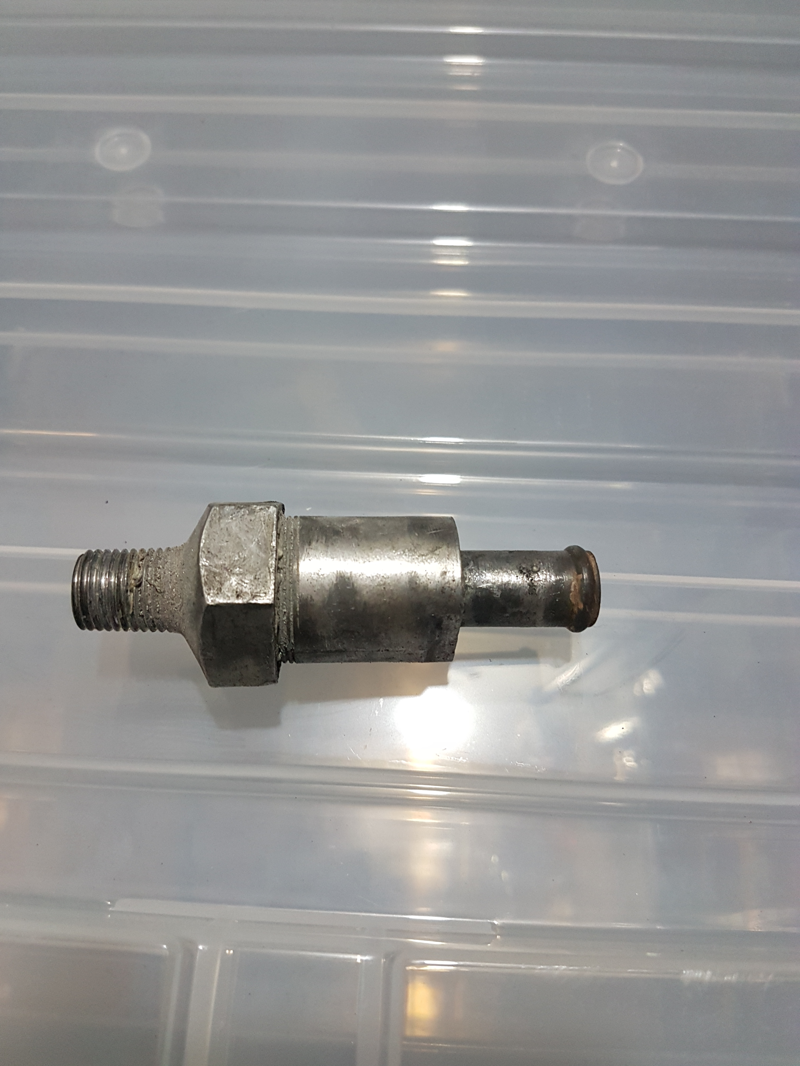

May 28, 20177 yr comment_521895 Switched from e88 intakes to n33's also new header. Noticed the manifold heat control thermostat. Opened it up and saw that it was a thermostat. It's been two weeks since the rebuild. Runs amazing. But after warm-up get an occasional studder on take off. Could a stuck open manifold thermostat cause the hesitation on take off? Link to comment https://www.classiczcars.com/forums/topic/53091-intake-manifold-thermostat-how-do-i-check-it-and-service-it/?&page=3#findComment-521895 Share on other sites More sharing options...
