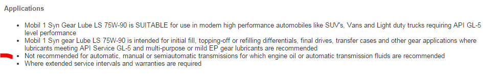

January 11, 20169 yr comment_484370 Direct from Mobile 1 Product Data. No mention of this being recommended as a manual transmission fluid. It is recommended as a Rear end differential oil only. No mention of it being " Yellow Metal " compatible.... and that is the important part. Quote Mobil 1™ Syn Gear Lube LS 75W-90 Supreme Performance Synthetic Multi-Purpose Automotive Gear Lubricant Product Description Mobil 1™ Syn Gear Lube LS is a supreme performance, synthetic, multi-purpose, SAE 75W-90 automotive gear lubricant designed to help meet the highest level performance requirements of modern passenger vehicles in all types of operating conditions including limited slip applications, as well as, deliver outstanding power transfer performance. Compared to conventional hypoid gear lubricants, Mobil 1 Syn Gear Lube LS 75W-90 performs exceptionally over a wide range of temperatures. Mobil 1 Syn Gear Lube LS 75W-90 achieves this through a unique proprietary formulation, that deliver optimized viscosity-temperature properties together with the highest level of inherent formulation stability and helps to protect against thermal and oxidative degradation, wear and corrosion, viscosity loss associated with premature shearing. It also can be used in extended service and for aiding in fuel economy performance. Features and Potential Benefits Mobil 1 Syn Gear Lube LS 75W-90 combines wax-free synthesized hydrocarbon base oils and a specially designed extreme-pressure, limited-slip, sulfur-phosphorous additive system to help provide a significantly higher level of performance in rear axles and differentials versus conventional fluids. Great film strength at higher operating temperatures, reduced fluid friction and low-temperature application down to -50ºC helps to provide significant advantages versus conventional mineral oil formulations. It helps to reduce wear and spalling under the high speed, high torque and high horsepower conditions in competitive racing and high performance automobiles. This unique, high technology final drive gear lubricant has demonstrated outstanding performance including fuel economy, extended drain, long-term friction retention, low-temperature capability and improved differential/axle durability and cleanliness. Key features and potential benefits include: Edited January 11, 20169 yr by Chickenman Link to comment https://www.classiczcars.com/forums/topic/53096-gl-4-vs-gl-5-gear-oil-in-transmission/#findComment-484370 Share on other sites More sharing options...
January 11, 20169 yr comment_484371 Further research from BobIsTheOilGuy.com. Answer from Mobile about using Mobil 1 Syn Gear Lube LS 75w-90 in manual transmissions with Yellow metals. Specifically Brass and Bronze synchros: Quote Question: Clarify Comments on Use of GL-5 vs. GL-4 Gear Oil Concerning the GL-5 gear oil, on your website you state the following: "Mobil 1 Synthetic Gear Lubricant LS 75W-90 can also be used in rear axles where API Service GL-4 lubricant is recommended." However, you also say in this "Ask Mobil" section that: "Mobil 1 Synthetic Gear Oil is recommended for all applications where a GL-5 lubricant is specified. GL-5 type lubricants, which have a higher level of additive chemistry, can be corrosive to yellow metals such as copper, brass, etc., and in these applications a GL-4 product is usually specified." Can you clarify this disconnect here? Thank you. -- John Goetz, Newport News, VAAnswer: There are transmission applications that recommend API GL-4 type products where we would not recommend using an API GL-5 fluid because transmissions typically have components made from “yellow” metals. However real axles where GL-4 fluids are recommended do not have “yellow” metal components. As a result, the application of an API GL-5 fluid is acceptable. Top http://www.bobistheoilguy.com/forums/ubbthreads.php?ubb=showflat&Number=3062144 Link to comment https://www.classiczcars.com/forums/topic/53096-gl-4-vs-gl-5-gear-oil-in-transmission/#findComment-484371 Share on other sites More sharing options...
