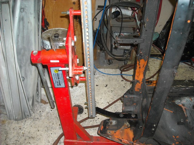

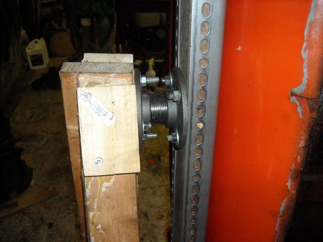

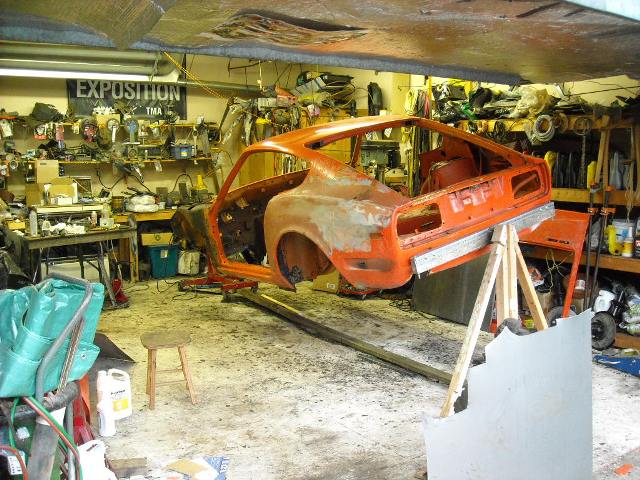

I'm on the same page, looking to built my own as well. I'm actually debating about just building a body stand rather than a rotisserie.  Here's some pictures I've acquired throughout my travels & planning.  Sounds like the cheapo harbor freight engine stands need to be increased in height to allow for full rotation.  I've also seen some cheapo wooden rollers but that doesn't look too stable.

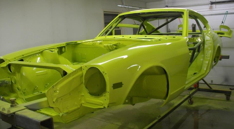

Here's a pic of mine. I forget the name but it's a pretty good one. Put the car on jack stands, attach rotisserie to bumper mounts and then raise each end of the rotisserie. It works very well. The brackets are meant for Mopars but I drilled an extra hole in the front mounts and made adapters for the rear.
Chuck
A friend of mine built one out of square channel and angle iron. It works good and mounts to the factory bumper shocks on the 280... A little high for centre of gravity but manageable.

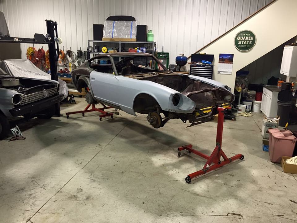

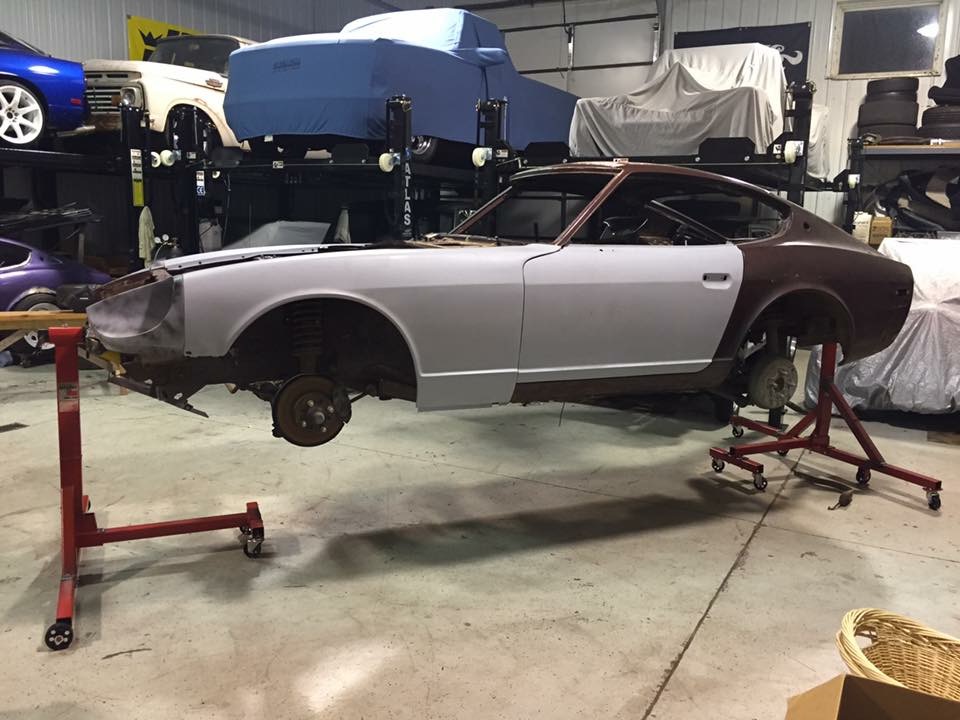

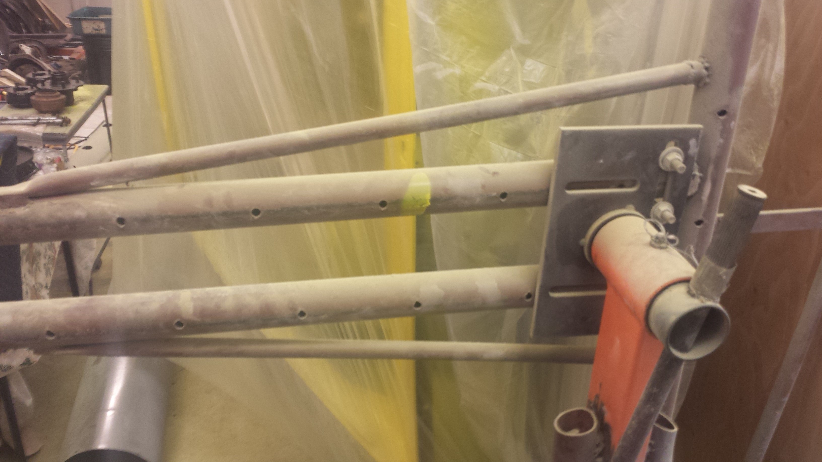

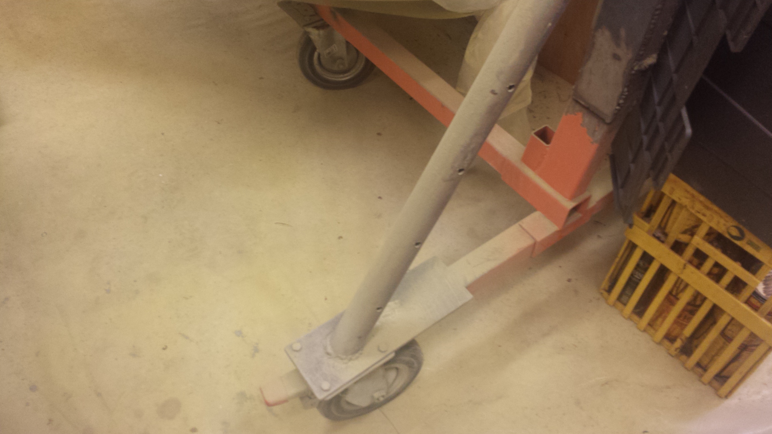

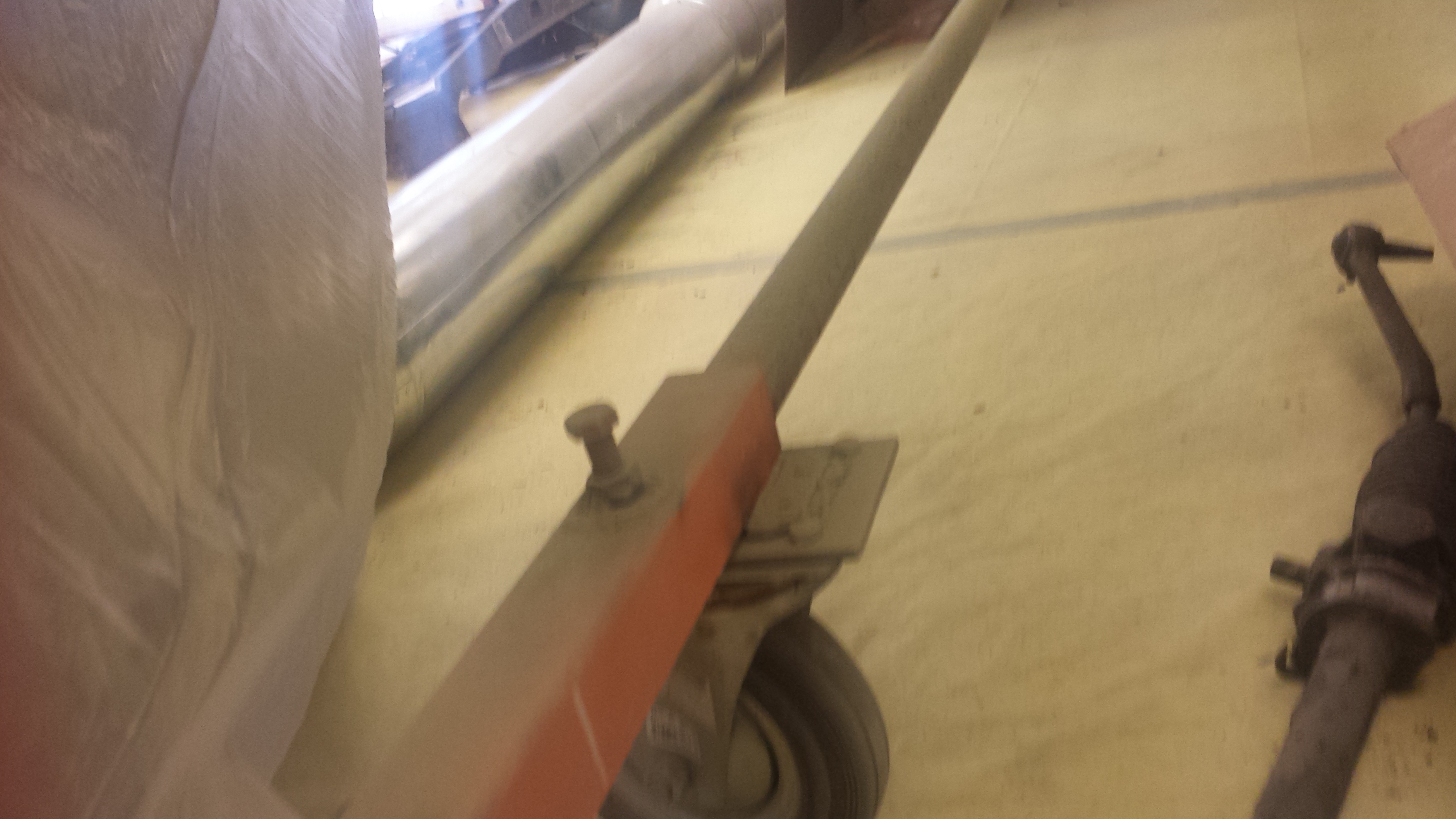

I built a rotisserie out of 2 harbor freight engine stands, large HF casters, some steel plate and an old trampoline frame. I priced some steel to build it from scratch but the steel was so expensive it wasn't practical. I added plates to make the stands wider and give me a place to mount the larger wheels
20160122_145532.thumb.jpg.8ce10728e7c041
You can also see where I extended the frames to make them taller so the car could rotate fully.
The two vertical pipes that are on each end are held by u-bolts throught the engine stand. So the car can be raised or lowered to get it to the proper balance point.

The car is turned sideways because the shop is full of stuff. The car is very neutral and can easily be spun with one hand. You can use the pin on the engine stand to hold the car in any orientation. When I go to set it down on it's wheels, I can loosen the u-bolts and slide it down until it is close to the ground

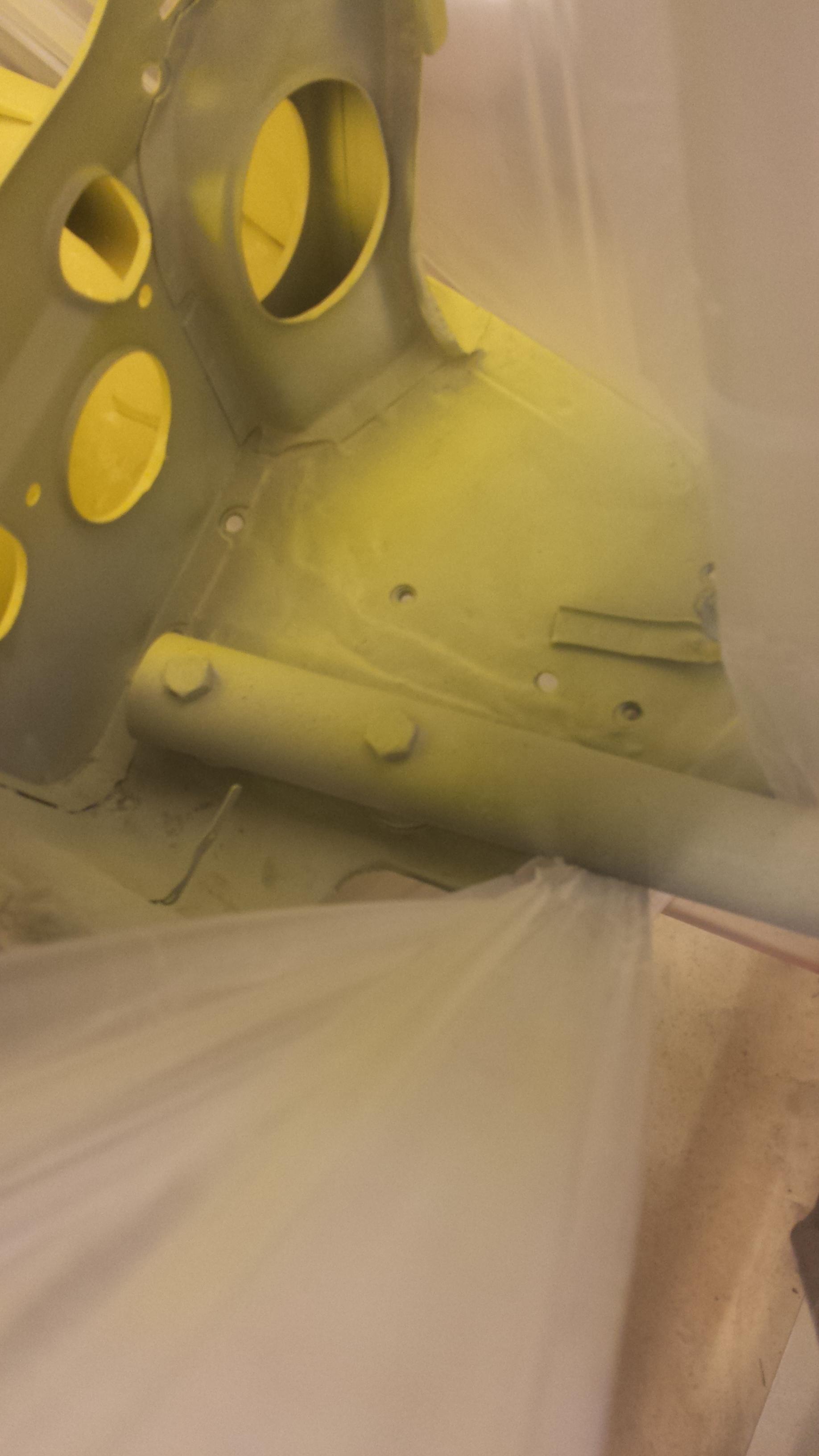

I bolted through some pipes to where the bumpers mount. You could do something similar

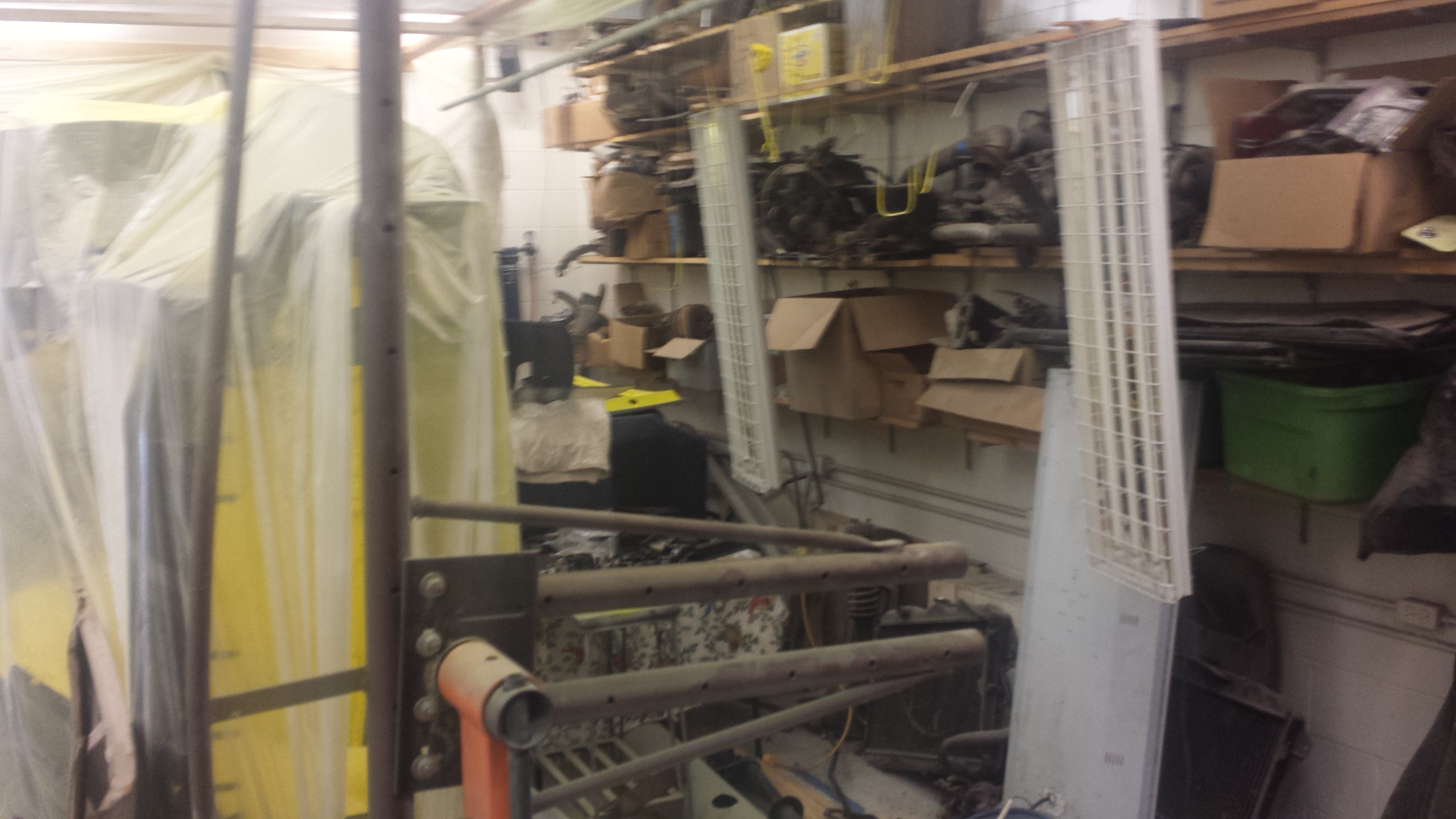

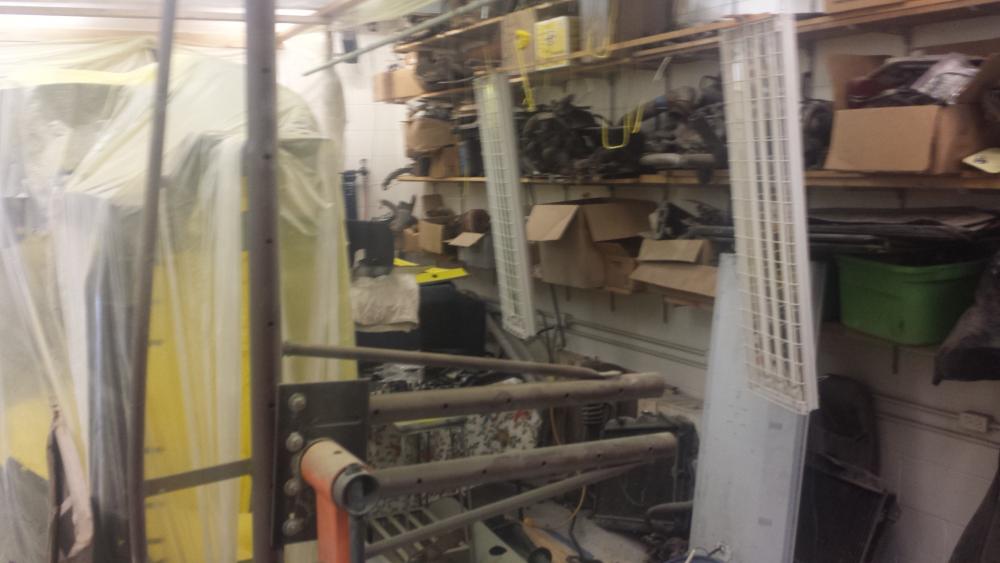

I ran a pipe from one stand to the other with a large bolt for a set screw so the stands are tied together , so they don't stress the chassis. I wasn't too worried about the car falling on me because a stripped Z is pretty light.20160122_145632.thumb.jpg.a667adb27c93a4
I did mine on the cheap and it was perfectly safe, however, the 2 engine stands MUST be connected together at the bottom or you are just asking for trouble.
