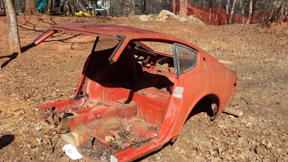

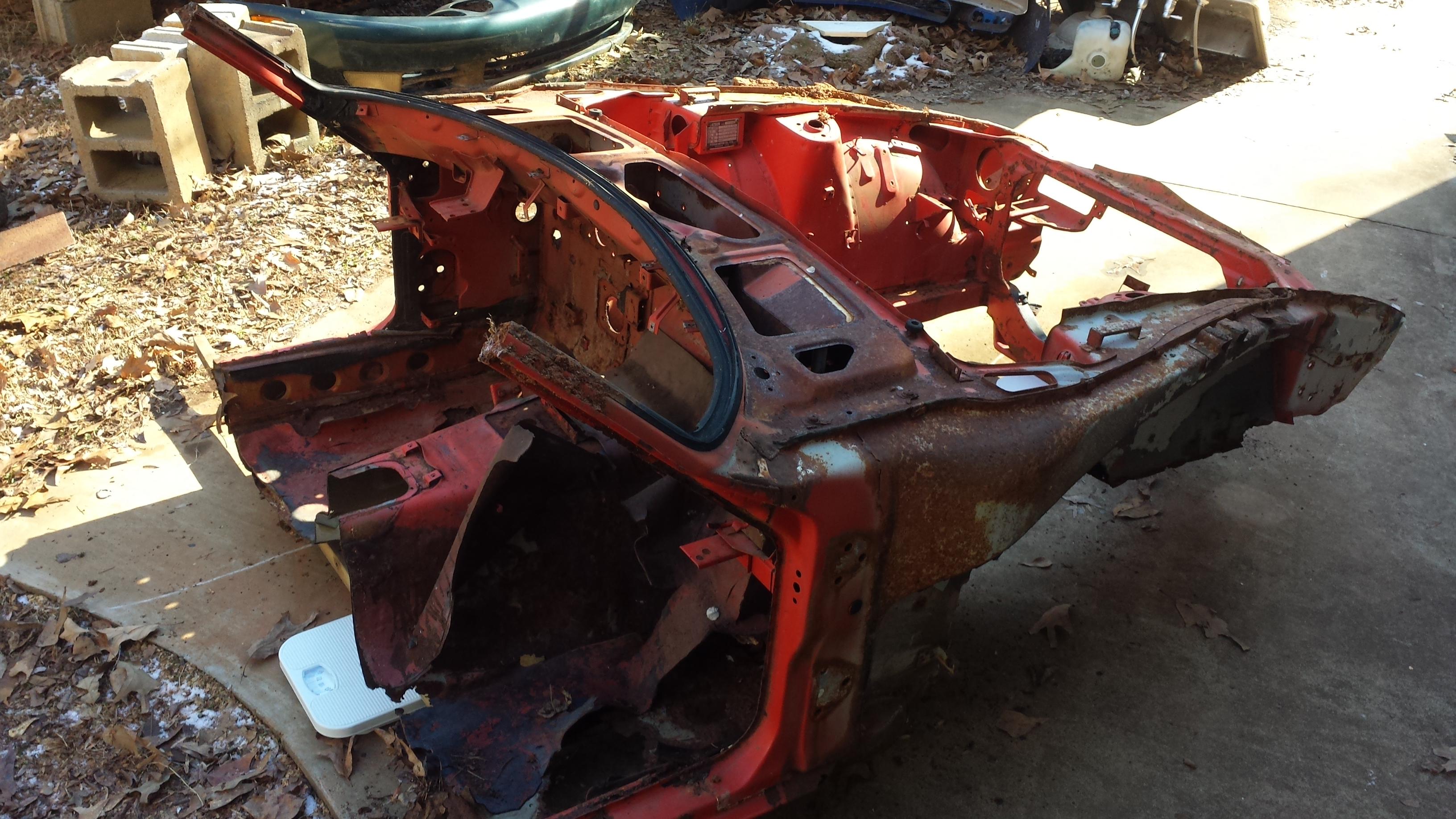

February 13, 20169 yr comment_486450 This chunk weighs right at 200#'s. I bought 2 cheap scales to keep in the shop. This chunk weighs 389#'s with a little bit of misc weight, glassless hatch, qtr windows, etc. So a 76 stripped chassis is a little less than 589#'s whole. A 240z would probably be a little lighter but probably not a lot. Link to comment https://www.classiczcars.com/forums/topic/53168-rotisserie-advice/?&page=3#findComment-486450 Share on other sites More sharing options...
February 13, 20169 yr comment_486451 ouch... talk about "splitting the baby" Link to comment https://www.classiczcars.com/forums/topic/53168-rotisserie-advice/?&page=3#findComment-486451 Share on other sites More sharing options...
February 13, 20169 yr comment_486452 Price on front section shipped... Link to comment https://www.classiczcars.com/forums/topic/53168-rotisserie-advice/?&page=3#findComment-486452 Share on other sites More sharing options...
