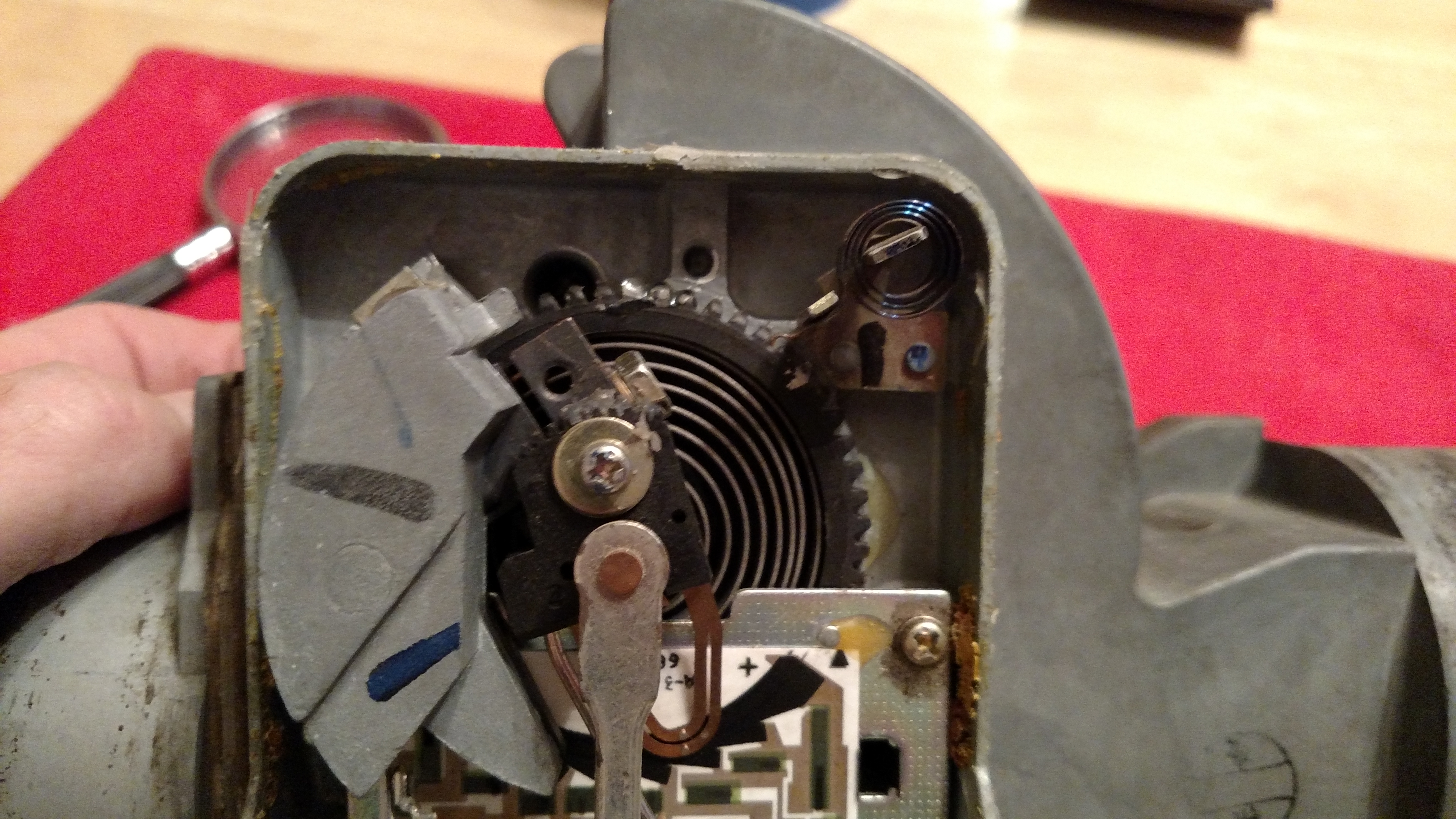

February 13, 20169 yr Author comment_486426 Progress. It runs! Sort of. I removed the AFM, and after opening it, realized it had been messed with. The glue blob on the locking screw was broken. And it looks like the black gear has been adjusted 6 teeth clockwise from where it should be. At least that's what the white marks on the body of the AFM and the black gear seem to indicate (see photo). I went through the electrical tests, and found that the fuel pump cutoff circuit was intermittently open. A quick pass over the contacts with some emery paper and alcohol fixed that. Everything else on the AFM checked out fine. The air passage was dirty. So I cleaned it. I decided not to attempt any adjustment of the black gear yet. Anxious to see if that fixed it, I reinstalled the AFM and started the car. As long as I gave it enough throttle to maintain 2000rpm or more, it ran. But it sputtered and smelled sooty like it was running rich. I tried the "fingering" test with the AFM to see if I could effect the mixture. But it didn't seem to make any difference. I ran it for about 15 minutes, letting it warm up. I'm not sure why I did that, other than in the hopes that running that Star Tron through the injectors might clear things up. It didn't. Still, now that I can get it to run, I've eliminated fuel pump and ignition as the source of the issue. Now I can go through the troubleshooting process to get it tuned. Tomorrow, I pull the wheels and get them re-shod. EDIT: I just noticed the last several posts with good ideas for easy stuff to check. I'll test for vacuum leaks and bad connections tomorrow. I'll also look at the plugs and see what that tells me. Be patient with me. I've not spent much time tuning pre-OBD cars. Stay "tuned", lol. Edited February 13, 20169 yr by the_tool_man Link to comment https://www.classiczcars.com/forums/topic/53262-new-owner-of-77-280z-from-upstate-sc/?&page=3#findComment-486426 Share on other sites More sharing options...
February 13, 20169 yr comment_486433 Don't know for sure if your 6 teeth is adjusted to the lean side or not. I think that it makes it lean, tightening the spring. Could be that somebody was trying to fix the rich condition by leaning out the AFM. Pushing the vane in adds fuel, so all you were doing was making it even richer. The first impactful thing you'll want to do is to measure the resistance of the coolant temperature sensor circuit, at the ECU connector in the cabin (Pin 14 to ground?). Compare the resistance you get to the temp. v. ohms chart in the EFI Guide or the Engine Fuel chapter. If it's too high, or even open, the ECU will add a bunch of fuel, because high resistance means cold. If that number is in range, check fuel pressure (check it anyway), and check the color of your injectors. Sometimes people think that installing turbo injectors will add turbo power. They should be light green or tan, not purplish-brown. Found it - Link to comment https://www.classiczcars.com/forums/topic/53262-new-owner-of-77-280z-from-upstate-sc/?&page=3#findComment-486433 Share on other sites More sharing options...
February 13, 20169 yr comment_486435 Unfortunatly its very common to find the afm has been messed with. I have three spares and the one in the car the same. All but one had the lids glued in place and looked like they were untouched. They probably adjusted your afm to lean out the rich running problem. Its more than likely why they parked it. It could be a number of things causing rich running. The temp sensor is a good place the start. Leaking injectors or a csv (cold start valve) stuck open or leaking badly. A fuel gauge will tell you a lot about the fuel system. Its also handy to have enough fuel line so you can strap the gauge the a windscreen wiper to check it while driving. Link to comment https://www.classiczcars.com/forums/topic/53262-new-owner-of-77-280z-from-upstate-sc/?&page=3#findComment-486435 Share on other sites More sharing options...

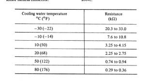

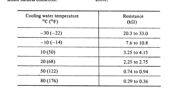

February 13, 20169 yr Author comment_486460 First, I visually inspected all of the vacuum hoses. I couldn't find anything wrong with any of them. I even removed the large hose from the valve cover and intake coupling behind the AFM, just to make sure (losing part of the wire hose clamp in the process, grrrr). All looked good. Second, I performed the "yogurt cup test". I'm not sure that really does anything. After using a yogurt cup, of all things, to block the intake, and taping over the T fitting on the vacuum hose to the valve cover, I disconnected the brake booster vacuum line at the firewall connector, and used some clear vinyl tubing to pressurize the intake. I found that it built pressure immediately, until I felt something give way, and then had a constant leak accompanied by a trumpet sound. When I sucked on it, it would pull vacuum immediately and hold it. I'd let the end of the tubing suck against my lip for a few seconds, just to make sure. The weird thing is, I could remove the oil filler cap or the plug in the end of the hose to the valve cover, and it made no difference. So I don't know any more than I did. Next I pulled the ECU connector and measured the resistance of the coolant temperature sensor circuit (pin 13 to ground). It measured 13MOhms, essentially open circuit. That's not right! Tomorrow, wife permitting (it is Valentine's day after all), I'll check that circuit as suggested. Link to comment https://www.classiczcars.com/forums/topic/53262-new-owner-of-77-280z-from-upstate-sc/?&page=3#findComment-486460 Share on other sites More sharing options...
February 13, 20169 yr comment_486461 It seems like I've read a bunch of times that bad ground connections cause them to run rich? Vacuum leaks cause lean running. If I remember right, I've read so much on these cars. Link to comment https://www.classiczcars.com/forums/topic/53262-new-owner-of-77-280z-from-upstate-sc/?&page=3#findComment-486461 Share on other sites More sharing options...
February 13, 20169 yr comment_486463 On 2/13/2016 at 10:49 PM, the_tool_man said: Next I pulled the ECU connector and measured the resistance of the coolant temperature sensor circuit (pin 13 to ground). It measured 13MOhms, essentially open circuit. That's not right! Tomorrow, wife permitting (it is Valentine's day after all), I'll check that circuit as suggested. 13 Mohms is Arctic. That's going to add extra fuel for a cold engine. 50 F should be about 4 kohms. Read rossiz's post about the path to and from the ECU to the coolant temperature sensor. There are several spots it could open or be misconnected. Doesn't sound like you have any vacuum leaks. The PCV valve under the intake manifold is spring-loaded one way and gravity the other. So it might take a bit of vacuum to pull it open. It's easy to remove and you can't really hurt it. It might be gummed up. Worth unscrewing and taking a look. Careful with the hose. Link to comment https://www.classiczcars.com/forums/topic/53262-new-owner-of-77-280z-from-upstate-sc/?&page=3#findComment-486463 Share on other sites More sharing options...
