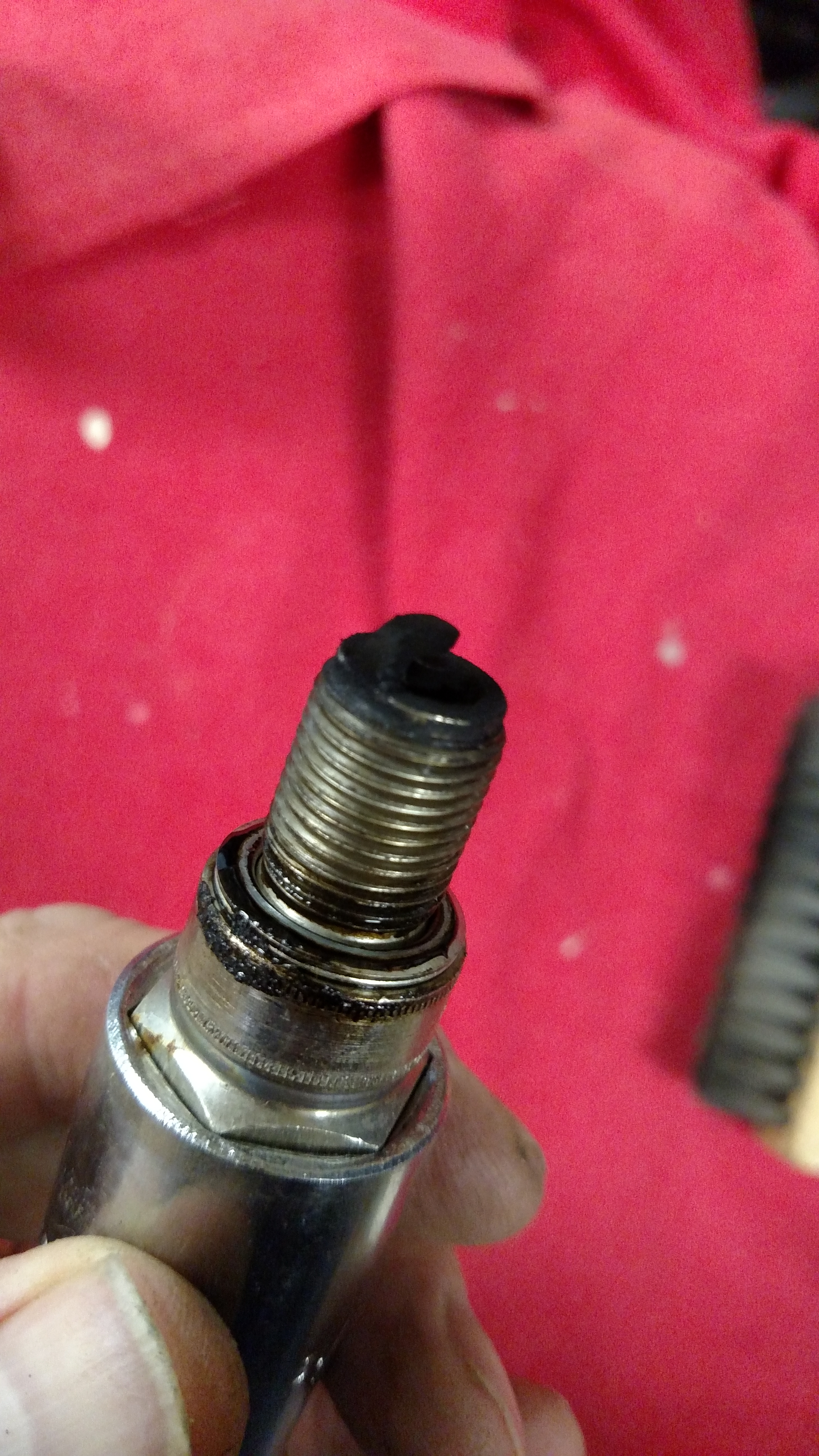

February 17, 20169 yr Author comment_486642 This is taking longer than I thought. I didn't get much time to work on it this weekend, due to some issues that came up. But tonight, I went through the temperature sensor circuit. I drained the coolant and removed the sensor. It checked out, reading 3.5 kOhms in my ~55 degree shop. I could even get the resistance to drop by holding the end with my fingers, as you would expect. I cleaned the bullet connectors in the harness over the intake, and checked continuity in the harness where I could. Once I did that, the resistance at the ECU plug read correctly. I was very hopeful that I'd solved it. I refilled the coolant. I pulled the spark plugs. They were completely covered in carbon, from running rich I think. I cleaned and reinstalled them. The connector on the bottom of the AFM wouldn't stay plugged in (I think it's broken). So I used a couple of crossed loops of wire ties to hold it. I hooked up everything, crossed my fingers and turned the key. No difference. At idle, it stumbles and dies after a few seconds. I can rev it to 2000rpm, and it'll run, badly. The search continues. Next session I'll try the cold start valve and clean all the other connectors I can get to, etc. My next opportunity to work on it won't be for a couple of days. That's a good thing, as I'm so discouraged, I don't want to look at the car right now. I did get the car titled and insured today. That's something, I guess. Link to comment https://www.classiczcars.com/forums/topic/53262-new-owner-of-77-280z-from-upstate-sc/?&page=4#findComment-486642 Share on other sites More sharing options...

February 17, 20169 yr Author comment_486664 I'm going to put in a new fuel filter and a fuel pressure gauge. If nothing else, this will rule out fuel supply issues. The engine revs fine. The plugs are sooty (see pic), indicating running rich. So I doubt it's a fuel supply issue. But it doesn't hurt to check. Like I said. It'll be a couple of days before I can get to it. Link to comment https://www.classiczcars.com/forums/topic/53262-new-owner-of-77-280z-from-upstate-sc/?&page=4#findComment-486664 Share on other sites More sharing options...
February 17, 20169 yr comment_486665 Too me that looks like your rich running problem. Those plugs aren't able to burn the fuel. Imho Link to comment https://www.classiczcars.com/forums/topic/53262-new-owner-of-77-280z-from-upstate-sc/?&page=4#findComment-486665 Share on other sites More sharing options...

February 17, 20169 yr comment_486672 1 hour ago, the_tool_man said: I'm going to put in a new fuel filter and a fuel pressure gauge. If nothing else, this will rule out fuel supply issues. The engine revs fine. The plugs are sooty (see pic), indicating running rich. So I doubt it's a fuel supply issue. The other hard part of solving problems is describing what you're seeing. I said "fuel pump power" but you're writing about fuel supply. You're looking at very rich conditions but talking about lack of fuel from a clogged filter. Often, just trying to describe the problem will make you think of something more to look at. If the engine will rev you might try just cranking up the idle speed to keep it running. It's the big screw head on top of the throttle body. You can turn it by hand. Get fuel flowing and let things loosen up. The TVS (aka TPS) has a full throttle position that can get stuck and cause excess fuel. The test is described in the Guide and the FSM, Engine Fuel chapter. By the time you're done testing you'll be an expert on basic fuel injection principles. Link to comment https://www.classiczcars.com/forums/topic/53262-new-owner-of-77-280z-from-upstate-sc/?&page=4#findComment-486672 Share on other sites More sharing options...
