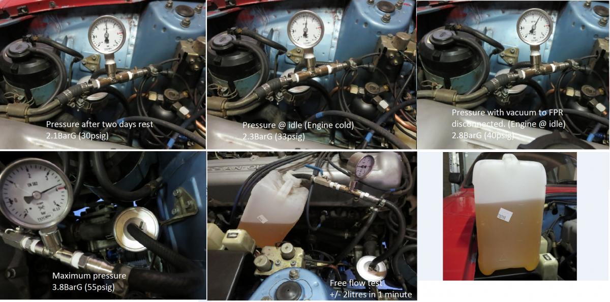

February 17, 20169 yr comment_486683 What you are experiencing is normal. We have all sort of been through it. My 280 was parked under a house in the owners workshop since 1993 and I own it since 2011. I have had blocked injectors where the PO adjustd the AFM to compensate, a TIU that played up awfully when the engine warmed up and after market injector connectors where the wires were badly soldered and intermittently causing and open circuit. It sounds bad, but that was over a two year period. If you keep working through the system, you will find more problems, fix the problems and eventually it will become a reliable car. I wrote a quick guide on Redwings thread on checking the fuel system for leaks. Ill can post my full step by step test with photo's tomorrow if you want it. My post is on the first page about half way down. Link to comment https://www.classiczcars.com/forums/topic/53262-new-owner-of-77-280z-from-upstate-sc/?&page=5#findComment-486683 Share on other sites More sharing options...

February 20, 20169 yr Author comment_486851 Update: The visit to the pull-a-part yard was a bust. So I bought some brass fittings and a pressure gauge and spliced it into the fuel line after the filter. I put in a new filter, too, even though the one already installed looked brand new. It was fun to test without a helper. I had to lean in through the passenger side window to start it, and then try to watch the pressure gauge while manipulating the throttle linkage. But I determined that when cranking, the fuel pressure would build to about 20psi. Upon starting, it quickly (5-10 seconds) dropped to zero on the gauge. I could keep it running by revving it. But it sputtered, as you would expect. So the fuel pump is running (eliminating electrical fault, contact in AFM, etc.), but it is either worn, or there is a blockage somewhere. I'm not sure how this explains the symptoms of running rich. But that seems to have been a red herring. My next step is to run new fuel lines from the pump inlet and return line to a gas can in an attempt to isolate the issue to either a dirty tank/pickup or a weak fuel pump. I was pleasantly surprised to see a drain plug in the fuel tank, BTW. More to come. Edited February 20, 20169 yr by the_tool_man Link to comment https://www.classiczcars.com/forums/topic/53262-new-owner-of-77-280z-from-upstate-sc/?&page=5#findComment-486851 Share on other sites More sharing options...
February 20, 20169 yr comment_486854 You don't need to run lines from the fuel pump to test its performace. Try doing a free flow test after the filter first. If the pump is in any condition, you should get 2 to 3 litres per minute. After testing the flow pinch the hose shut with vice grips and two pieces of flat metal to prevent the vice grips from damging the hose. I have even used two euro coins to do the job. It should hit 55 to 60 psi before the internal valve in the pump starts regulating the pressure. Remove the small spade terminal from the starter solenoid so you can use the key in start position the activate the pump. I have some photo's of a test I did on mine. I used a small valve to block mine, but vice grips will do fine if the hose is in good condition and flexible. Once you determine you have flow and pressure, you can move on. Keep ticking things off the list and you will get there. Link to comment https://www.classiczcars.com/forums/topic/53262-new-owner-of-77-280z-from-upstate-sc/?&page=5#findComment-486854 Share on other sites More sharing options...
