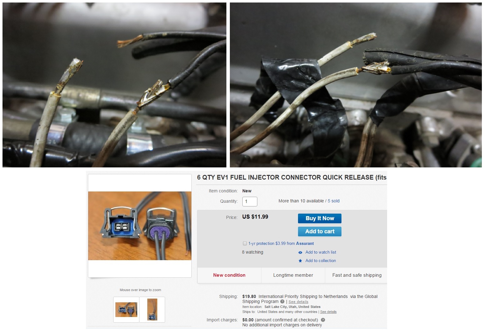

Forgive me if you've already done this, but have cheked & cleaned the injector connections?   Mine were in such bad shape I just replaced them.
Do you get much salt air, where you're at? That looks like what happens to cars that are around the beach. The aluminum normally gets tortured too.
I changed my connectors on all the injectors, CSV etc with new quick release connectors. The previous owner did a rough job soldering the connectors he used. They were giving me interminttent missfiring on a couple of cylinders.

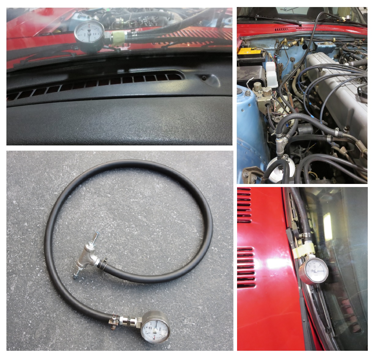

If you are testing the fuel pressure on your own, you can use a longer section of hose and mount the gauge were you see it. I did that to check the pressure while I was driving it. Simply taped it to the wiper arm and test drove with the bonnet adjusted so it wouldn't pinch the hose.

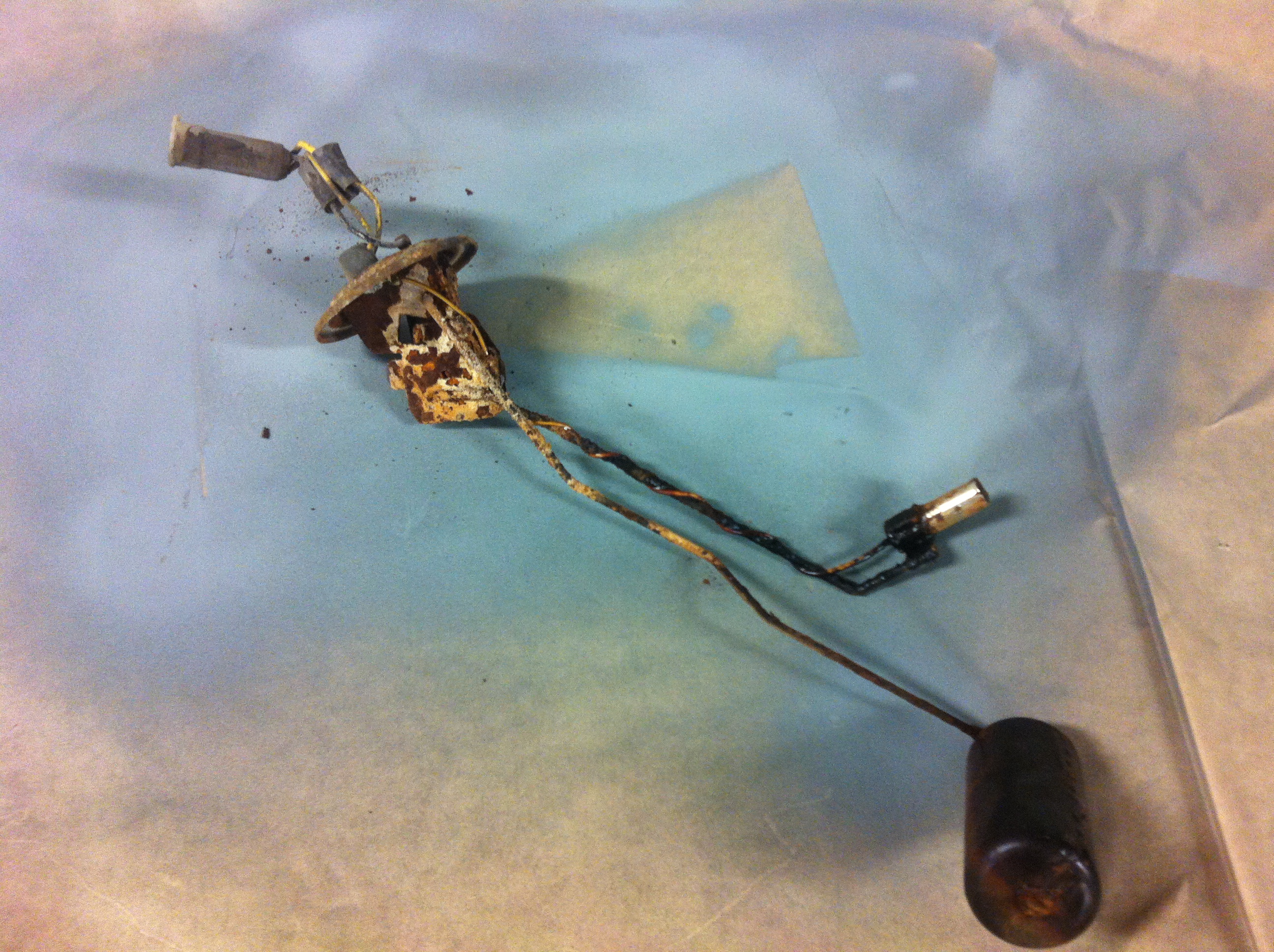

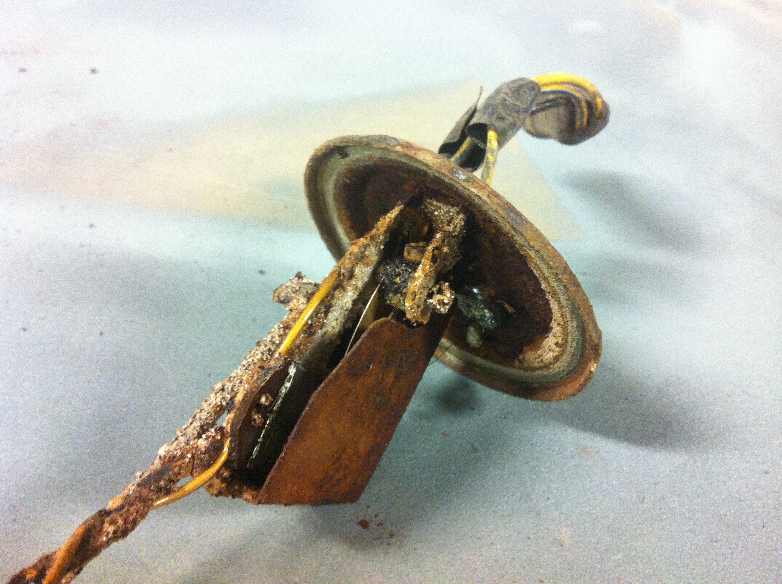

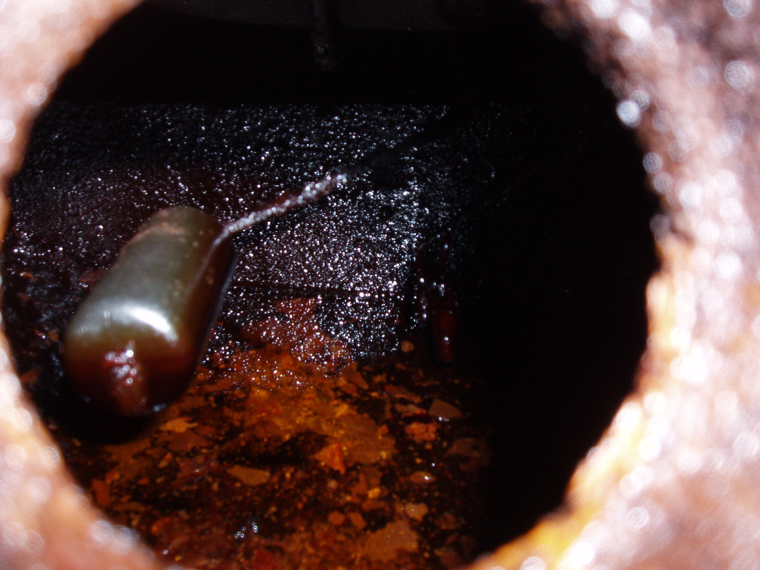

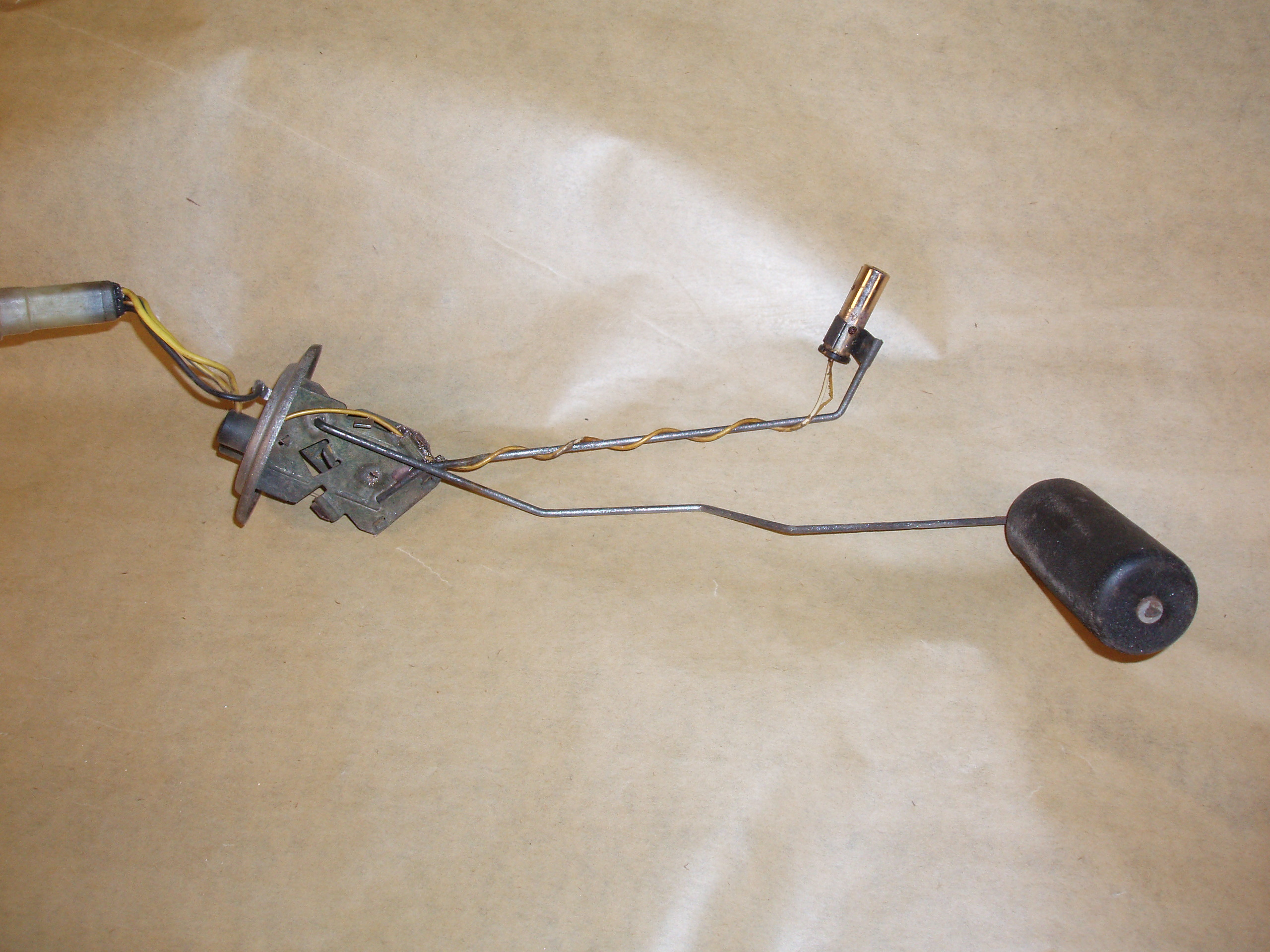

  • I noticed my fuel gauge reads half-full.  I know the tank was full when I brought the car home (I filled it up).  So while not necessarily urgent, I need to sort it out pretty soon.  I may end up pulling the sender anyway during the course of the fuel supply investigation.  But if not, it won't hurt to pull it to inspect the inside of the tank for rust and debris.  If I had to drop the tank to do this, I'd probably put it off for as long as possible.  But between the tank drain and the inspection panel in the trunk, it looks like an easy job.
  • I plan to replace all of the EFI connectors with new ones.  Firstly, the AFM connector on my car was missing the wire retainer, and is currently held on with wire ties wrapped around the AFM.  Secondly, while the contacts aren't green, they are somewhat corroded on many of the connectors.  I've inquired about replacement connectors from a guy (Kurk MacKay of MacKay Power Products) recommended to me on Hybridz.  He's been slow to communicate.  But he offers a kit that has everything I should need.  I've already ordered the pin removal tools and a new crimper to facilitate this.

I would not hesitate to contact Mike at Bonzai motorwerks. He's got all the parts you need, but more importantly can point you in the right direction for getting your car running properly. Whatever you think your are "overpaying" for parts, he more than makes up for with his experience & expertise. He saved me HOURS of diagnosis time, and he got my Z as close to OEM (read reliable) possible.

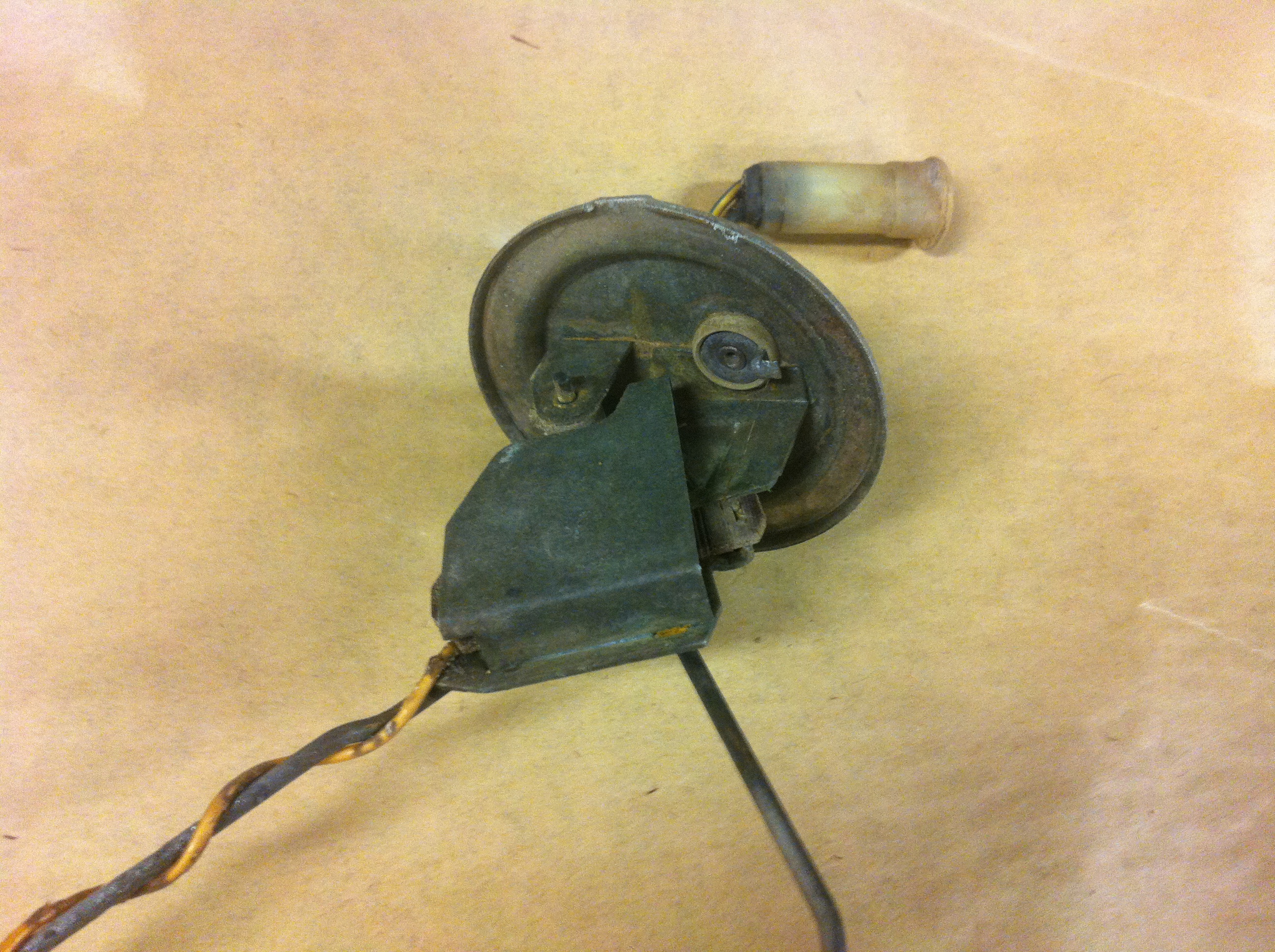

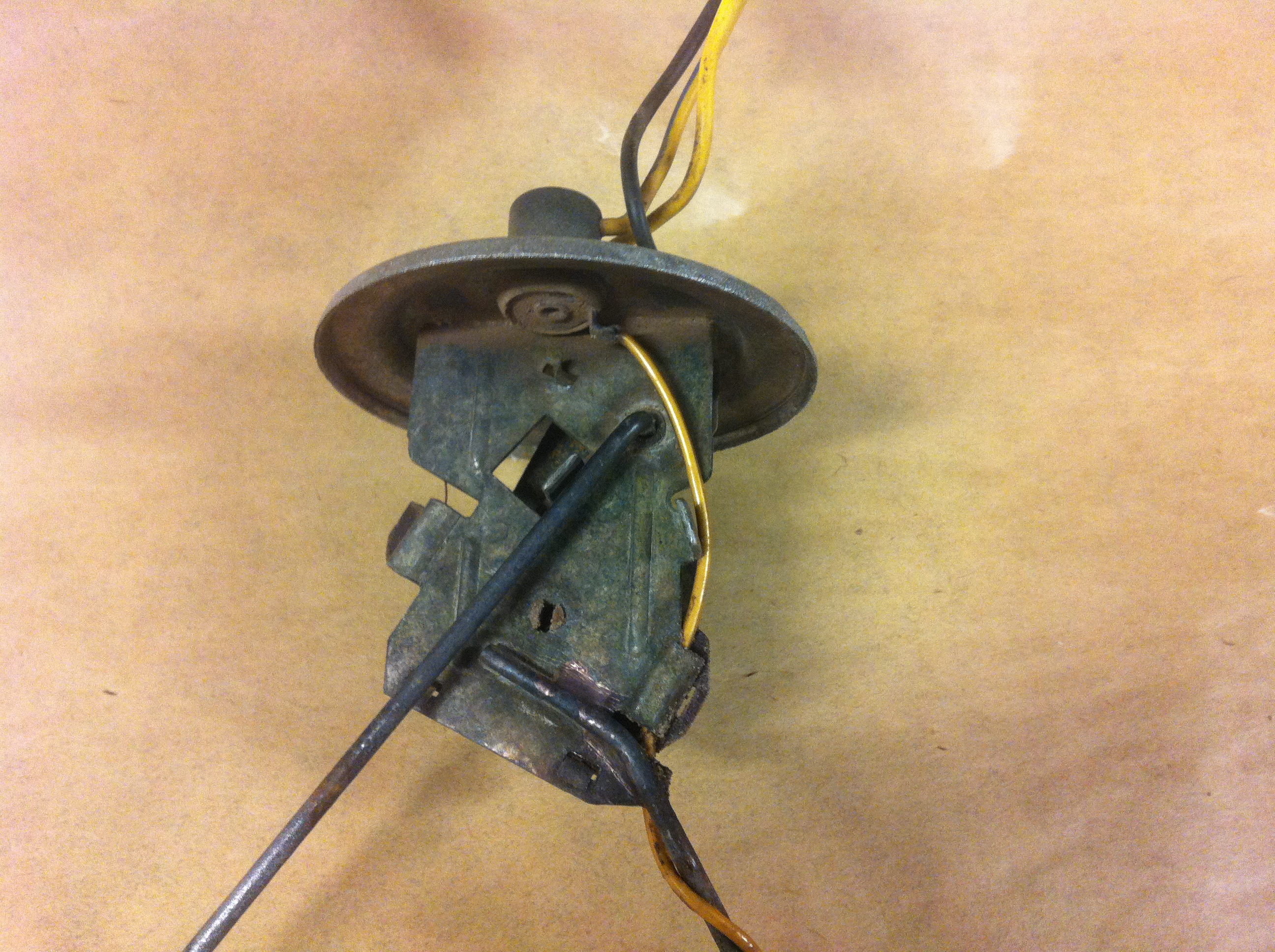

I replaced my fuel sender with a new one from Nissan.  After reading on here about the process I realized the arm had to be bent a little.  I think the new ones are straighter so they'll fit into the box.  Maybe your's needs to bent some?  If it's the original one, it may just need a good cleaning where the contact arm sweeps over the wiring.  Carburetor cleaner works good.  I was able to clean the one on my 280, the 240 had to be replaced, it was frozen from sitting in a cruddy tank full of 10 year old gas.
What they said, save it if you can.  You can find one for a 77' but it will cost you dearly!
