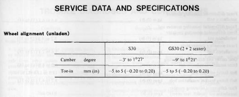

My hats off to those who can do everything themselves! I wish I could. And of course, time is money, so some must pick & choose the things we DIY and pay for the rest. In any case, for everyone's info, this is from the 1978 FSM
Don't forget the rear wheels.  A fun experiment would be to take your car to several different shops and see how many take your money for aligning the rear wheels and "setting" camber on the fronts.  Take a fat wallet.  I can't give in on the "just spend the money" argument.  We're here to show people what they can expect from these shops.  What's involved in doing the job right.  There's no camber adjustment for a shop to make.

Thanks for posting that!  I remember checking at least the steering, wheel and general info sections of the FSM and my mostly-useless Haynes manual and didn't find specs, and Google returned almost nothing.  I imagine/hope this thread will be of some use to someone in the future as well.
I wouldn't be surprised at all if the shops in my neighborhood somehow managed to show me a before and after printout of freshly aligned rear wheels on my car.
Taking the other side of the argument - the specs. are there for confirmation that everything is right.  They can be measured.  They could show worn bushings, or bent parts, or signs of a previous accident, or even find a basic problem that was built in to the car (some say that older 240Z spindle pin bores were drilled off design axis).  If the simple toe-in spec. doesn't get the car right, then the alignment shop visit is probably in order.
