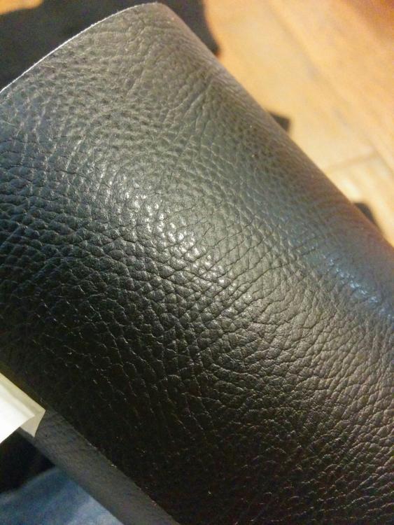

After a lot of searching, I found Hexis, a vinyl manufacturer originally from France, that also makes a leather-textured product.  Hexis seems to have the same high level of regard as 3M and Avery, and -- most importantly -- their leather finished stuff is available through retailers.  Here's one of the finishes:
I think I'm gonna give it a try.  I'm not putting speakers in the B pillar, so losing those holes is not a problem. And if it works for the panels, I'm really excited about the possibility of using it on the dash.  I was going to give vacuum forming a try, but wasn't totally optimistic about it working :)

Don't want this thread to die on the vine.  I took rough measurements of the main panels (tail lights, quarter windows, rear hatch) and figure that 2 yards should be enough to cover them all and have some left over.  US Cutter (http://www.uscutter.com/HEXIS-30000-Cast-Vinyl-54in-by-1yd) knocked their price down recently.  For $85 shipped, I'm giving this stuff a shot.  Will report with results when I have some to report!
one thing to keep in mind - a vinyl film thin enough to follow detailed textures/contours will telegraph any cracks/imperfections in the substrate. so in order to get a good looking finished product, you will need to ensure the dash is repaired as perfectly as possible. the other thing that will be interesting to see is how it handles the continued off-gassing and flaking/crumbling of the dash material due to UV exposure and extreme temp cycles.
Definitely right about surface prep.  I would expect the leather texture to hide some tiny imperfections, but just about anything will show up through regular vinyl.
I don't trust the dash to not crack further, so I've already planned on removing all the plastic and putting on a layer of fiberglass.  I'm don't think the factory texture + 40 years of accumulated gunk would make a suitable substrate for the vinyl anyway.

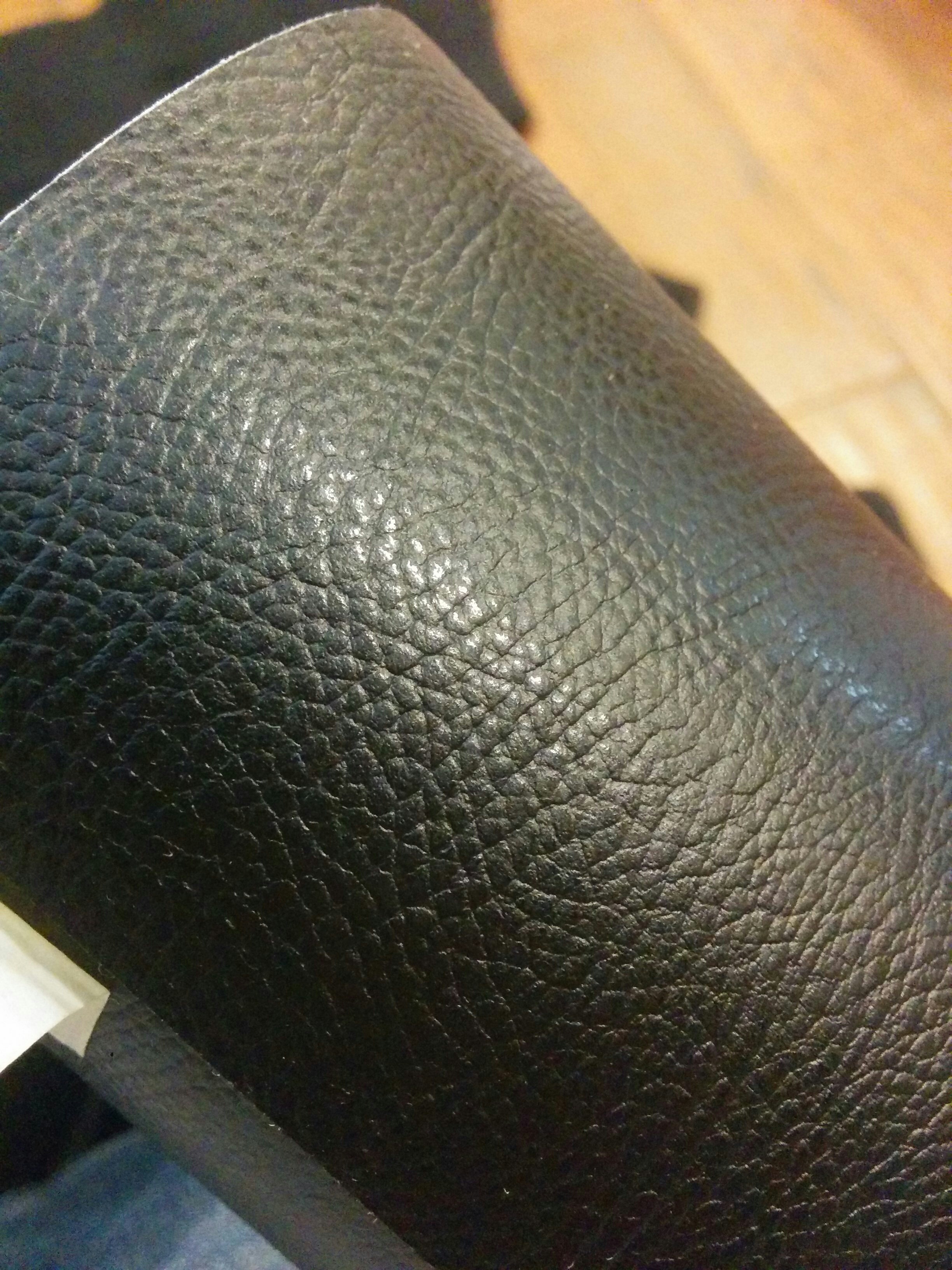

Vinyl was delivered during my lunch break. First impressions... Looks pretty nice. Touch won't fool anyone, but it does look nicer IMHO than the bare plastic. Reminds me a lot of the hard touch plastics used in economy cars. I'm optimistic that it'll make a nice, subtle upgrade for the panels without looking out of place.
