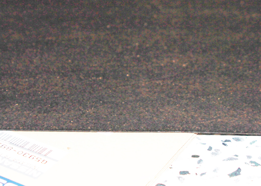

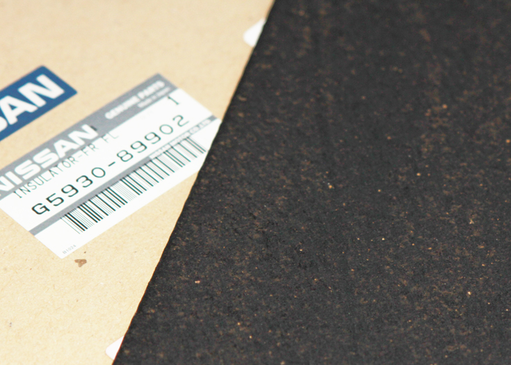

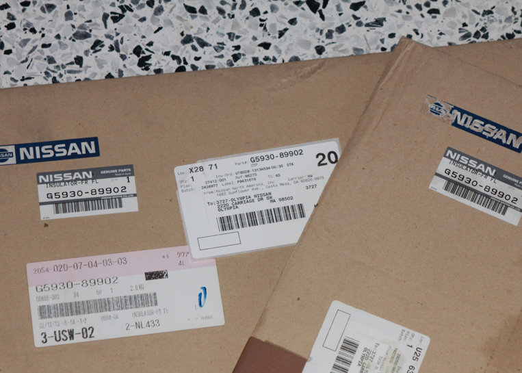

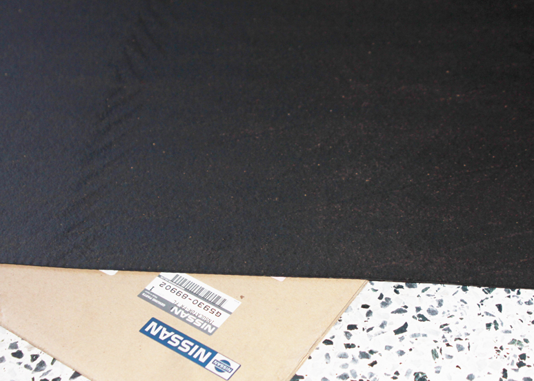

The thread posted by Zup is very good.  I don't think I have ever posted pictures of the real stuff.  I was fortunate enough to buy this many, many years ago.  These pictures have been brightened enough so that you can see what the actual material is.  The insulation material is an asphaltic impregnated felt material; very thin and brittle in a room temperature state.  It is around 1/32" thick - like a #120 0r #140 felt paper, however it is much more bitumen than felt.  The brown spots of fibrous felt can be seen as more of a binder material.  You can see that it is manufactured through a roller process.  The surface finish is rough which indicates to me that the material was heated during the rolling process.  The sheets I show are for replacement floor insulation.  Applied with a heat gun - of course.
