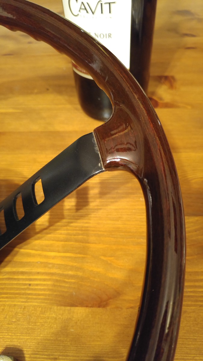

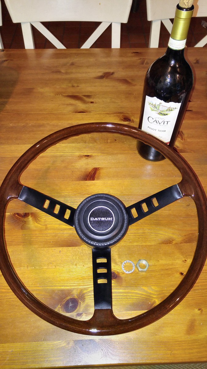

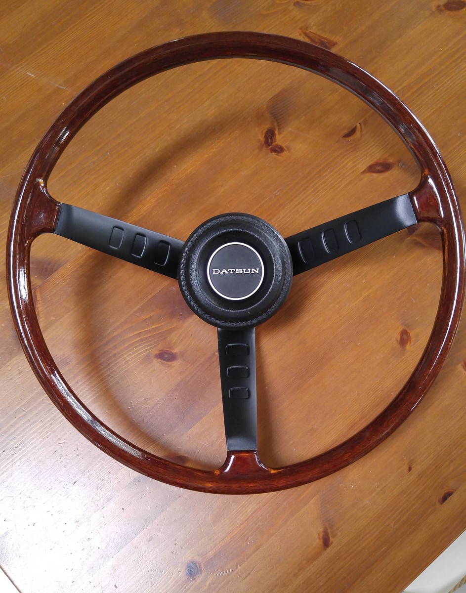

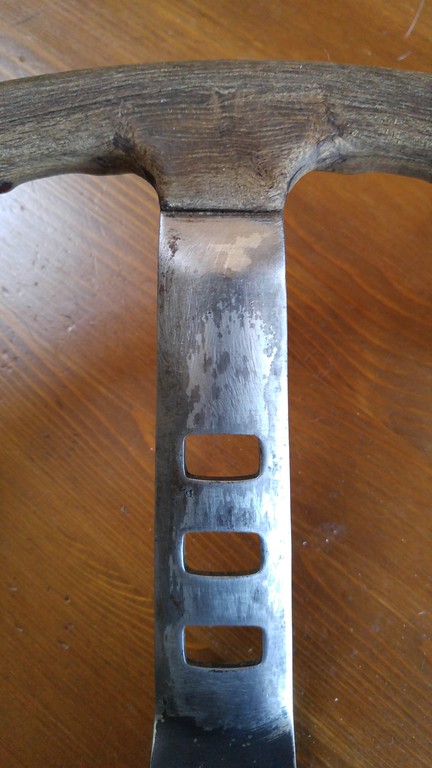

I find that on most series 1 wheels you don't really need a stain if you get them really clean.  Just a GOOD cleaning, a proper regimen of careful sanding, and a proper application of your choice of semi-gloss, or gloss, spar urethane.  The series 2 wheels seem a bit different. The one I just did, required bleaching, and a red stain, but I learn as I go.  I will be listing this series 2, I just finished tonight.
