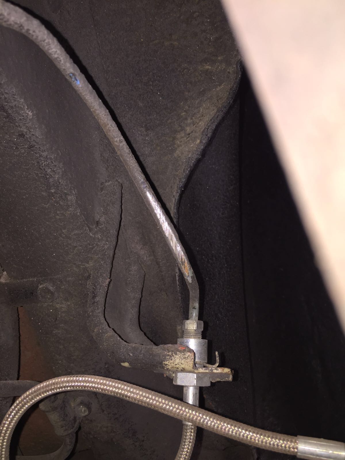

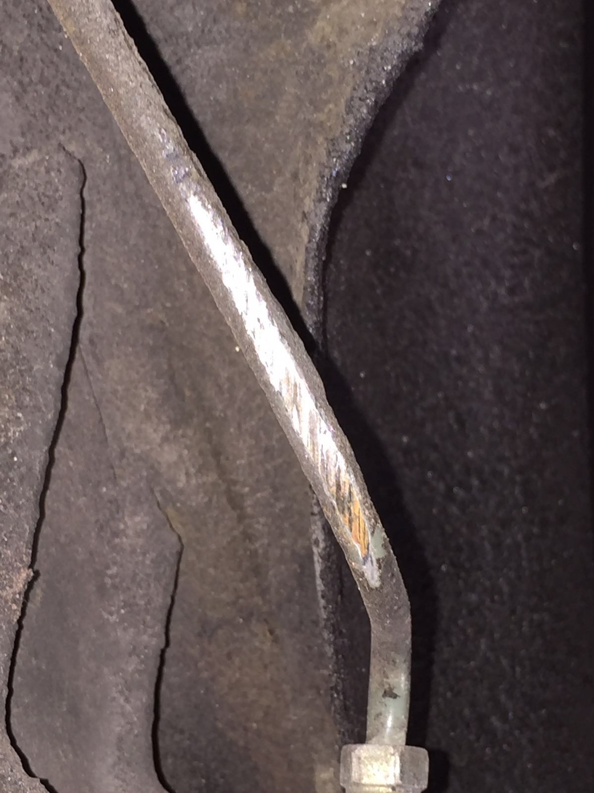

Popped the hood and found the forward reservoir totally empty, the rear reservoir was full, the drivers side rear wheel (on the inside) covered in brake fluid. Once I removed the wheel I found scrapes and a tiny perforation on the solid brake line angle close to the junction to the braided stainless steel hose that leads to the caliper.
56e333b7143f2_280Zwornbrakelinecloseup.t
After analyzing the situation it seems that the most likely cause of the scrapes (almost looked like someone had filed down the brake line) was the SS line flexing up and down with the movement of the rear wheel and rubbing continuously on the hard line until it finally perforated when I strongly applied the brake pedal Saturday morning. I inspected the other side and found the same situation: scraped hard line at the same spot.
56e333c5061bf_280Zwornbrakeline.thumb.jp
I thought this report might be useful to some who have done brake upgrades with SS hoses (I have an MSA rear disc upgrade and SS hoses) and thus avoid a similar scary situation.

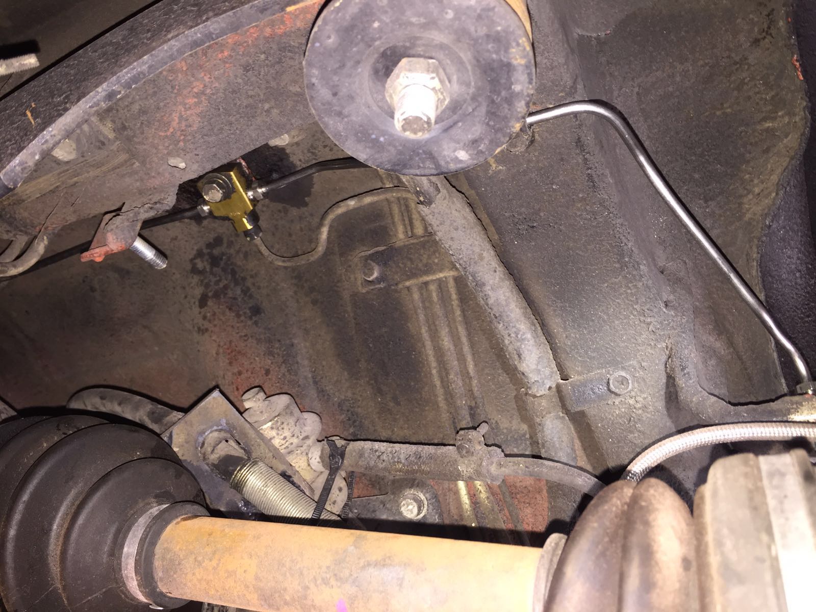

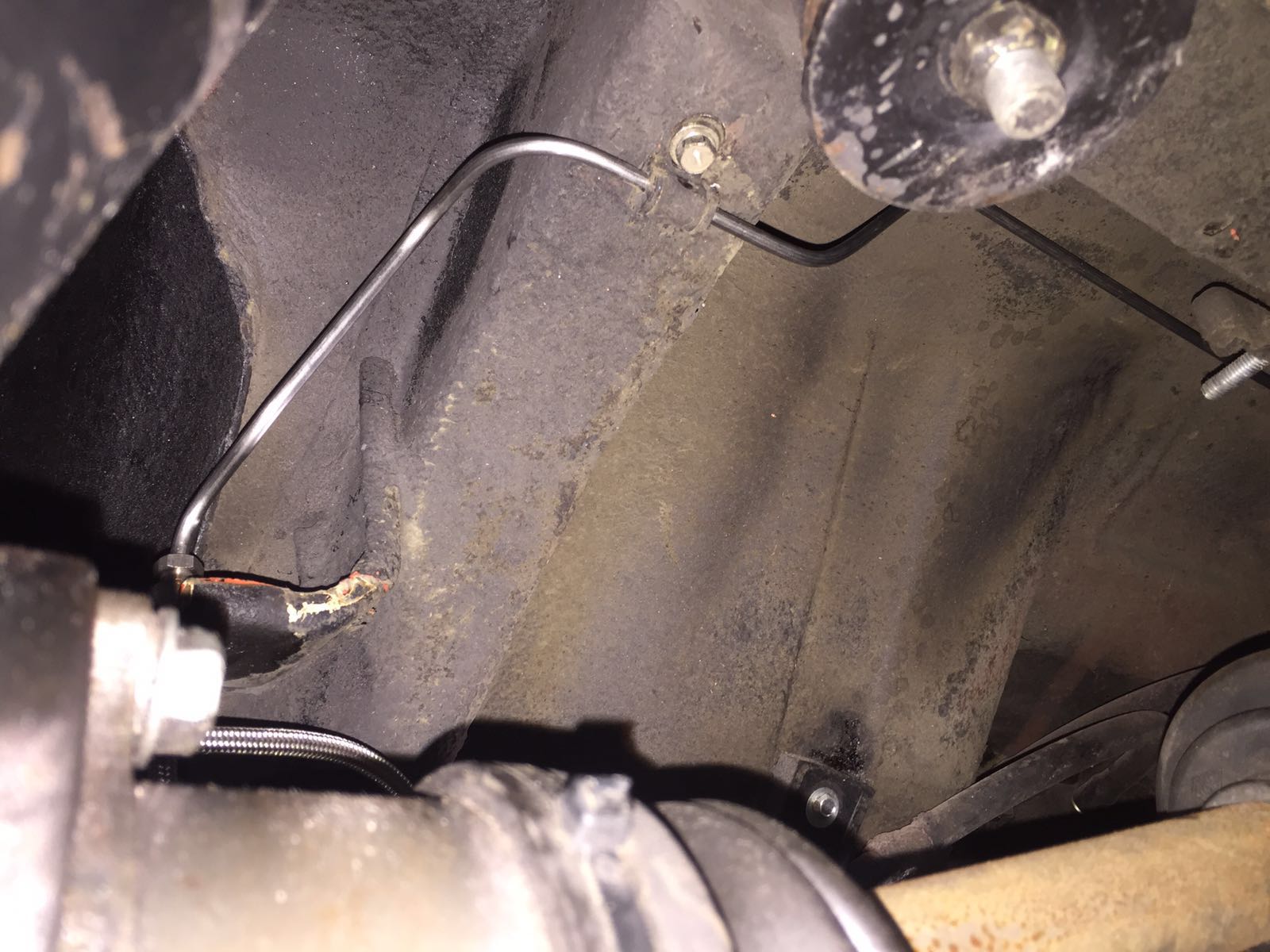

I have now changed the two segments of damaged rear brake lines for new SS hard lines and twisted the flexible braided ss hoses so they won't come near the new lines when the suspension is compressed.
56e333dc3a77e_280Znewrlbrakeline.thumb.j
56e333ee70557_280Znewrrbrakeline.thumb.j

A braided stainless line (any braided stainless line) is a file.  I will cut through anything - metal, plastic, rubber.  The lines must not rub one anything.  You are lucky.  Re-routed the braided line and replace the brake hard lines.
