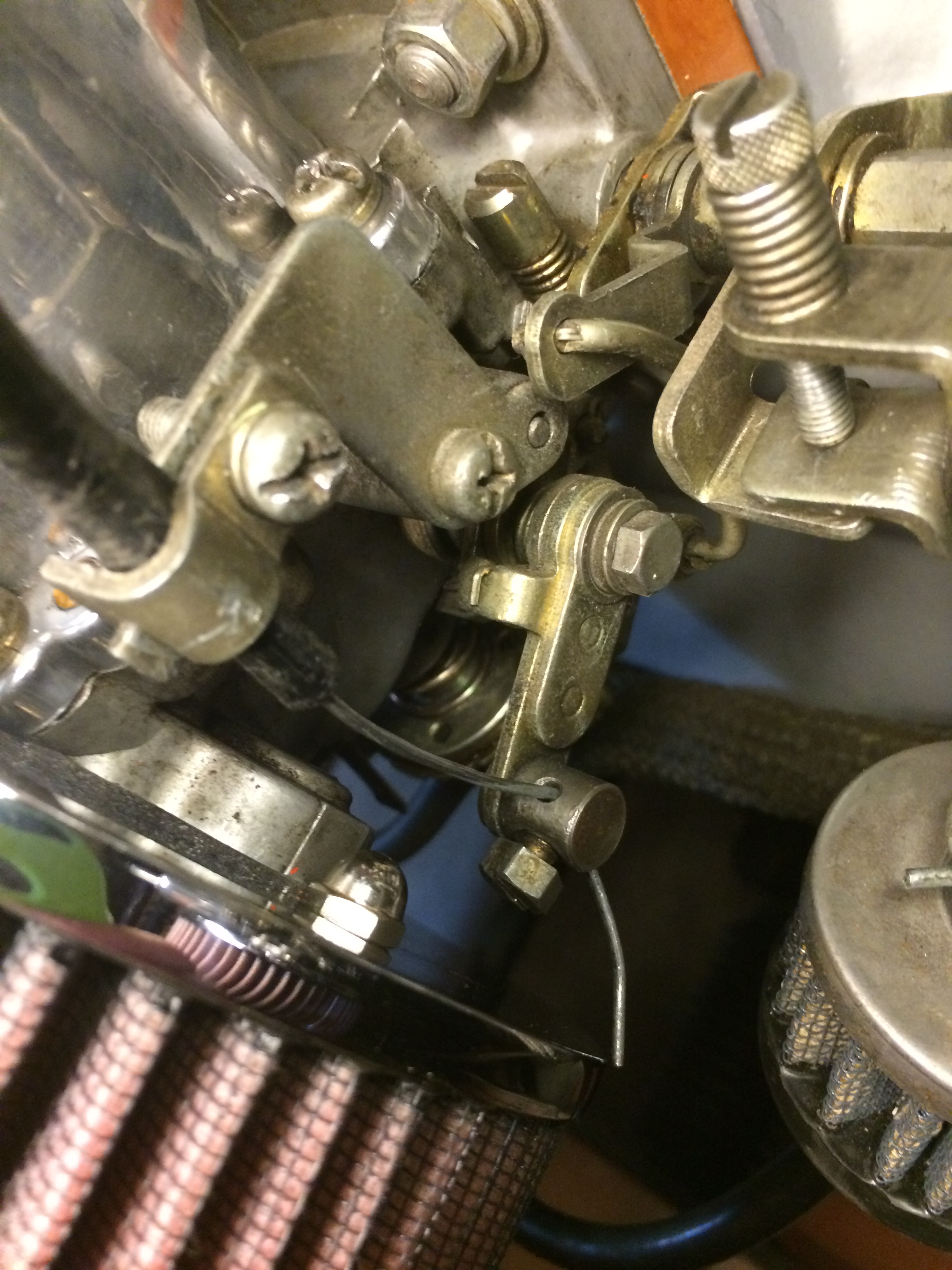

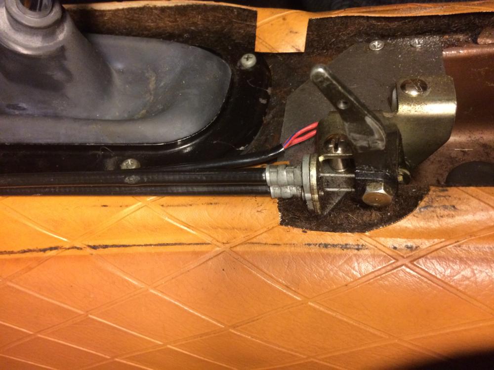

Last night I replaced the choke (cold start) cables for the carburetors.  They need to slide freely and after 44 years of usage and most likely never being lubricated since new, it was time.  After doing some research I found that 0.055" Piano wire is the best option for replacement as its affordable and able to push and pull, which is required.  I also have more than enough left over and only paid $4.60.
After disconnecting the cables from the carbs and pulling the center console apart, I removed the cables from inside the cabin, then measured the length needed.  I left myself an extra foot before I cut the Piano wire.  I bent it around the mounting plate and then lubed it very very very good before fishing it back into the housing and reconnecting.  I'm very pleased with the results!

High carbon steel, eh?  Hope it doesn't rust out too quickly - not an issue in a piano, where it won't be exposed to wet conditions, but in an engine bay it will be.
Interesting idea, but wouldn't bicycle brake cable be a better choice?
Bike cables are braided wire and wouldn't work well in this application as it has to push as well as pull
i bought the same wire for my heater control cables. the outer part i bought at a local bike shop. less than $20 for everything

Regardless of what is used, grease the heck out of it!  I even sprayed silicon lubricant into the cable housing.  The Piano wire seems to be more flexible than lawnmower cable, so it'll pull/push smoother.
