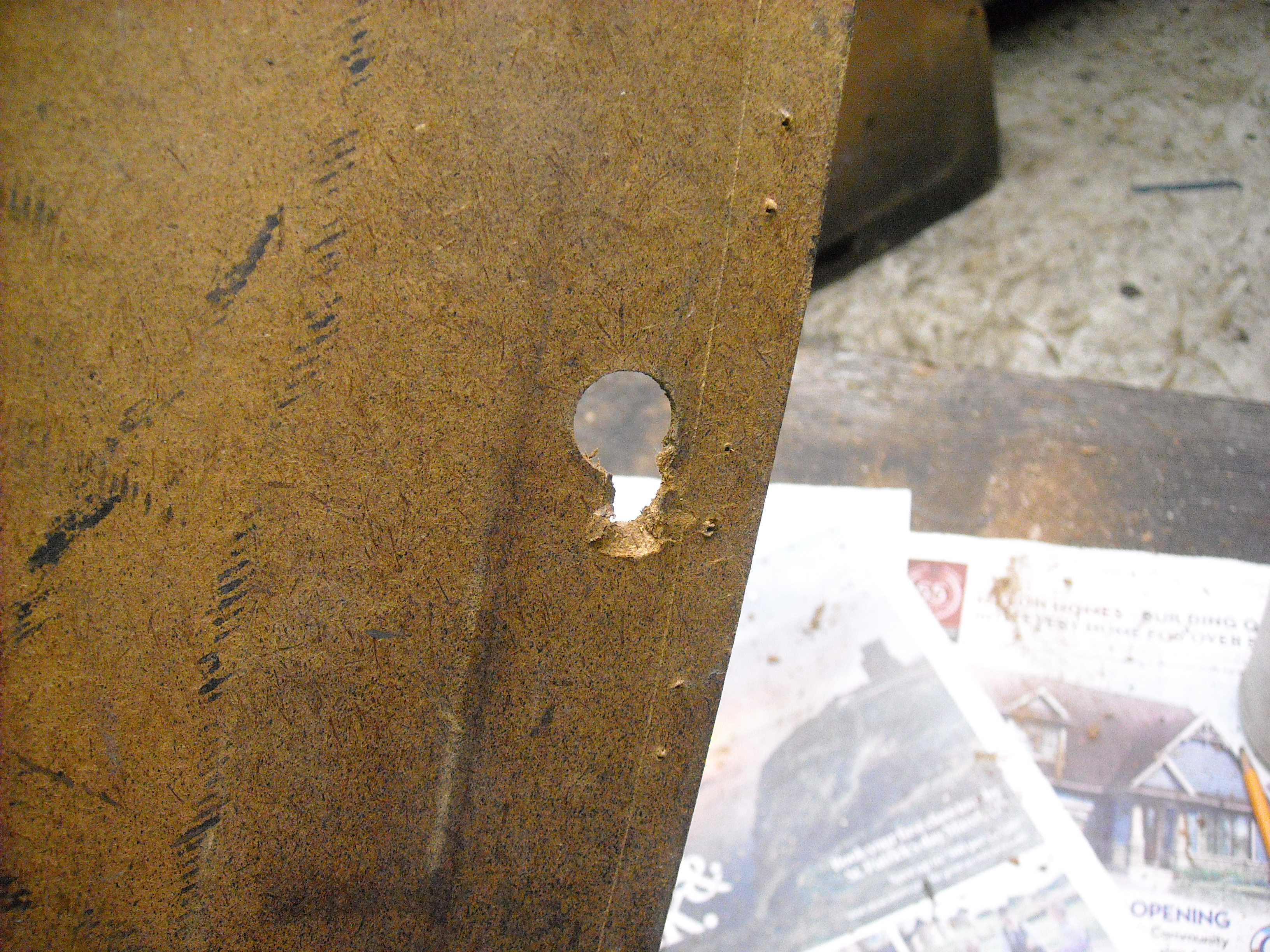

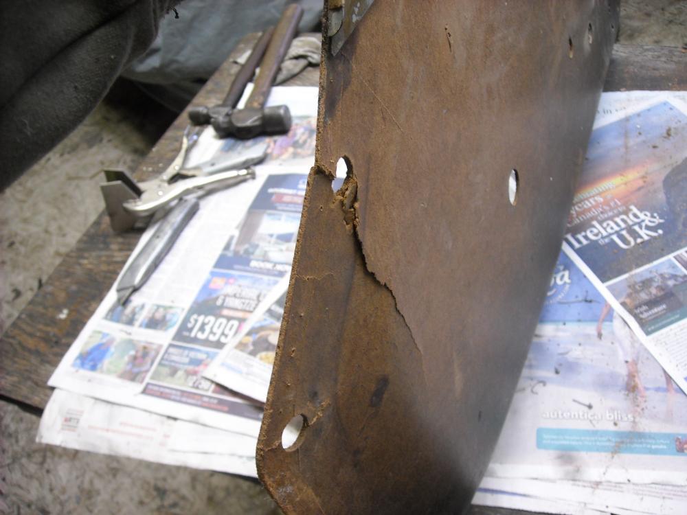

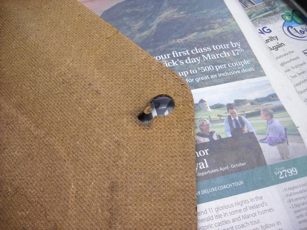

Posted March 20, 20169 yr comment_489658 I'm about to start working on the door panels to try and repair some age damage before re covering. I thought perhaps some kind of a fiberglass repair kit from Amazon, any suggestions? Thanks, Chris Link to comment https://www.classiczcars.com/forums/topic/54244-another-door-panel-thread/ Share on other sites More sharing options...
March 20, 20169 yr comment_489665 Looks like a big crack to fiberglass.  I'd probably bond in a thin sheet metal or aluminum panel under the fiberglass cloth  patch for added structural strength. Dennis Link to comment https://www.classiczcars.com/forums/topic/54244-another-door-panel-thread/#findComment-489665 Share on other sites More sharing options...
March 20, 20169 yr comment_489675 If it were mine, i'de mount it on the door and get it to fit as close as possible to how its supposed to fit and then i'de glass up that big tear. If you patch it up with it off the car, it might not fit the door correctly because the panel will not be as flexible with fiberglass over the top of it. Let it dry overnight and pull it off and lay 1 layer of matt over the whole door panel. I'de get the thinnest matt you can find too. ultra thin fiberglass matt here Edited March 20, 20169 yr by hr369 Link to comment https://www.classiczcars.com/forums/topic/54244-another-door-panel-thread/#findComment-489675 Share on other sites More sharing options...
March 20, 20169 yr Author comment_489692 Good points, I have never FG over anything like the fiberboard that these panels are made of, should I soak them in resin first and let it soak in and cure then coat again and glass it? Link to comment https://www.classiczcars.com/forums/topic/54244-another-door-panel-thread/#findComment-489692 Share on other sites More sharing options...
March 20, 20169 yr comment_489693 There are two different types of repairs required here: For the clip hole areas, why not approach this the same way that you would with a rust repair. That is, cut out the bad part and 'weld in' (glue) new material , cut to shape. Although it would definitely be easy, I'm not sure that a fibreglass repair is going to give the clip the right kind of surface to 'do its thing'. My idea would be to start with new, 1/8" masonite panel stock. Create a hole of the correct diameter (hole saw?), then use a small file to add the 'notch'. Now cut out the patch panel, complete with hole, and lay it over the door card so that the hole locations line up. Trace the outline onto the door card, then cut out that area. Now bond the patch panel into the cut-out area, using a fibreglass overlay on the 'back' surface. While I have not tried this myself (yet), I think it could work nicely. For the big tear, I agree that an f/g cloth-and-resin overlay will probably be the way to go. Here's an additional idea, though -- To temporarily bond the torn edges prior to applying the fibreglass, my notes include a comment from another CZCC member to the effect that a 'thin' cyanoacrylate glue used by model airplane hobbyists works well with the door card material. He referenced a brand called, 'Great Planes PRO CA' (packaged in the usual 1-oz eyedropper-style bottle). I'm not really sure how they manage to make this stuff thinner than plain old Crazy Glue, but it's promoted as having 'superior wicking action'. The label on the bottle says, 'Great for tight-fitting parts, tacking and CA hinges'. The Z owner in question said that he used it successfully to firm up 'mushy fibreboard around the holes' and reported that it resulted in an area that was 'super-hard and strong'. So: If you can figure out a way to press your torn edges together and flat, this glue might just do the trick. If you've got a spare piece of door card, maybe use that to experiment with first. Alternatively, try cracking a piece of masonite sheet and the use the glue to try to re-set the crack. Let me know if it works . Link to comment https://www.classiczcars.com/forums/topic/54244-another-door-panel-thread/#findComment-489693 Share on other sites More sharing options...
March 20, 20169 yr comment_489723 If it were me I would go fiberglass for the whole repair. I think you're right to use some resin to wet down the board first. I would use resin to make the initial repair to the crack and hold it close with screws or some weight over wax paper as a release sheet. Then back up the repair with some light weight matt. I think HR's recommendation for using the door as a jig is a great idea too. Once the initial repairs are done you can remove it and back it up from the back side if necessary. I get a magazine from Epoxy works and they do all kinds of projects with fiberglass and resin. It should do fine for all the repairs you need to make. At the holes I would thin down the board around the holes for the repair. That makes room for the repair material without too much overbuild. Whenever you patch holes in fiberglass you all ways try to make transition areas for the repair, same principle.. Link to comment https://www.classiczcars.com/forums/topic/54244-another-door-panel-thread/#findComment-489723 Share on other sites More sharing options...
March 21, 20169 yr comment_489921 Fiberglass resins will bond to that stuff until the end of time, no need to soak them beforehand.  If you do glass them, you'll want to set up some kind of jig to keep the panel from going out of shape and/or shrinking during when it cures. If it were me, though, I'd head down to Home Depot and get a half-sheet of masonite and a flush trim bit and just bang out a new one.  Fiberboards weaken over time and it's likely to tear out again. Link to comment https://www.classiczcars.com/forums/topic/54244-another-door-panel-thread/#findComment-489921 Share on other sites More sharing options...
