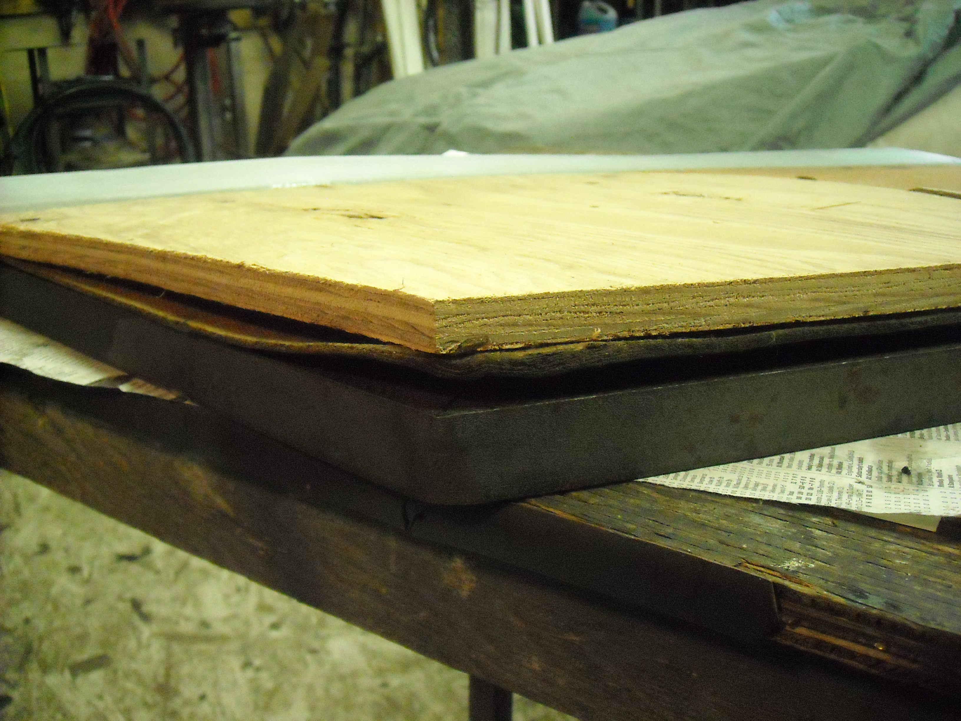

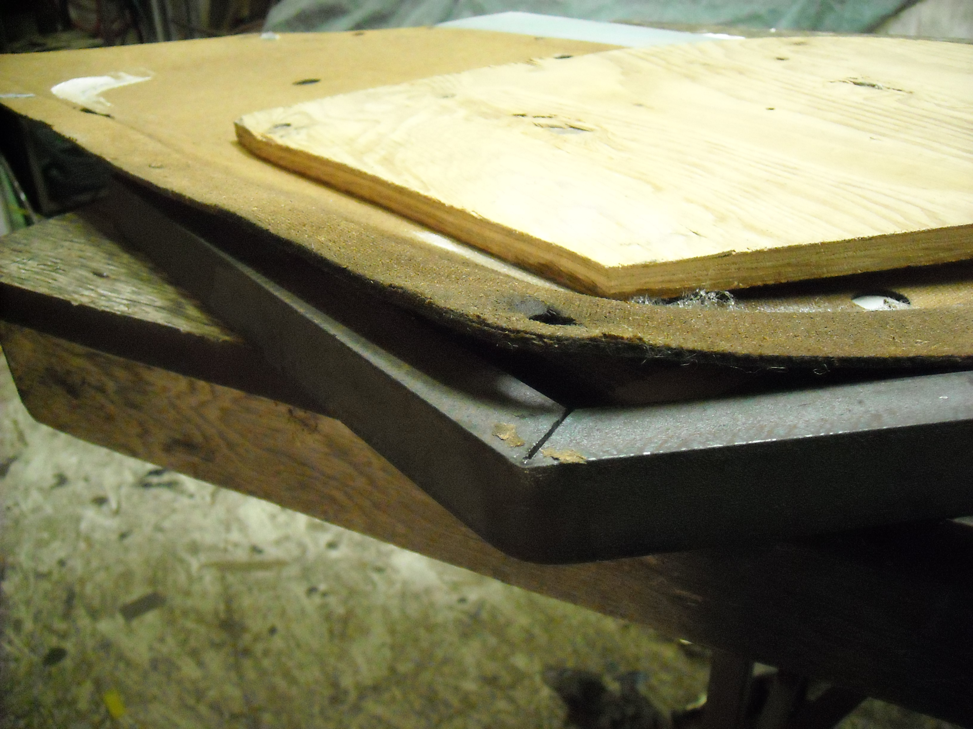

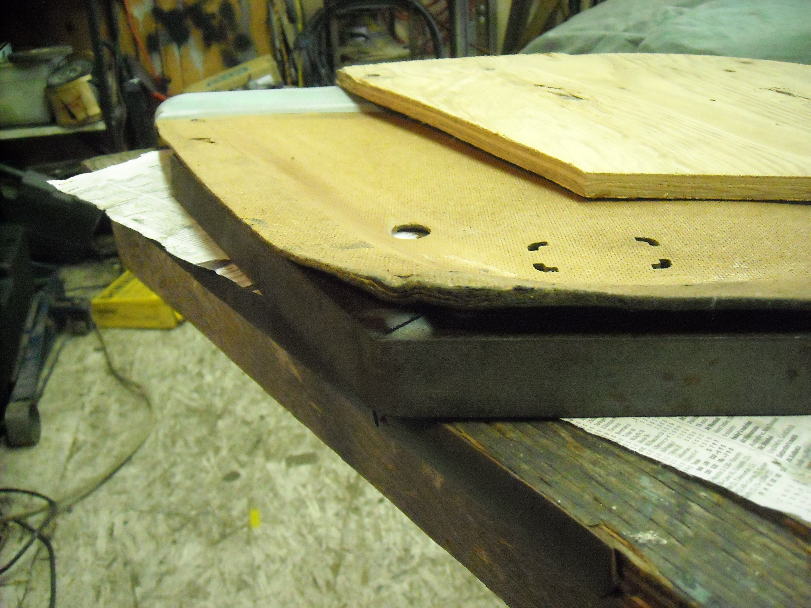

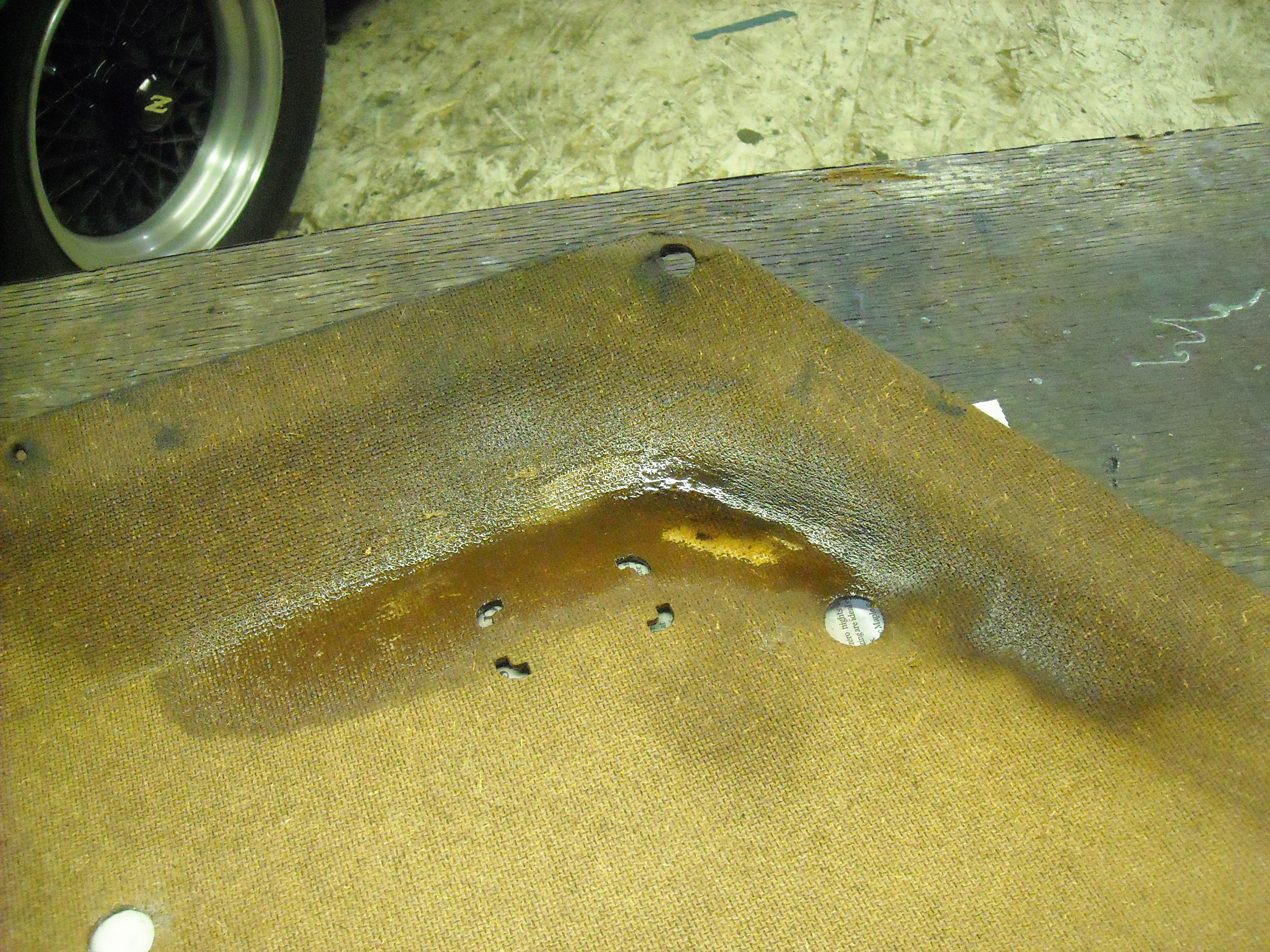

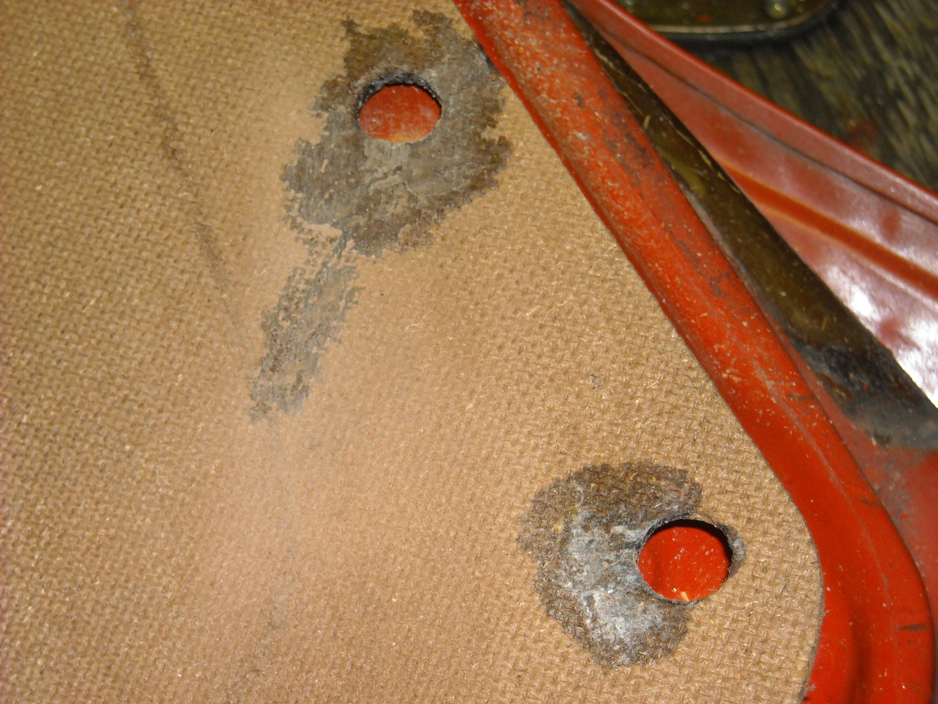

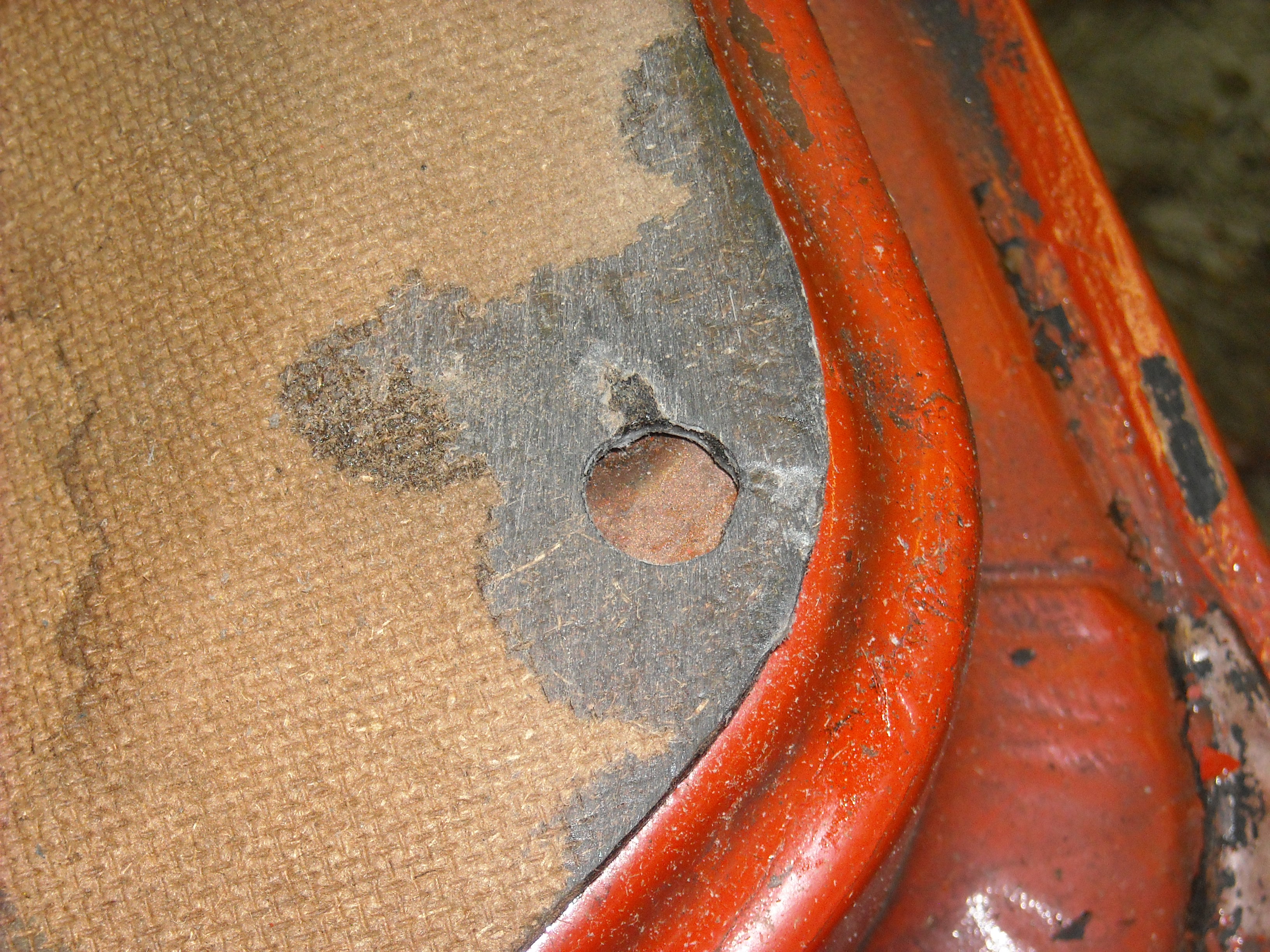

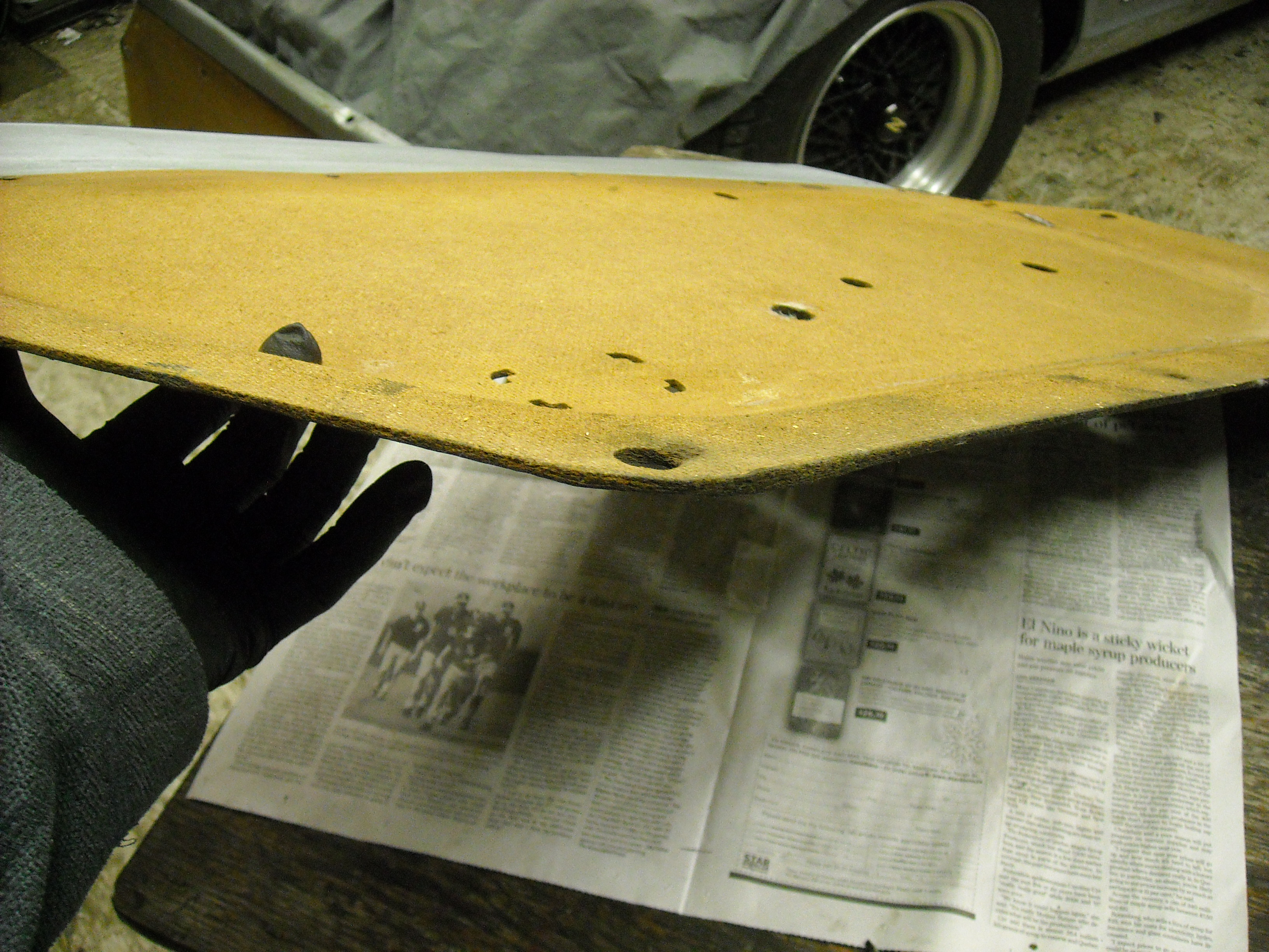

Well I decided to use a bunch of the suggestions you guys have offered and so far everything seems to be going well. Before I start repairing the holes I have to get the panel straight again, it has been warped by getting wet too many time and curling. I made a splint out of angle iron and plywood, soaked the corner of the panel with methyl hydrate (wood alcohol) until it was almost squishy and pliable then clamped it down.    Now I'll let it dry slowly and hopefully it wont be warped when I un clamp it.

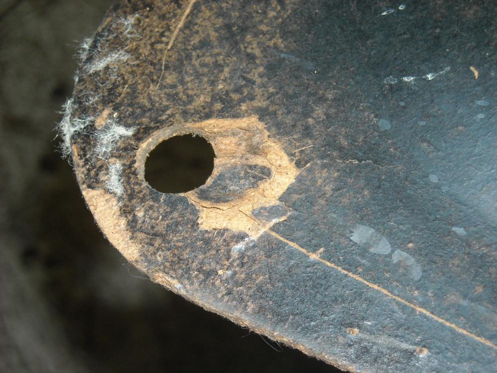

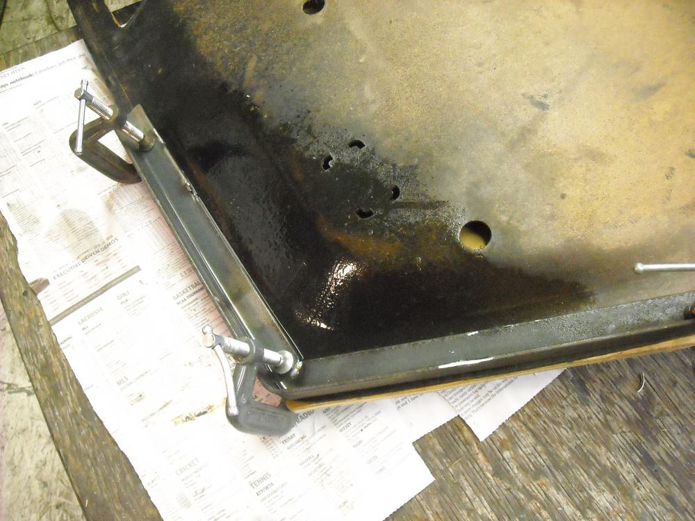

The lower section by the door handle was warped and had multiple tears and breaks, that area I soaked in cyanoacrylate glue  and clamped it up with wax paper covered splints, I'll have some better pics tomorrow.

The soaking in methyl hydrate and pressing flat did the trick, all the edges are clean and straight now so I can add a layer of fiberglass to the back of the panel now to give it some stiffness.
Got to say that I'm really impressed with the cyanoacrylate glue, I've only ever used it in drops in the Krazy Glue form but used liberally it soaks into the fibre of the panel and reinforces it.

Chris:  Just to be clear, what did you use to fix the areas around the clip holes:  cyanoacrylate glue, f/g resin, or both?
So far I have only used the CA glue to reinforce areas where the panel board fibres are broken and torn but still intact, I haven't used it to fill voids because it doesn't seem that it would have much strength that way.
