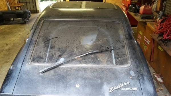

Apparently it has been done.
awesome! now to ensure i do a better job w/alignment for the "park" function. btw - is this a car you have access to for measurements? or if not, where did you find the pic?
Luckily, it's for sale in the Seattle area.  I saw it on craigslist and remembered the rear wiper because it is so unusual.
http://seattle.craigslist.org/tac/cto/5455708891.html
funny... i looked at that ad but never made it past the first pic.
been looking at a few pics and think the simplest will be to use the zx assembly.  shoot some studs to the inside of the hatch to bolt it up, drill a hole for the shaft, not so tricky but i need to make sure the sweep is correct and the wipe pattern fits before attacking my hatch.
