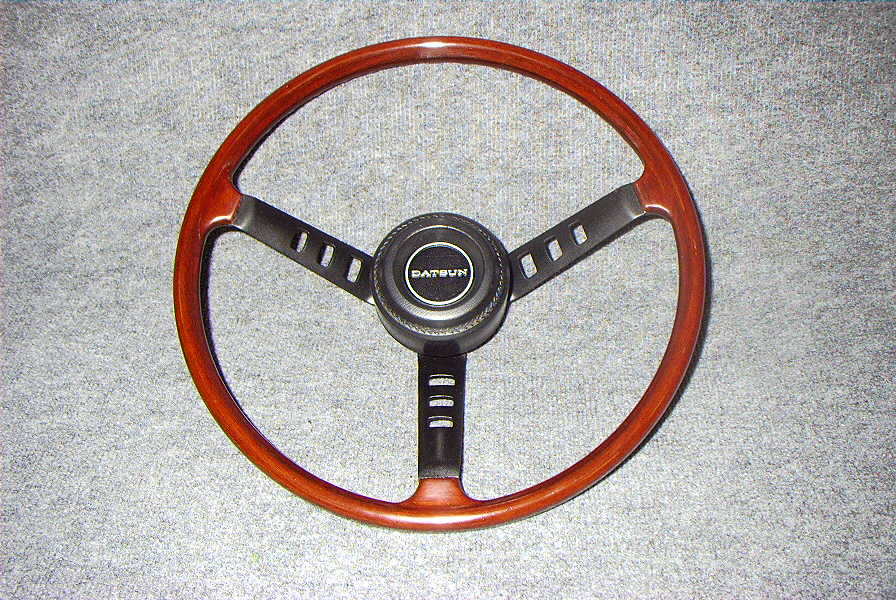

I recently sold on ebay an extra steering wheel that I restored myself. The winner emailed me back very satisfied and complemented me on my work. I wish I could quit my job and do this sort of thing for a living from the comfort of my home.:love:
Here is a reprint of the restoration steps I had posted on ebay:
I stripped down the black spokes by machine sander, and not chemical stripper as not to harm the rim’s finish. Then, the center was masked and hub/spokes were painted flat black with a semi-gloss clear coat added.
The faux wood was stripped, prepped, and finished using the following process:
1. Wood was thoroughly cleaned with a citrus degreaser and a mild Teflon-safe scouring pad to remove all accumulation of old varnish, grease and dirt.
2. I applied a single, light coat of red mahogany stain to revive the color.
3. Multiple coats of clear urethane were then sprayed to seal and protect.
4. The wheel was wet sanded with 600 grit sandpaper to smoothen the surface.
5. Polishing compound was then applied and surfaced was buffed by hand for many hours to achieve a glossy finish.
