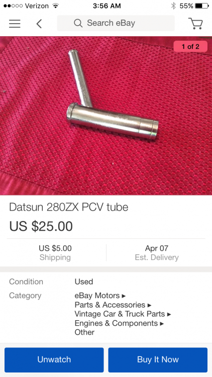

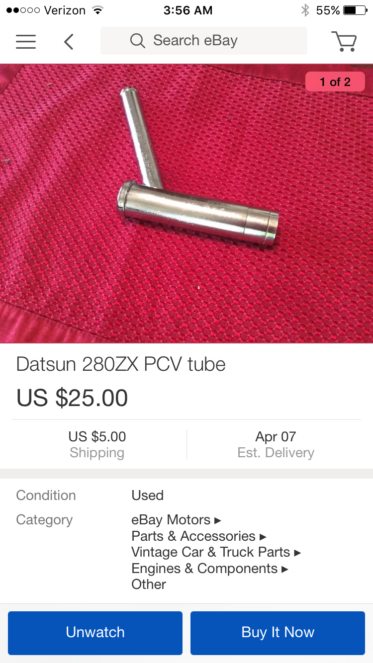

March 31, 20169 yr Author comment_491182 So I found one on eBay. Now is this thing welded in or just fit in?? And is there a seal? I'm running a F54 block from a 280zx so it should fit right in.. Edited March 31, 20169 yr by zmanoside Link to comment https://www.classiczcars.com/forums/topic/54850-pcv-tube-emissions-stuff/#findComment-491182 Share on other sites More sharing options...
March 31, 20169 yr comment_491186 Tap it in with a rubber hammer. Link to comment https://www.classiczcars.com/forums/topic/54850-pcv-tube-emissions-stuff/#findComment-491186 Share on other sites More sharing options...
