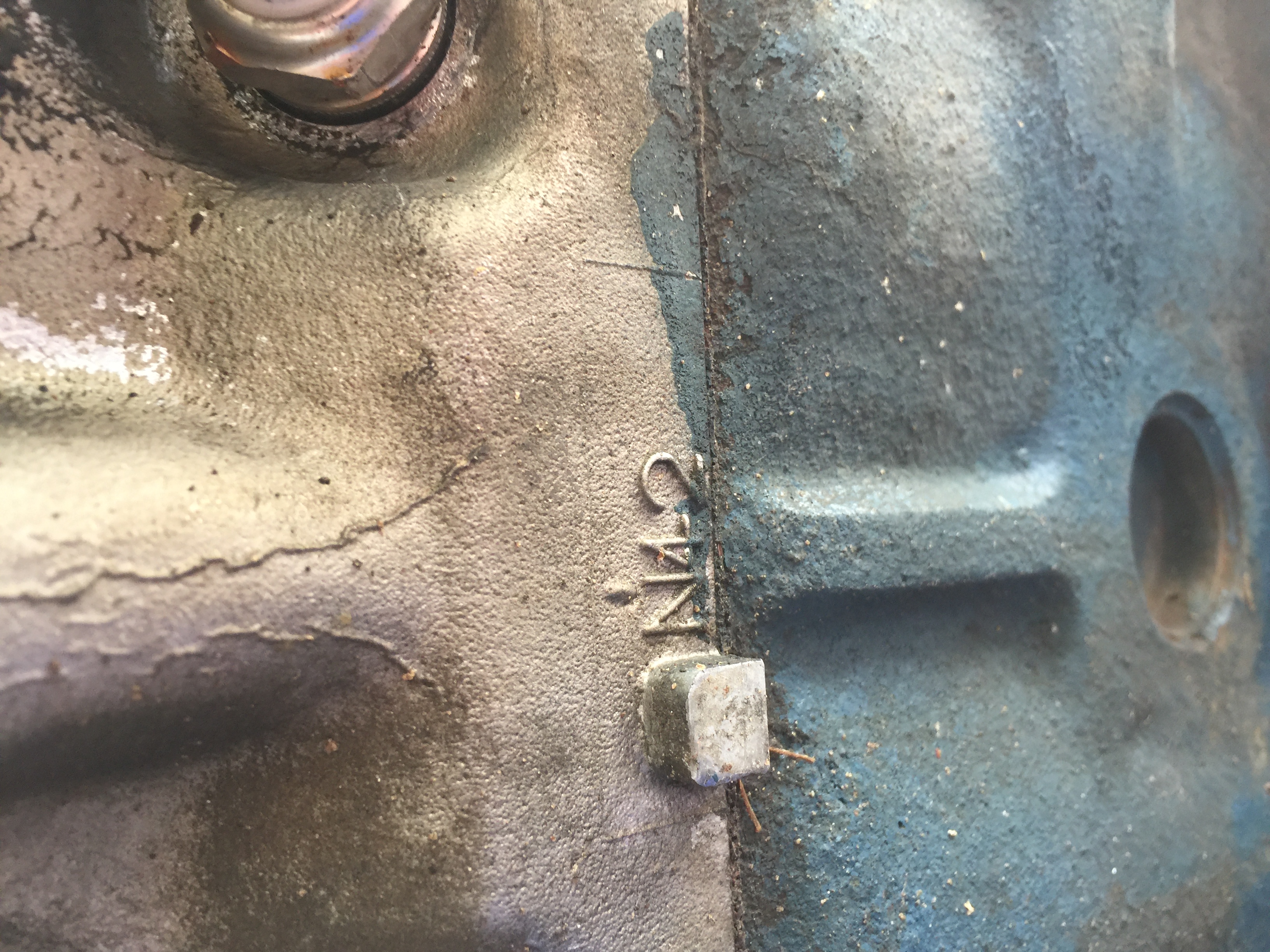

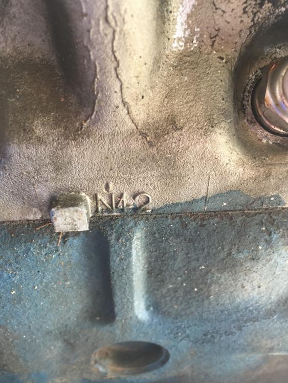

April 3, 20168 yr Author comment_491498 Ok a little news...I got the engine delivered that is going to end up going in 1121. Not to worry I will be rebuilding the original engine and storing it for posterity. I plan on building a L28 Bore / L24 Stroke engine that is listed on page 4 of Frank Honsowetz' book "How to Modify Your Nissan & Datsun OHC Engine". I also found some great information regarding what I am trying to do in a 2010 post: On September 16, 2010 at 7:05 PM, Tak510 said: It's kinda old thread, but I just want to share with you that my z has the L28 short-stroke setup: N42 block + 280ZX flat pistons + L24 crank + L24 rods + N42 head. The compression is 9.5:1 with 1mm thick Felpro head gasket. This can be built with all stock parts and it's very easy. I have been running this setup with a lighten flywheel and triple carbs and I love it!! With .6mm thick metal head gasket MSA carries, a 10.0:1 compression can be had without shaving any metal, but it's a little pricey item.. N42 Block. Oil can is installed differently on this one than my L24. Have to look up this number to see what year it was produced. N42 Head. A second N42 Head Link to comment https://www.classiczcars.com/forums/topic/54931-hls30-01121-gets-a-new-life/?&page=2#findComment-491498 Share on other sites More sharing options...

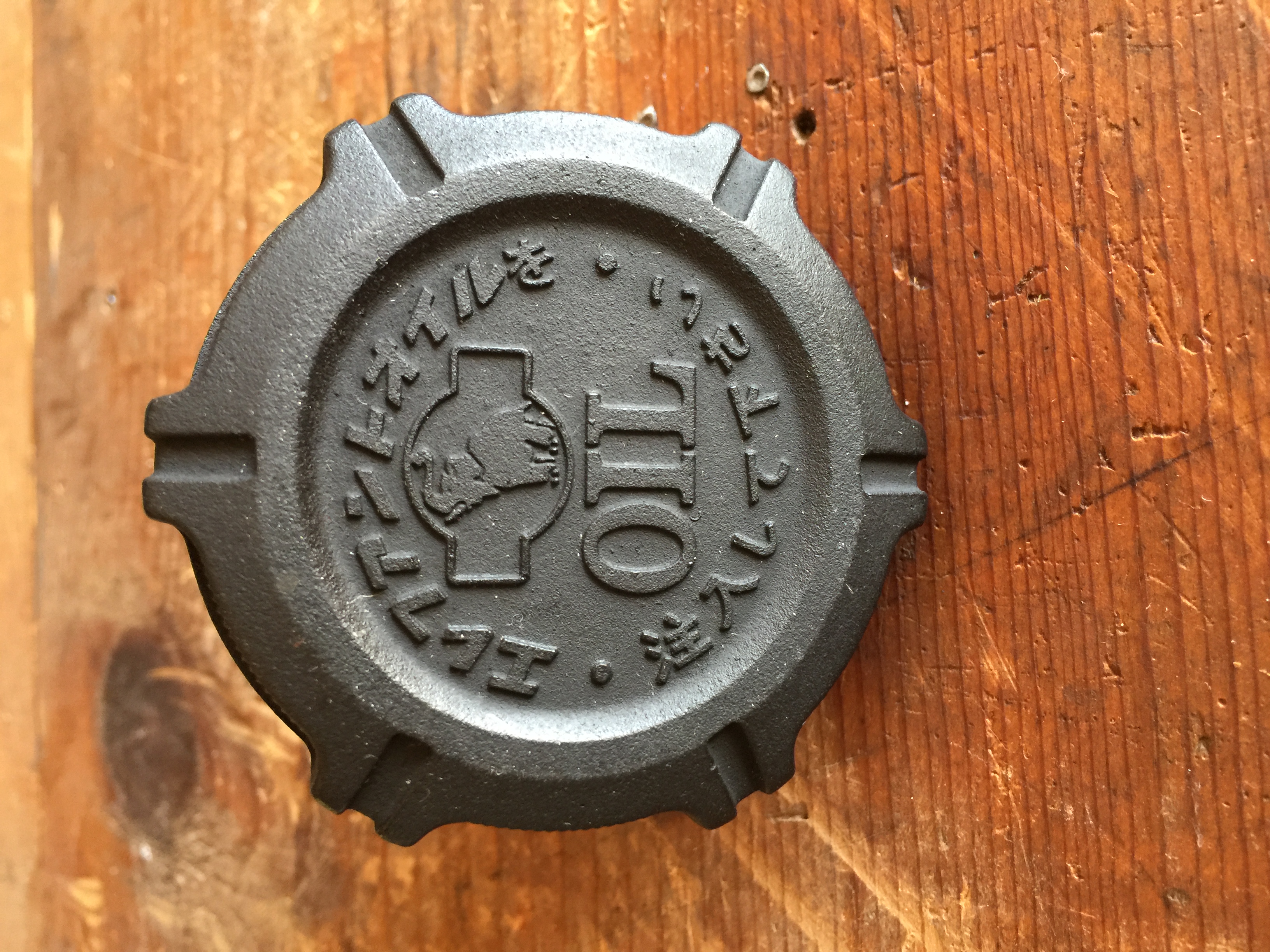

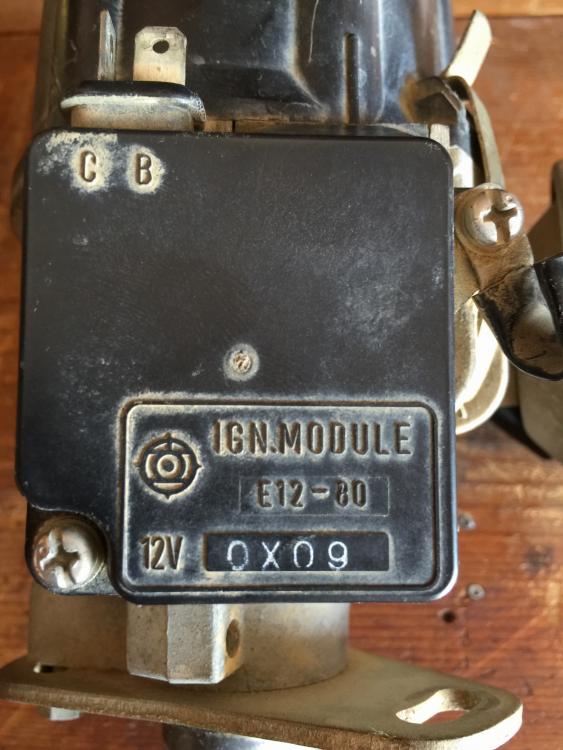

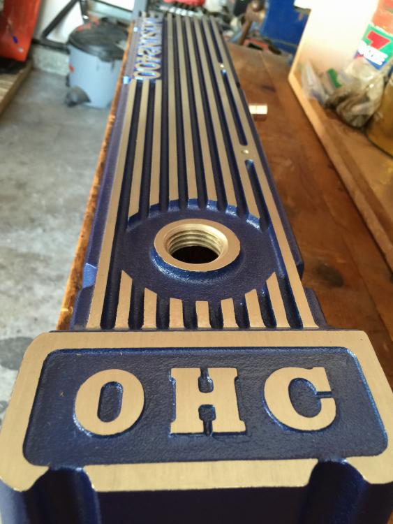

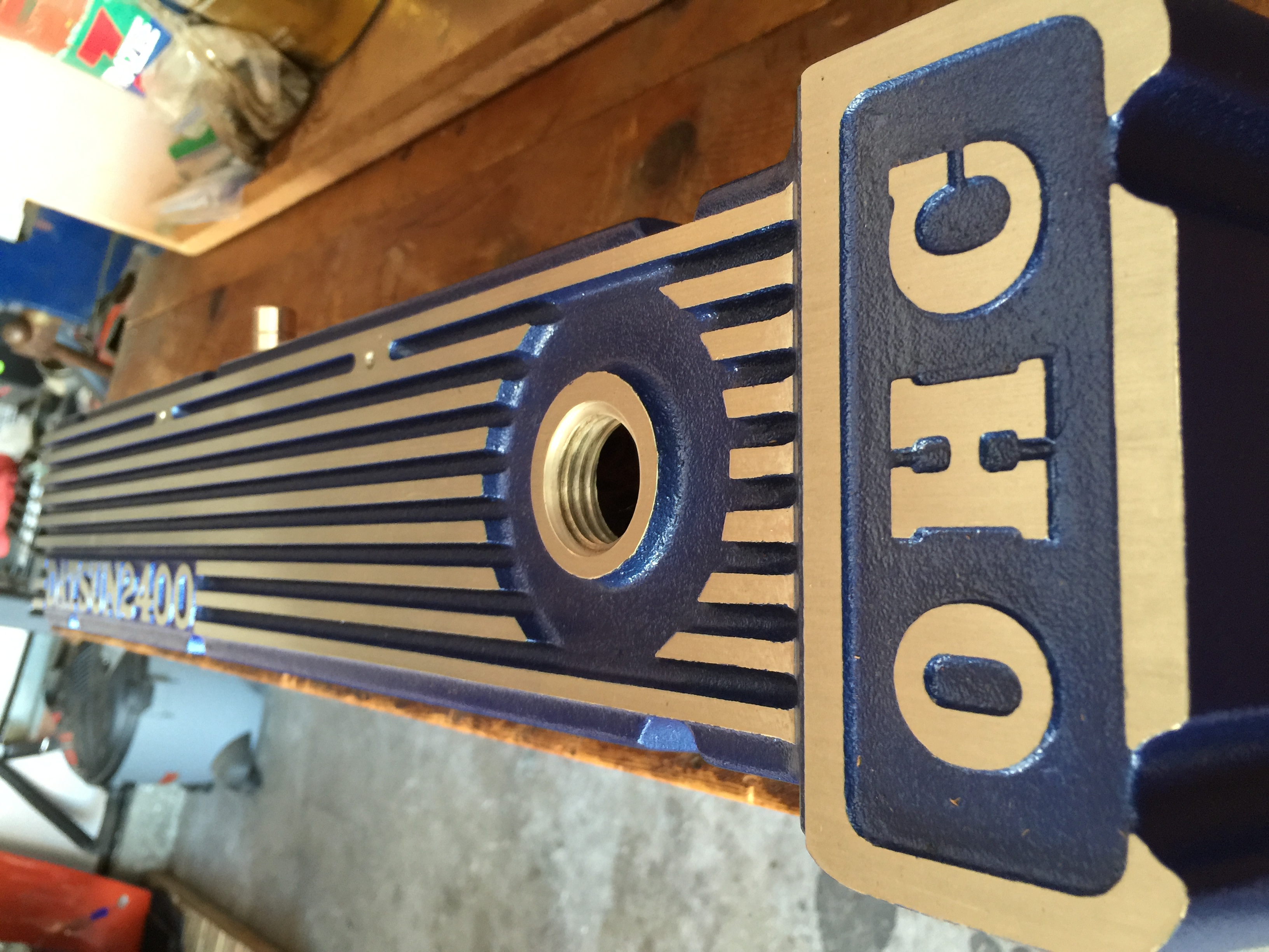

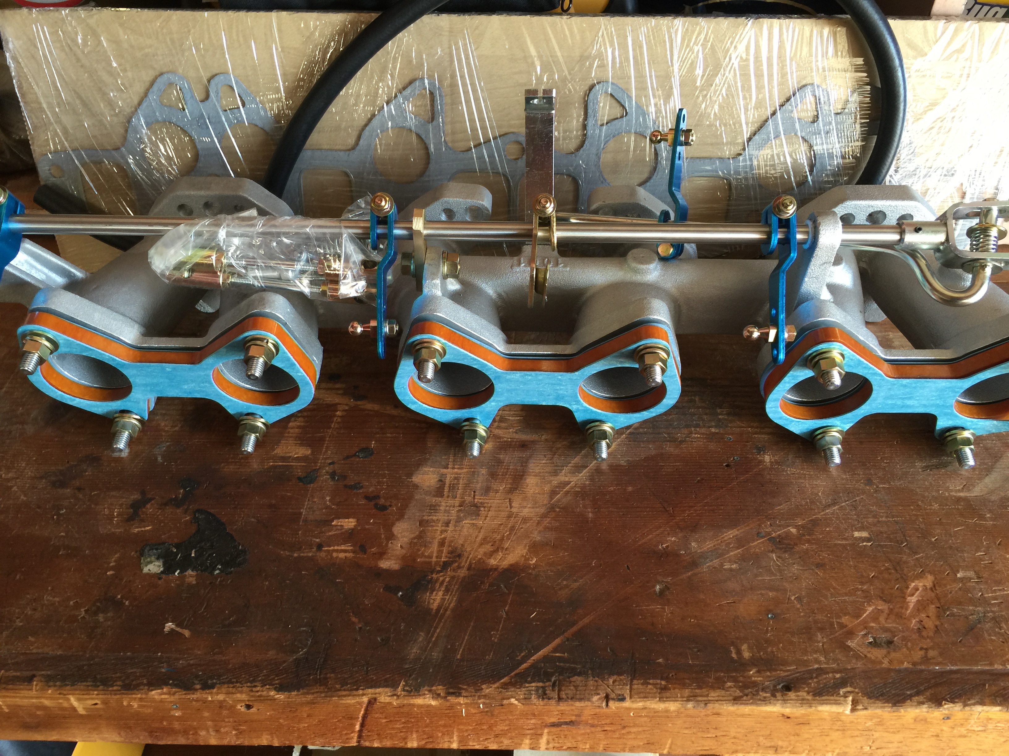

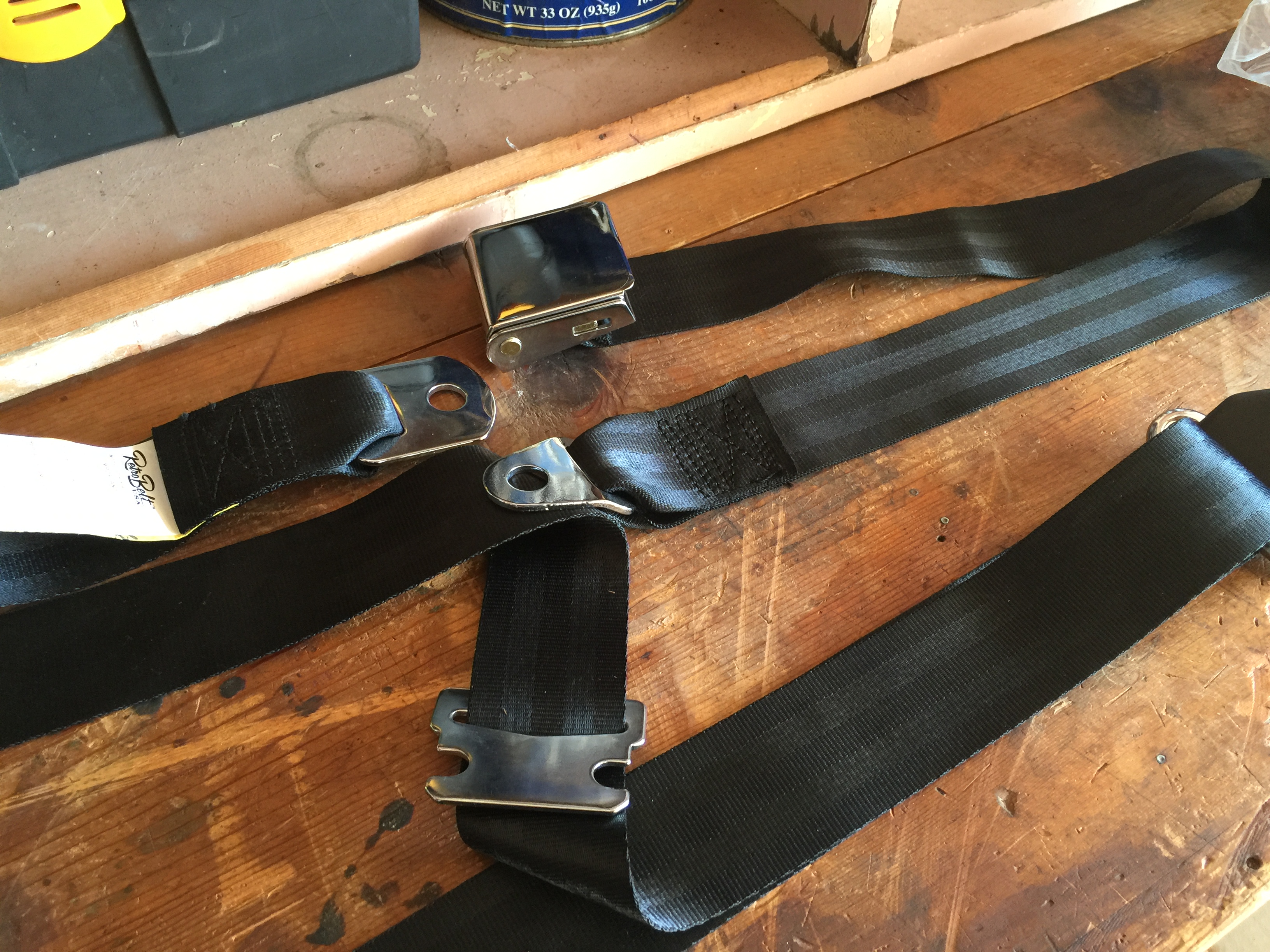

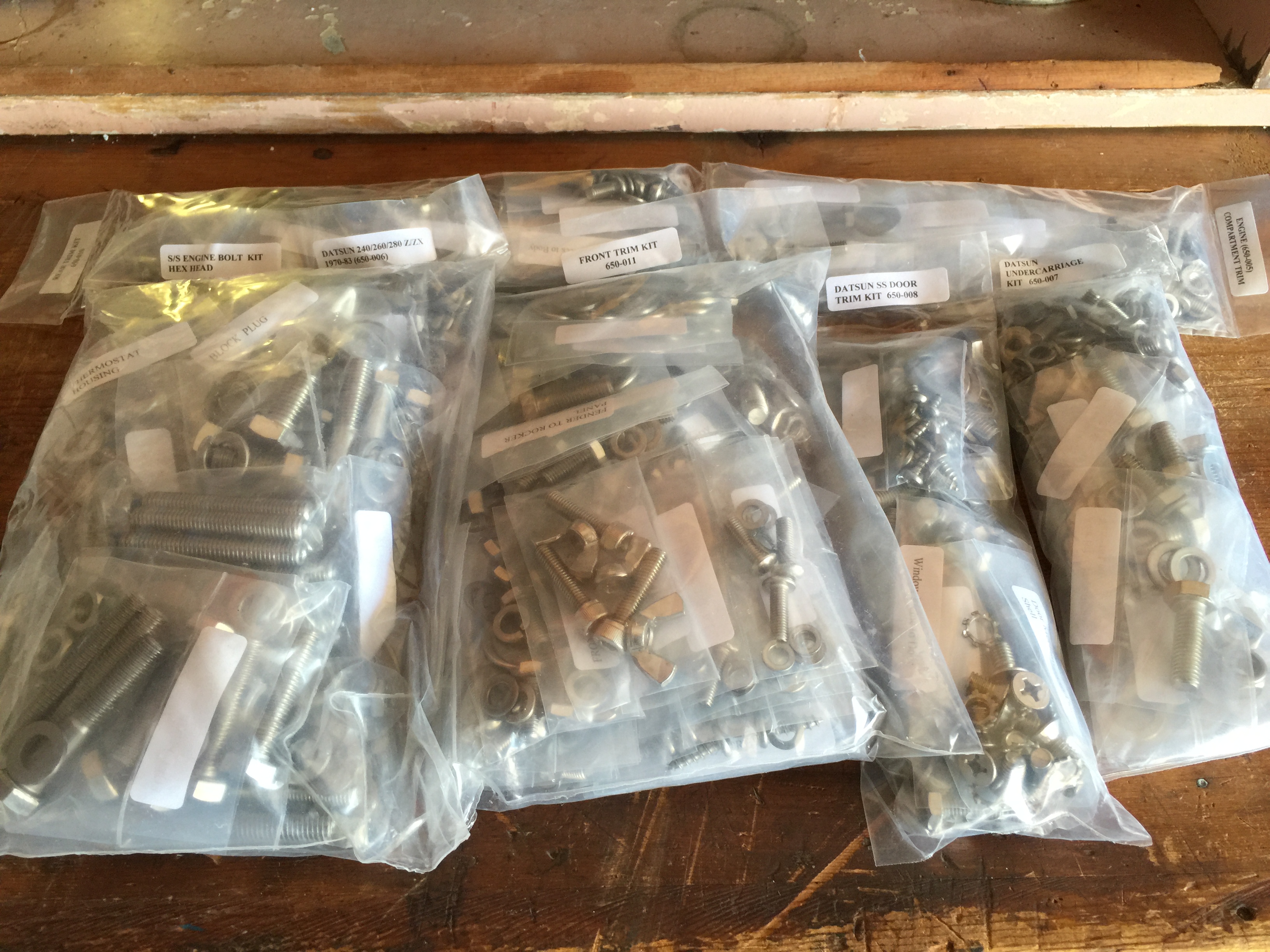

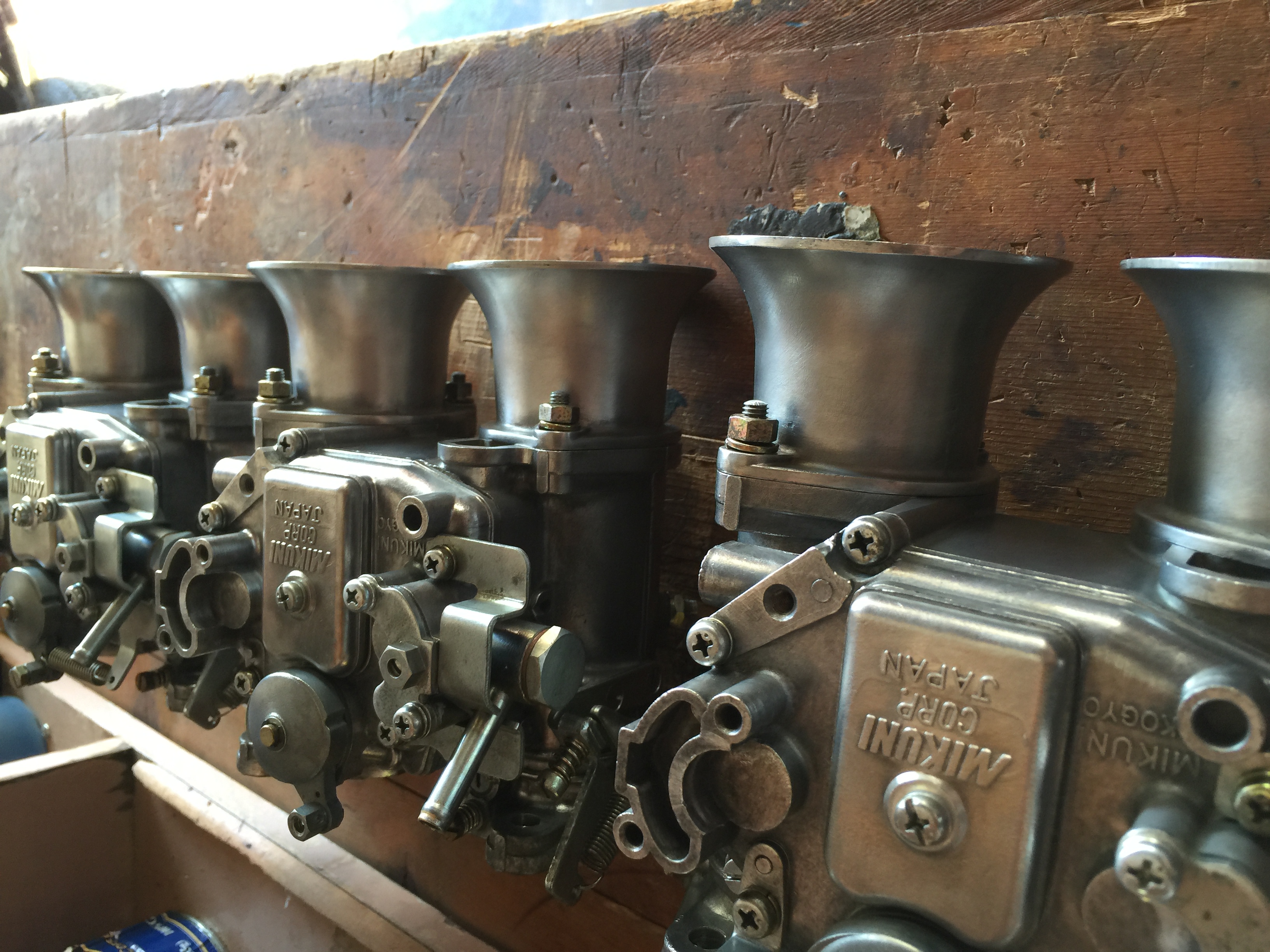

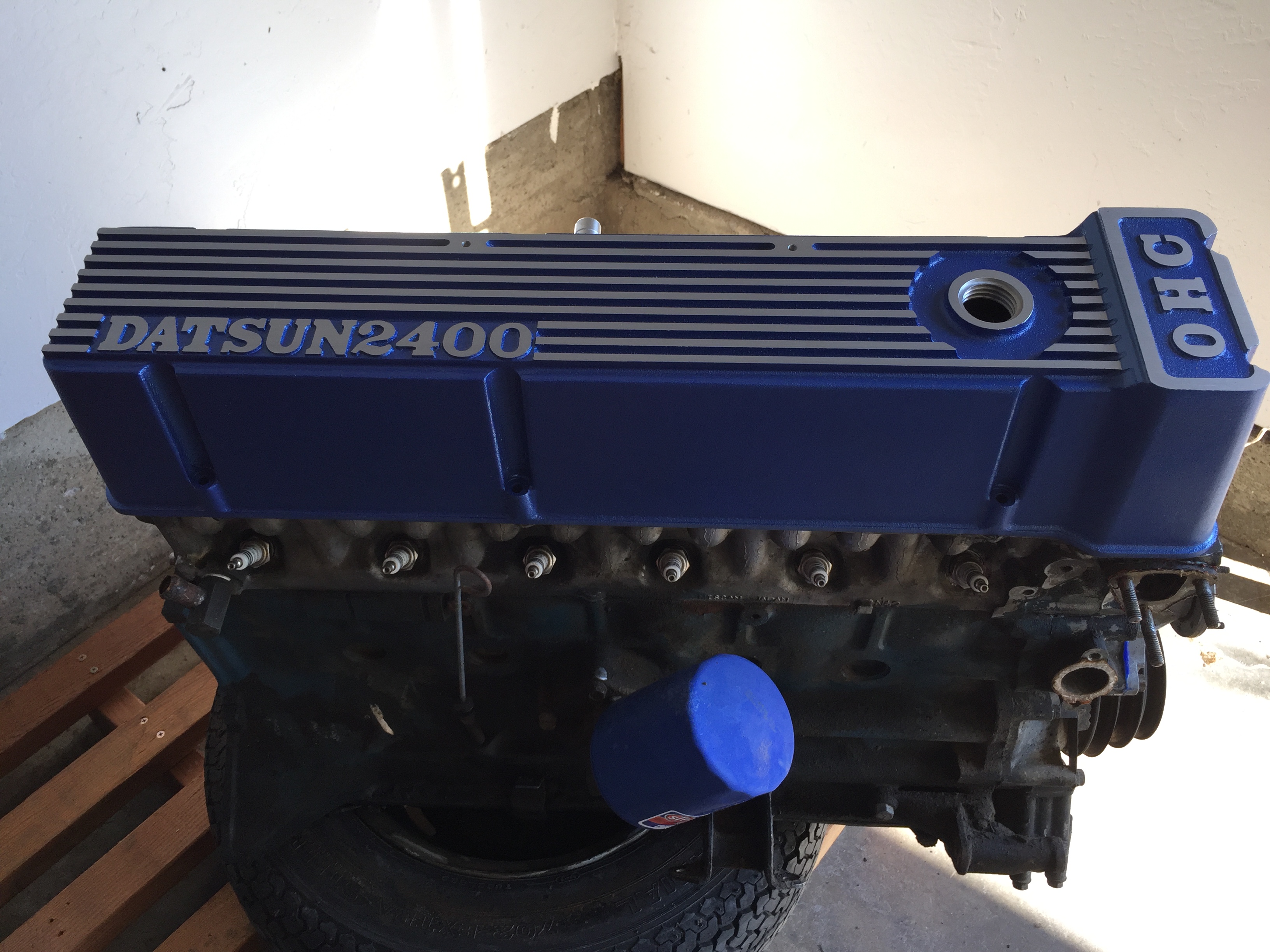

April 3, 20168 yr Author comment_491500 Here are a few of the parts that I have received recently: New seatbelt were a must for my wife to feel safe. Got the new oil cap in that I ordered. I really like the elephant oil cap. A friend of mine gave me this distributor. Hope it is good. E12-80? Research required. Stainless steel screw/nut/bolt/washer set for the entire car. Kameari intake maniford. Triple Mikuni 44 PHH Kameari valve cover. Kameari valve cover fit test on L28 engine. I will keep everyone up to date as we continue this journey together. Link to comment https://www.classiczcars.com/forums/topic/54931-hls30-01121-gets-a-new-life/?&page=2#findComment-491500 Share on other sites More sharing options...
