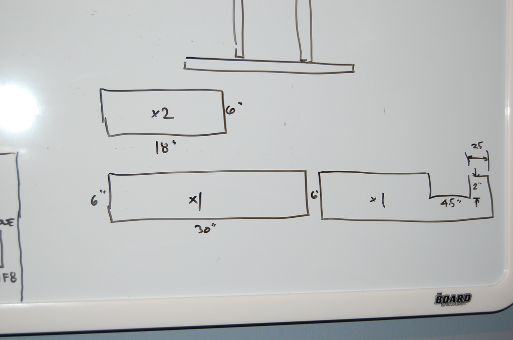

They're some drawings for a wooden crate floating around here that Zedyone Kenobi put up.  I made one and use it all the time.  The oil pan and the oil pump stay on too.  the head can be stored in a bag but you must put something under it to keep from resting on the vales, there will always be two sticking down past the bottom.  I've used doubled up cardboard on one and styrofoam on another, both work good.  Put the rest in boxes.
here's that wood crate.  you'll need some casters for it so you can roll it around.  And those bumper's boxes look just like the ones from Futofab that I bought, the rear is 3 piece though.
