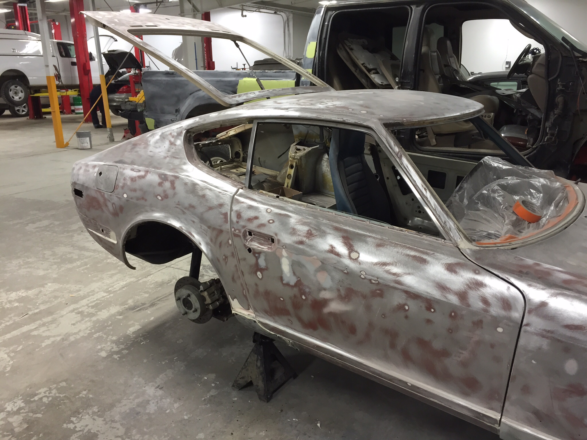

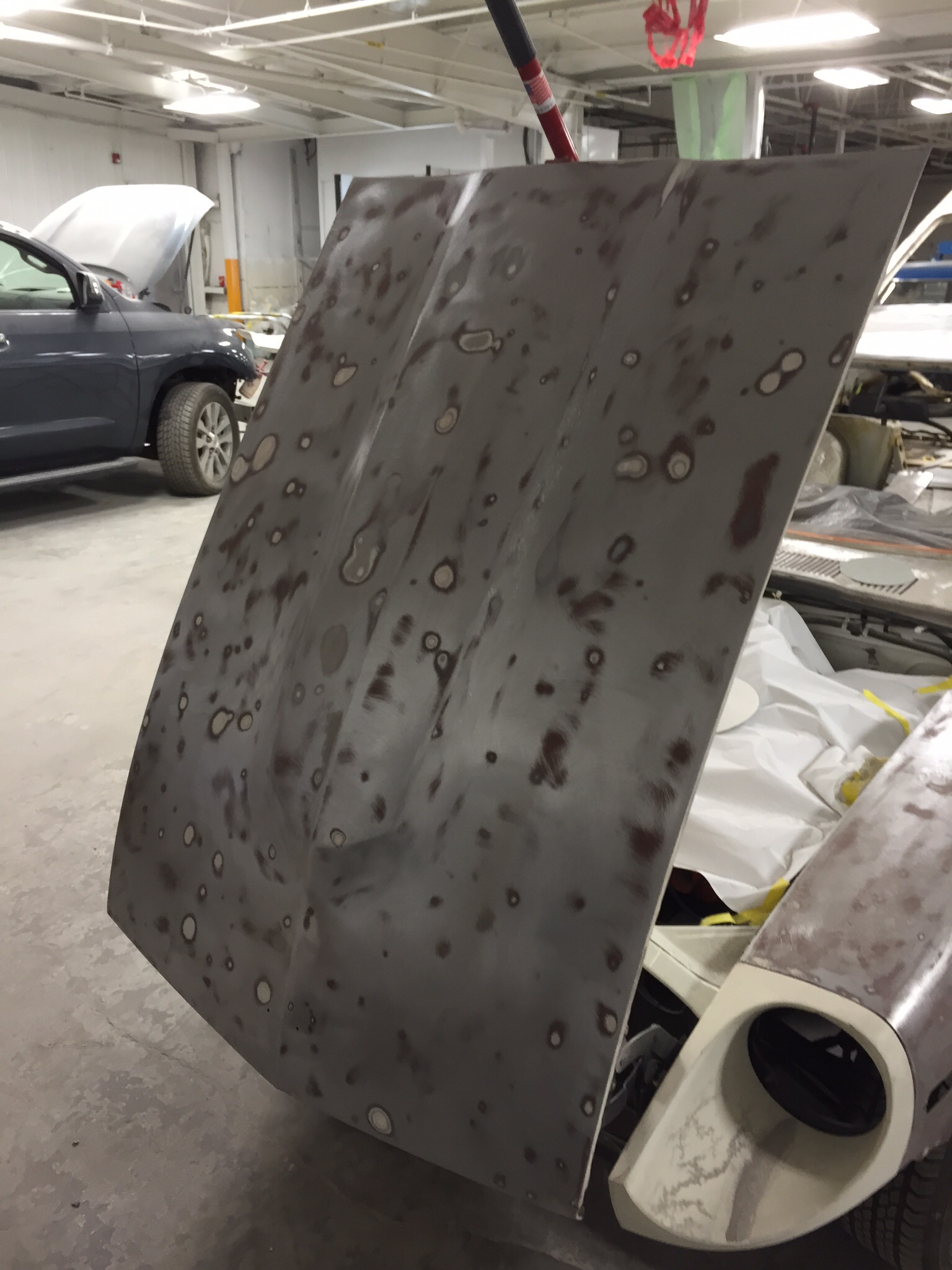

So the 71 I'm worling on finally made it to the body shop. Now I can work on other projects.  It had been previously painted with who knows what kind of industrial flat white. The shop is stripping it. I know it had "some" hail damage, but look what showed up after stripping. Holy chicken pocks batman!
Maybe I just go with the cheetah theme....
Kudo's so far to the new body shop I'm trying this time around. Wally and the gang at AutoComplete Calgary.  If this job goes as promised I agreed to spread to word to others in the area. Here is their first installment. They are also doing a bit of rust repair for me, the two dog legs and the hatch/latch panel. I brought them patch panels. They are using adhesives instead of welding on the dog leg work. MUCH better for long term rust-through protection. I plan on flooding the rock and dog leg internal areas with Rust Check or equivalent after paint as well.
Staying 904 white with blue interior. Unless someone wants it after its done, then let me know your color choice soon ;)

That was some serious hail. Surprised it wasn't visible from inside the hood too
Me too. I spent a fair bit of time cleaning/wiping and scotchBriting the inside of the hood by hand and never noticed any  lumpy bumpy's.. I'll try that again now.
