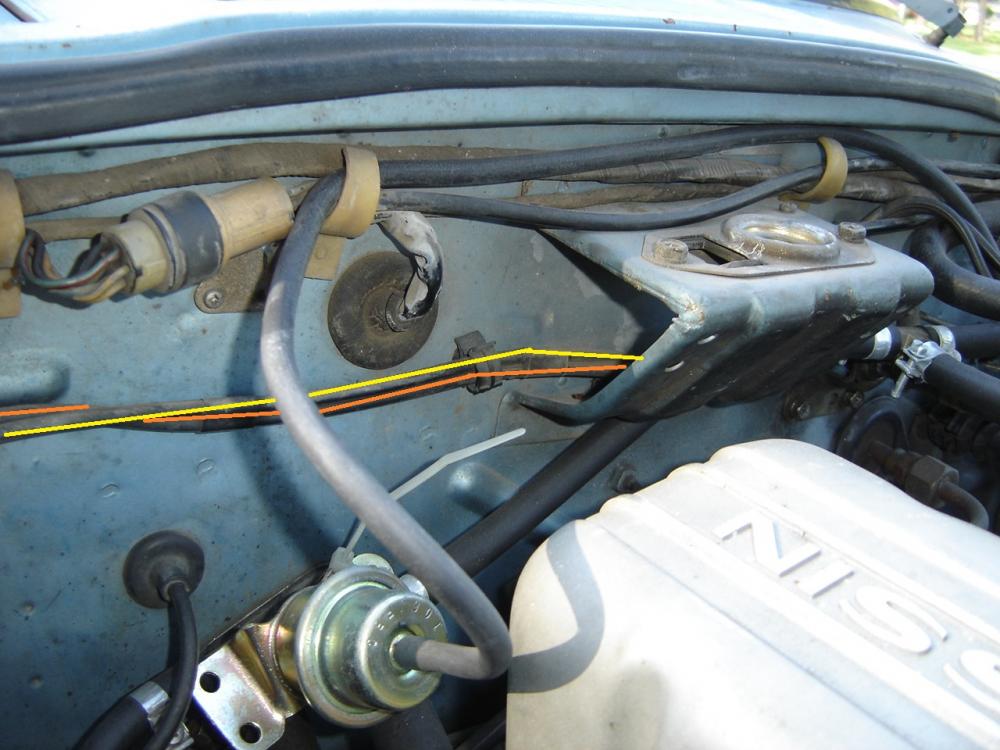

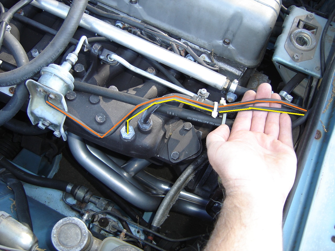

I'll get some better pictures and mark the paths like you've done.  We're talking about the same hoses, mine maybe a little different though.  I have a early '77 5spd.  I'll do it this afternoon.

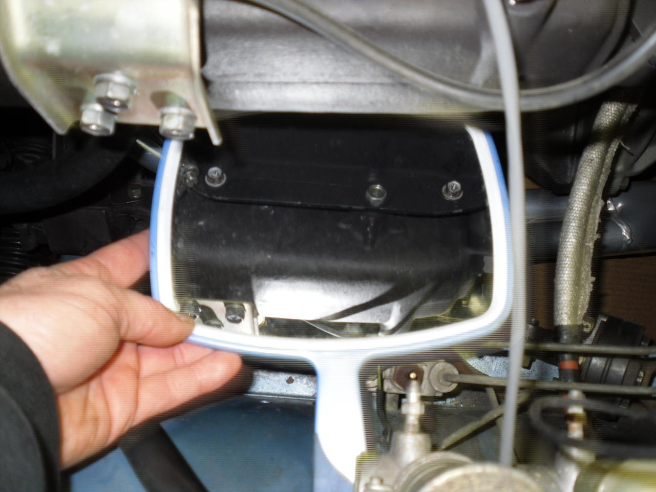

Those shields bolt to the bottom of the intake manifold.  I had to use a hand held mirror to put mine back on.  Here's a picture.
Thanks, I looked and I do see where that one will go;

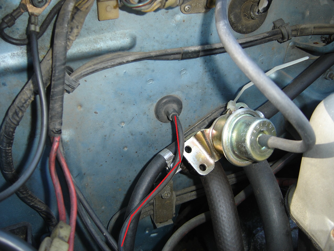

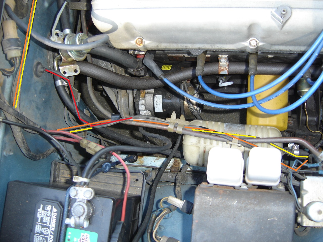

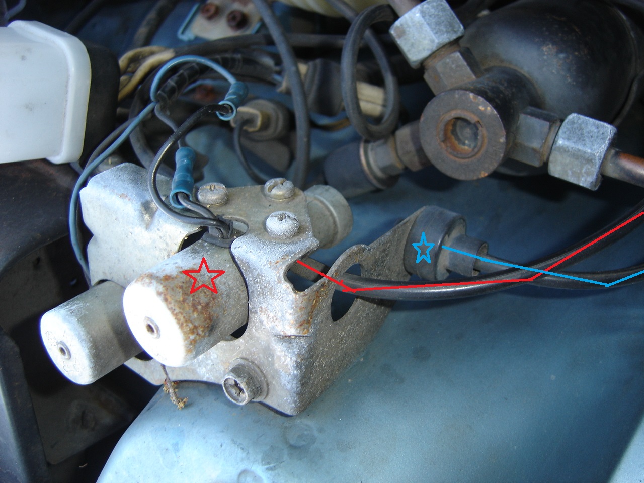

Good deal. I've taken the pics of those vacuum lines and will mark them with "paint" program on my laptop tomorrow morning. Back with you then. 8^)
I've had some fun playing on MS Paint!  It's a heck of alot easier with my wireless mouse than the touch pad on my laptop. :rolleyes:
Red goes from solenoid to firewall grommet.  I suppose to the HVAC?  The blue is open to the atmosphere, no idea about that.
Yellow goes from vacuum source on the intake manifold to the TOP hole on my bottle.
Orange goes from bottom hole on my bottle to Fast Idle Actuator on the intake.  When you turn on the air it pulls in from vacuum and grabs the throttle rod to pull along with it, raising the RPMs at idle.
Now whether or not mine is right is up for discussion. LOL
