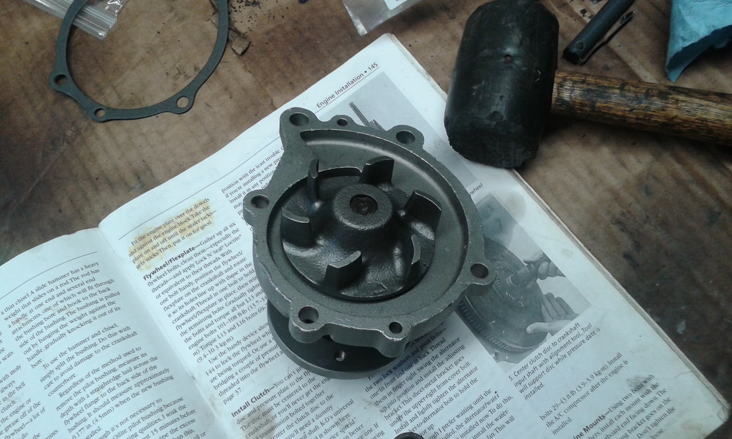

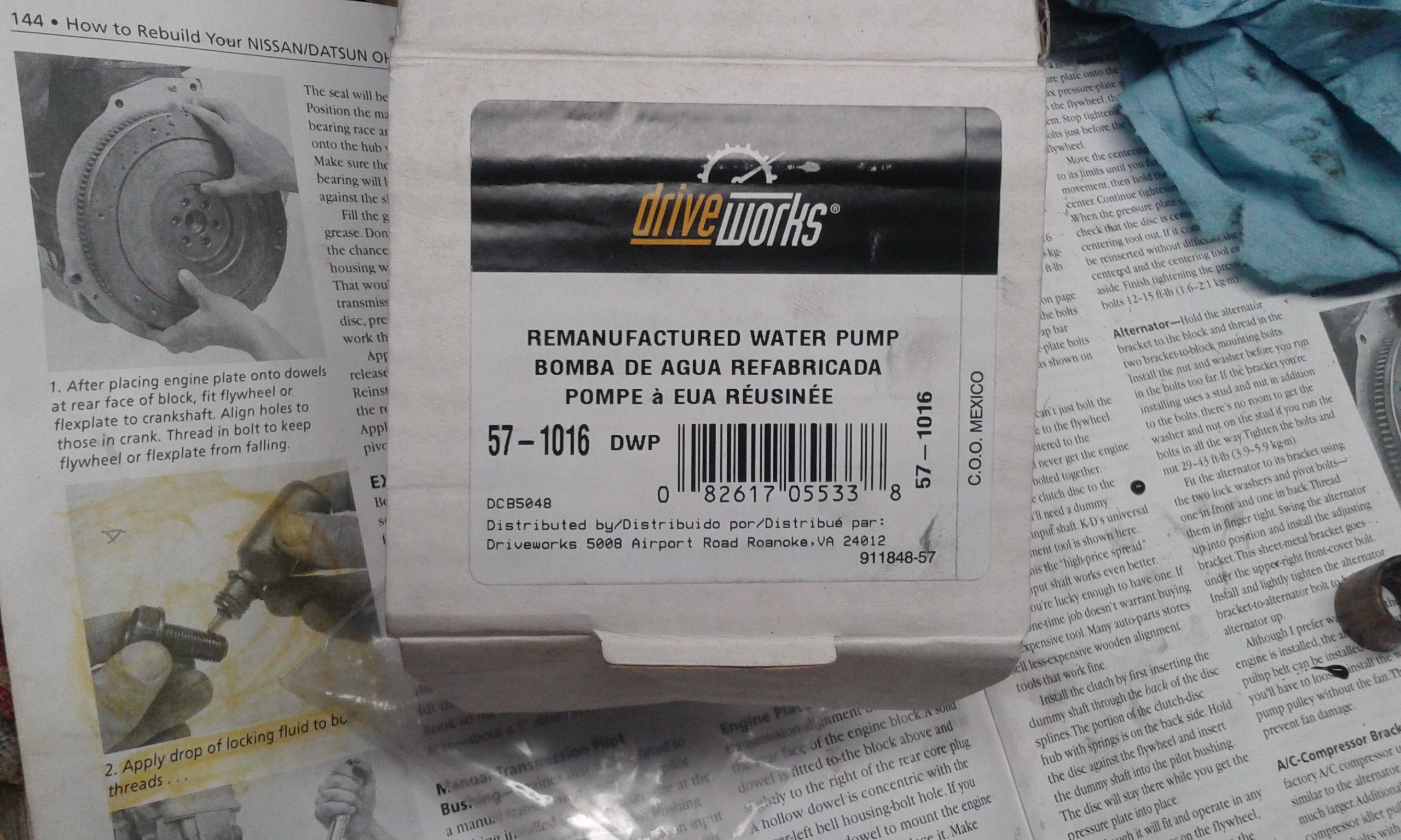

April 7, 20168 yr comment_491927 Google drive works #57-1016 I just now put that one on, from the picture posted earlier. Came from advance auto or O'Reillys. It's a reman Aisin. Link to comment https://www.classiczcars.com/forums/topic/55214-water-pump-options-and-where-to-get/#findComment-491927 Share on other sites More sharing options...
