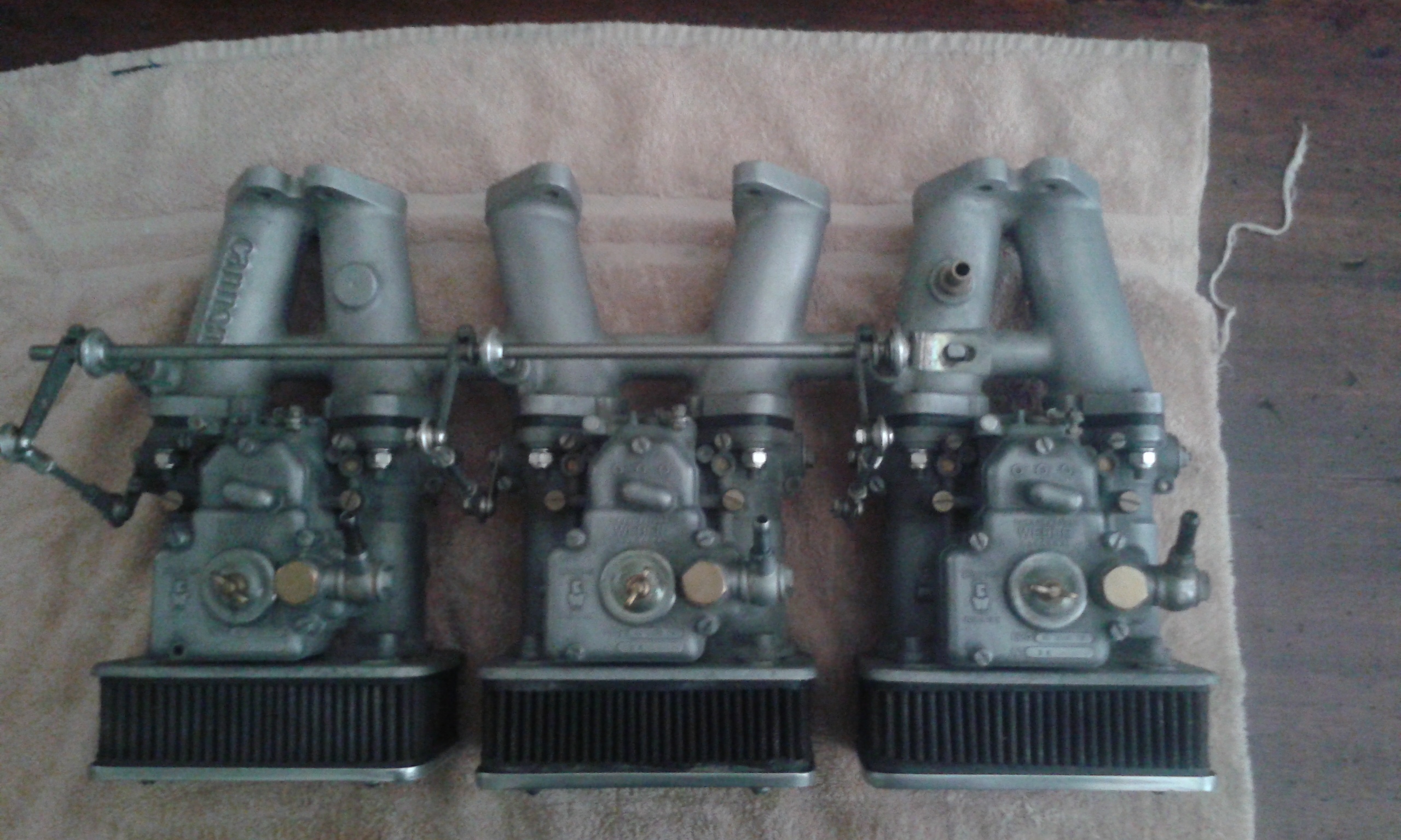

Where is the PCV valve on your intake? I don't find one on this Cannon.
And that's something I've not even thought about before. I'm gonna put these on someday and will have to deal with your same problem.
You should PM "blodi" and ask what he did. He's the one with the plugged block like your's I showed you earlier.
Just had a similar conversation on a different forum, about a 4 barrel carb.  The carb manufacturers suggest the power brake port as dual purpose with a T.  So it would be the port on the right.  But this would run all of the blow-by through two cylinders.  I think that people run vacuum logs for situations like this.
