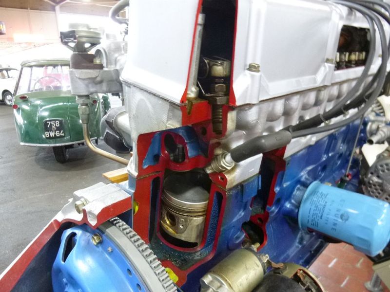

May 4, 20168 yr comment_494244 More questions... What's the brand of the pistons? Is it possible that the skirts were too long and actually touched the crankshaft? Still not seeing how bits of ring got past the oil scraper and the piston structure. Yes, there's an indentation but it closes up at the bottom. No obvious path for the top ring fragments. Kind of looks like somebody opened it up, maybe when they changed the head, and really hacked a bunch of stuff up. Maybe cracked the piston skirts when they were in there. Or had the pistons and rods out and cracked the skirts then, playing with them like rattles. Link to comment https://www.classiczcars.com/forums/topic/55222-blowby-too-much-smoke/?&page=9#findComment-494244 Share on other sites More sharing options...
