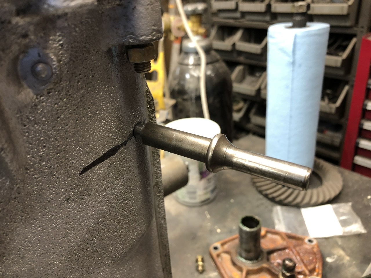

On the 81-83 trans, you have access through the reverse lockout thingy hole to bash it out with a punch or air hammer but on the 77-80 transmissions, there is no such reverse lockout do-hicky. We/I have given advice previously to drill a hole “in the right spot” then to plug when done. Until now, no one has documented exactly where to drill and how to plug. Well here goes.
I drilled a 5/16 hole, then enlarged it to about 3/8 and angled it to aim at the pin more directly.
When done I drilled it to 27/64 (just under 7/16) and tapped it with a 1/4NPT tap and plugged it.
The hole is 3.125 from the case face, and down 1.375 from the casting edge above.
I’d likely use a plug with a recessed hex head rather than the square headed thing I show, it’s just what I had on hand. Locktight it in.
You can move the rod in and out several inches so the front to back position is not very critical.

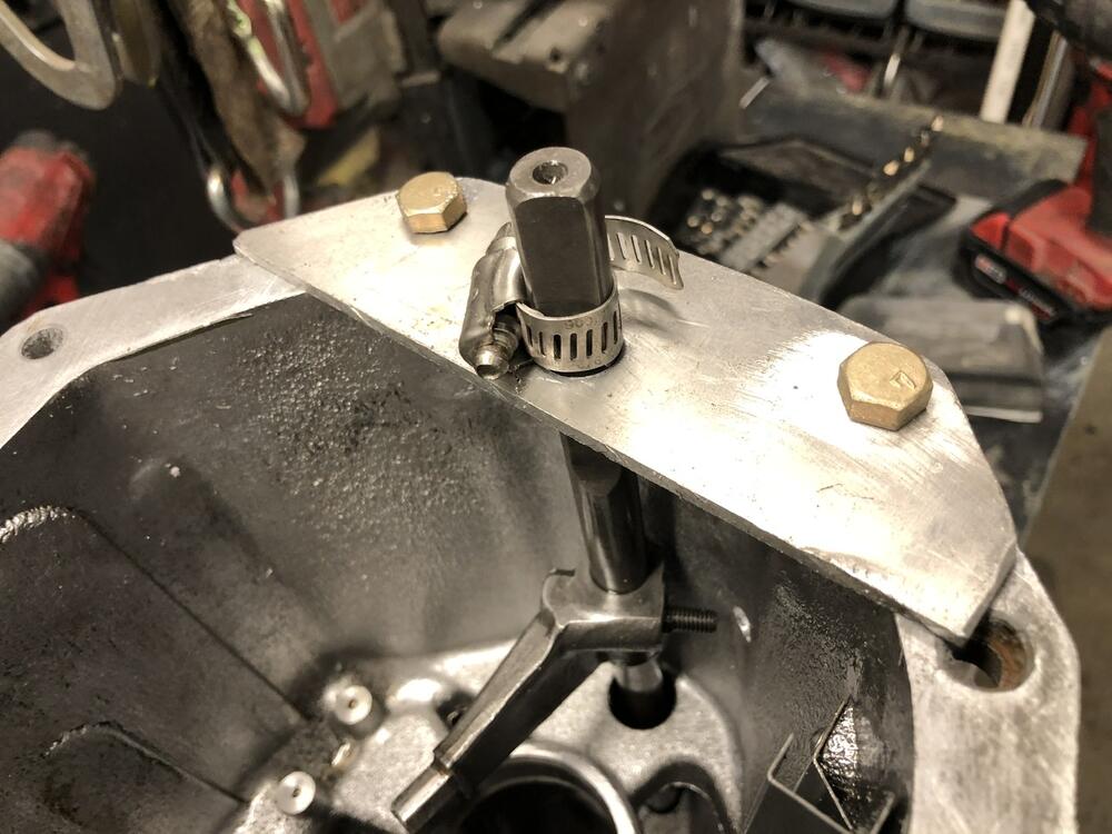

I made a simple plate jig to hold the end of the rod in place to support it while bashing the pin out. 17/32 bit for the rod I think. Hose clamp to hold the rod fully forward. This puts the pin head exactly 3-1/8 back from the case face.

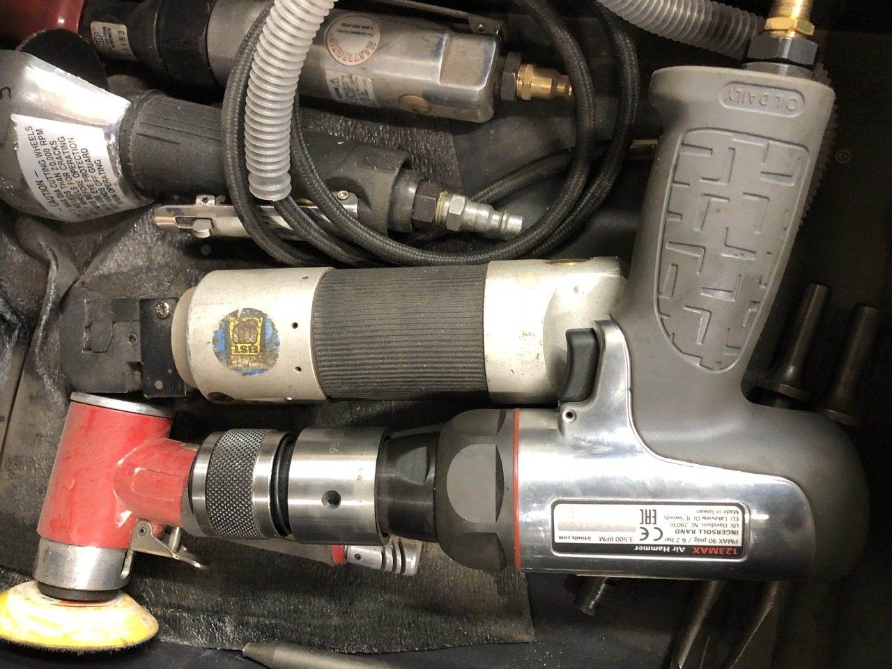

I have used an air chisel tool with a round bit in the past to get this pin out, it works extremely well and is nearly instantaneous. Beating it with a punch requires more effort and unpleasant words.
