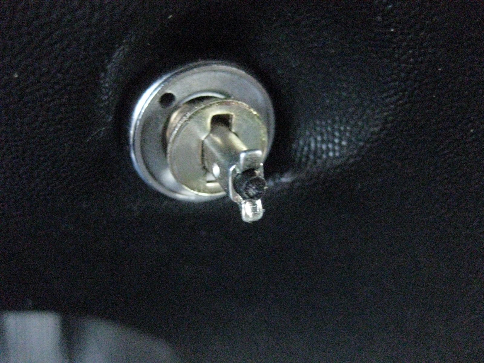

I have a 73 and it seems to me that your shaft doesn't protrude far enough  to allow the knob to engage.  :huh:
Can't believe I just wrote that!!  :blush:
Here's some  photos to compare.
Edited by Zup
added photos
Thanks for the pictures Zup, and I see what the problem is.  There is a washer of sorts on the shaft that the spring on the knob pushes against, and mine is missing.  I need to find mine, get one from someone else, or fabricate something.  Thanks for the help!
Doubt if this will be helpful, since I don't know exactly what I did, but last year I removed the hazard switch on my '73 to clean the contacts. Somehow, when I reinstalled it in the dash, it ended up with the threaded part of the shaft sticking out through the dash about 1/2 inch too far. I put the retainer and knob back on and left it like that, because it worked and I didn't feel like crawling back under there. And still don't.
