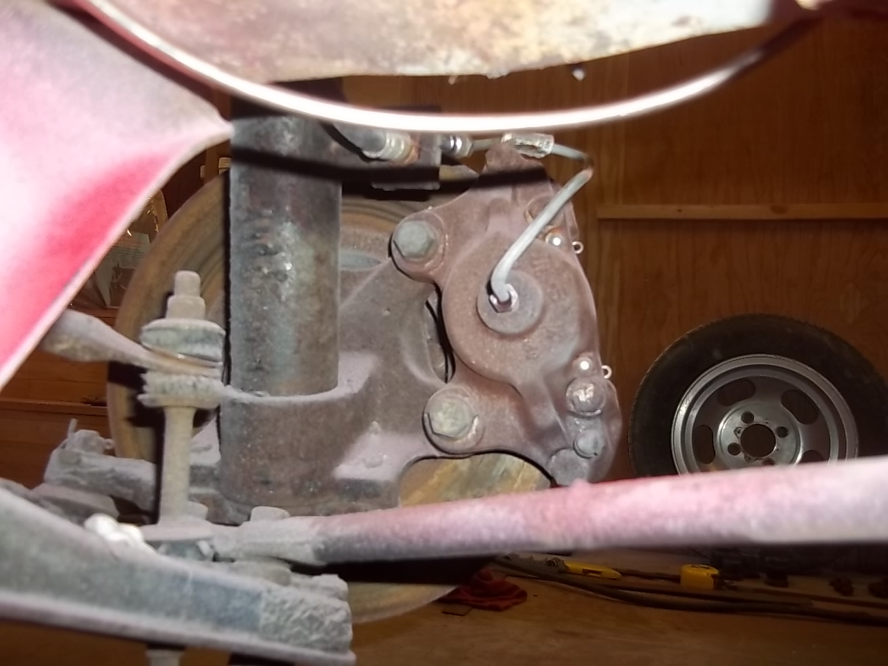

Posted April 14, 20169 yr comment_492591 i started tearing into my suspension and found this. i am aiming this question toward the guys that are not familiar with brakes. i know some will spot the problem right off, so let the in-experienced have a guess, ok? Link to comment https://www.classiczcars.com/forums/topic/55273-what-is-wrong-here/ Share on other sites More sharing options...
April 14, 20169 yr comment_492598 No scratches on the mounting bolts so I guess this really is the way you found it! Lucky to have working brakes - or, do they work? Link to comment https://www.classiczcars.com/forums/topic/55273-what-is-wrong-here/#findComment-492598 Share on other sites More sharing options...

April 14, 20169 yr Author comment_492627 10 hours ago, jfa.series1 said: No scratches on the mounting bolts so I guess this really is the way you found it! Lucky to have working brakes - or, do they work? i never had a chance to drive the car. the p.o. replaced all the brakes. Link to comment https://www.classiczcars.com/forums/topic/55273-what-is-wrong-here/#findComment-492627 Share on other sites More sharing options...

April 14, 20169 yr comment_492643 Looks like the previous owner did the same thing I did, put the calipers on the wrong sides. Bleeder port needs to be on top not bottom. Will not bleed right with bleeder port on bottom. You will need to swap the calipers. Link to comment https://www.classiczcars.com/forums/topic/55273-what-is-wrong-here/#findComment-492643 Share on other sites More sharing options...
