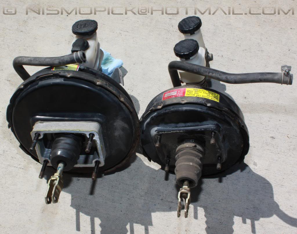

Looks more like the one on the left. Just not in that black color. Its all gray. Its slightly bigger. Like a couple inches bigger. Seems like a 10'' booster. I also dont have that spacer. And the studs that go into the firewall on the new one i got are still short, not long like the one on the left. Pretty much the firewall studs are the same length as my old one. The one in the picture on the left seem way longer.
Will mine still work if I can get the old nut to thread through the stud? I believe the production date is 5/78. Black dragon says even having an attempt to put on the car voids a refund or exchange so Im trying to get as much info before I take a shot at it.
